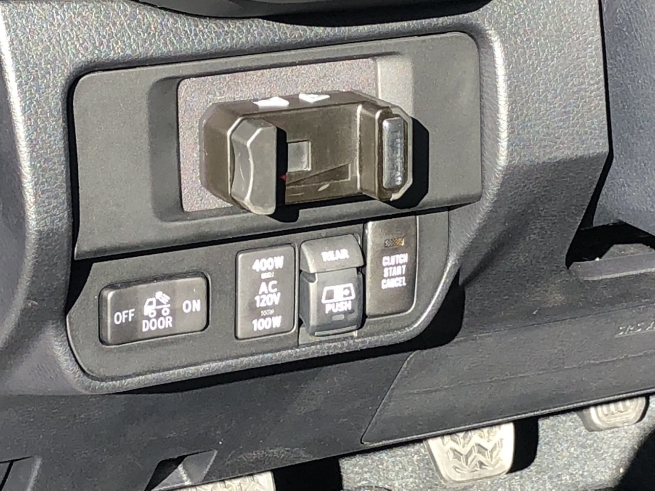

    This is the cleanest thing I could find so I went with it. Works great and looks good too. It has a hidden brain and a small knob that comes with a knock out that fits Toyota.

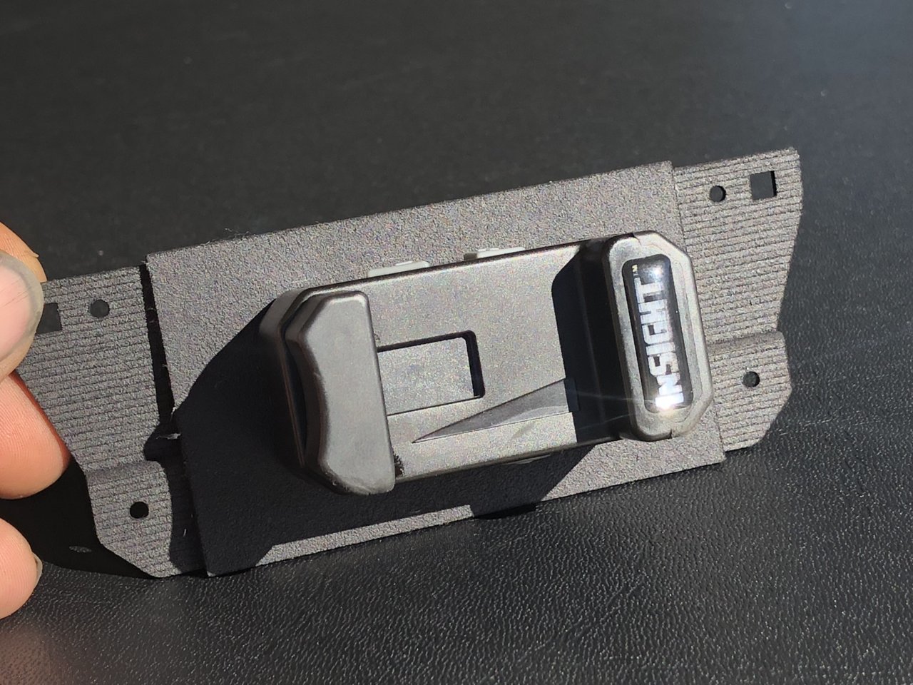

    I used the Hopkins insight flex mount, it comes in serval parts and connect together. I got a blank panel that replaced the cubby hole the left of the steering wheel and mounting the display near the shifter. You just need the proper adaptor to plug into the truck, the Toyota connector is hidden pretty well behind the left kick panel.
    https://www.etrailer.com/Brake-Controller/Hopkins/HM47297.html

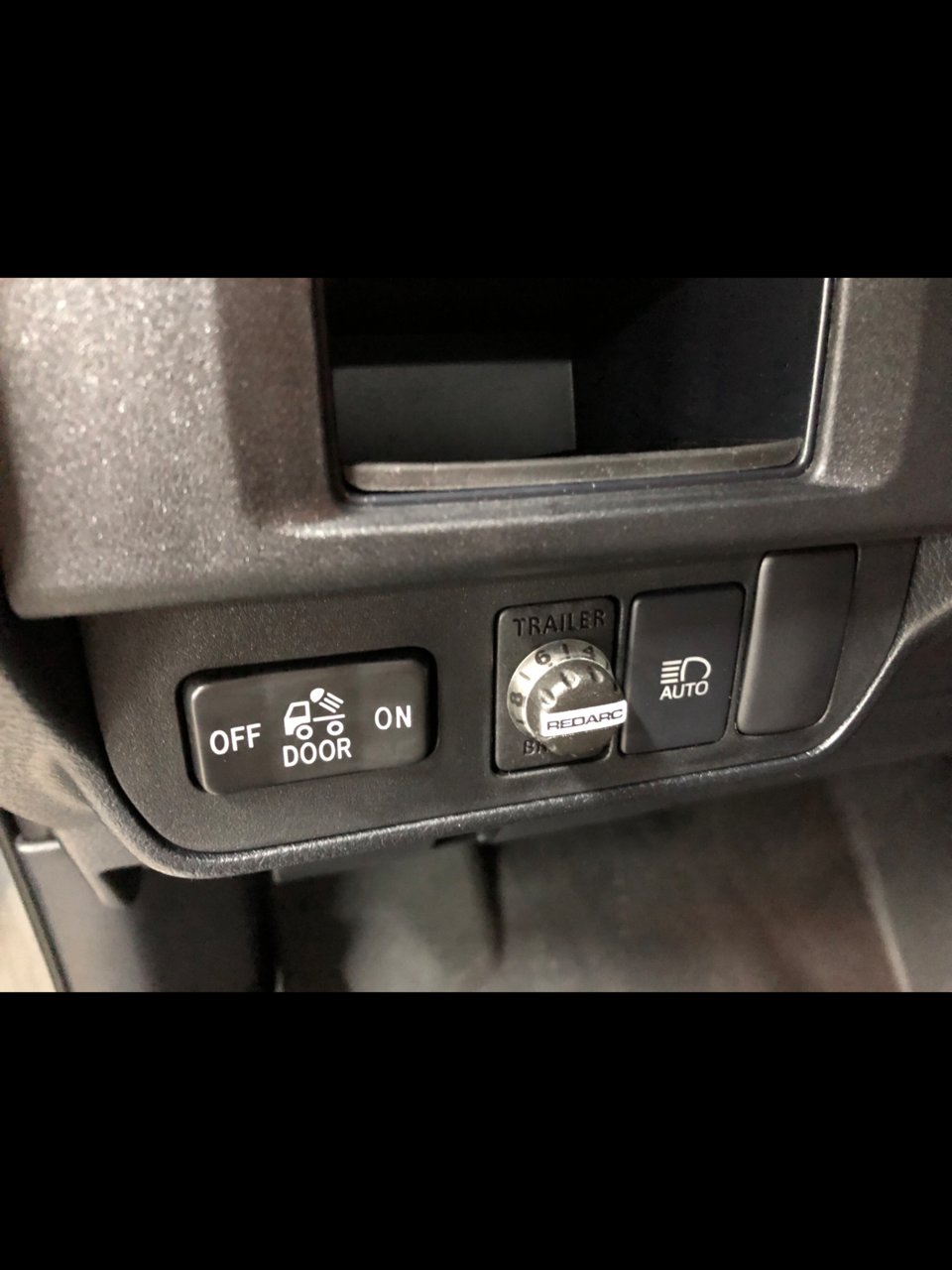

    Ditto the RedArc Tow Pro Elite, I've not found anything easier to use and as clean an install.

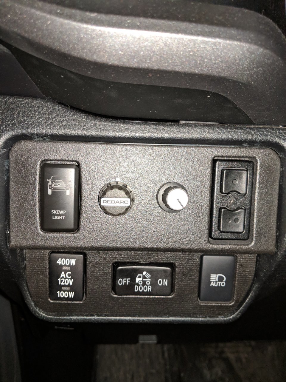

    RedArc Tow Pro is where it's at, just wish I'd put it on the left side of the switches, little hard to see where I put it.

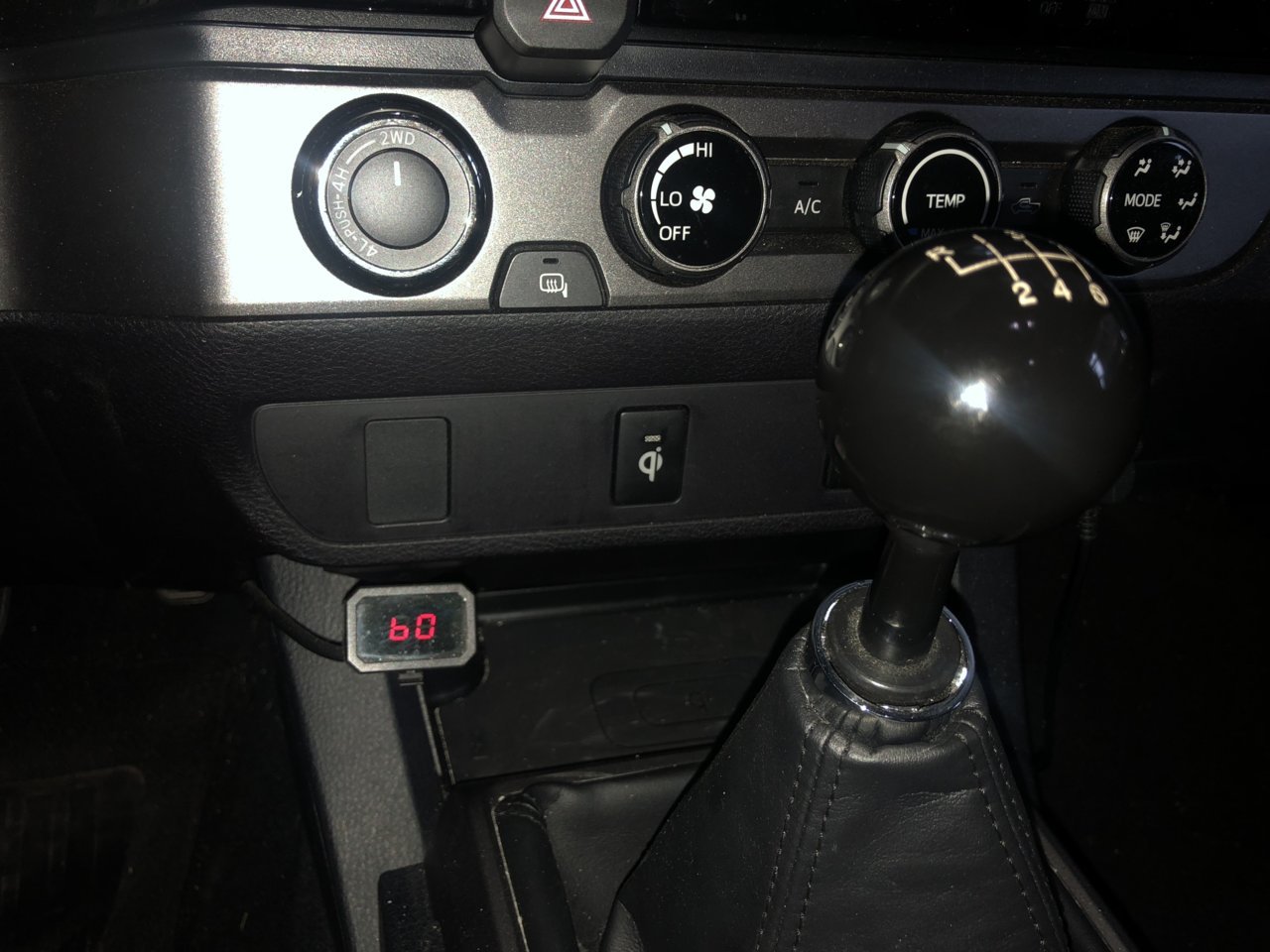

    Agreed, I put mine where the clutch start cancel is on the manual (gotta auto tranny). Getting the Meso ECT button mod leaves a perfect place to move the Tow Pro Elite.

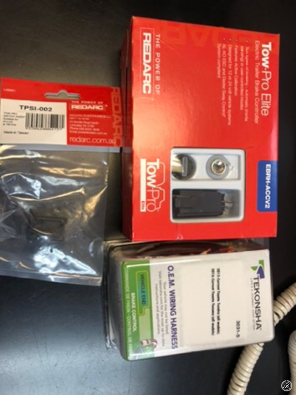

    Thanks everyone for the info. Now does the red arc need an adapter or does it come with several? I know you have to buy an adapter with the tekonsha
