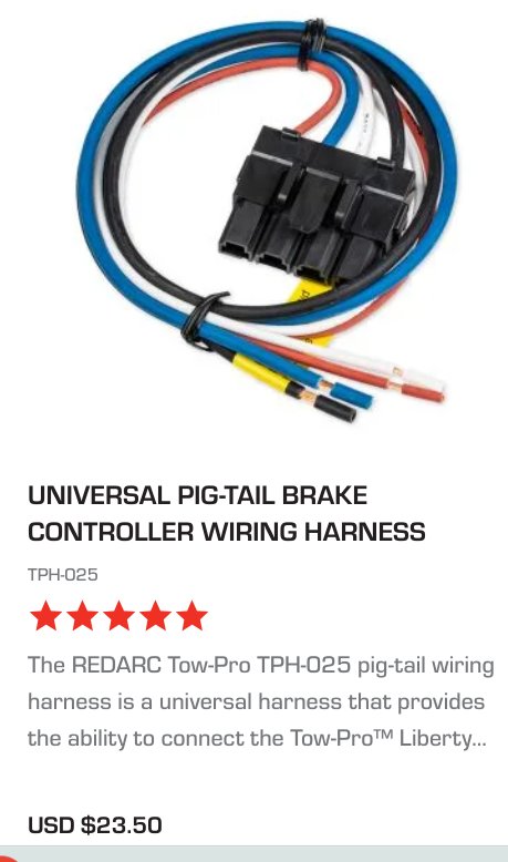

    There is also a vehicle specific wiring harness you need, which I couldn't find on Amazon so I just bought the Tacoma kit directly from redarc.

    Here is the Redarc universal wiring harness.
    https://www.redarcelectronics.com/us/trailer-brakes/wiring-harness?p=2

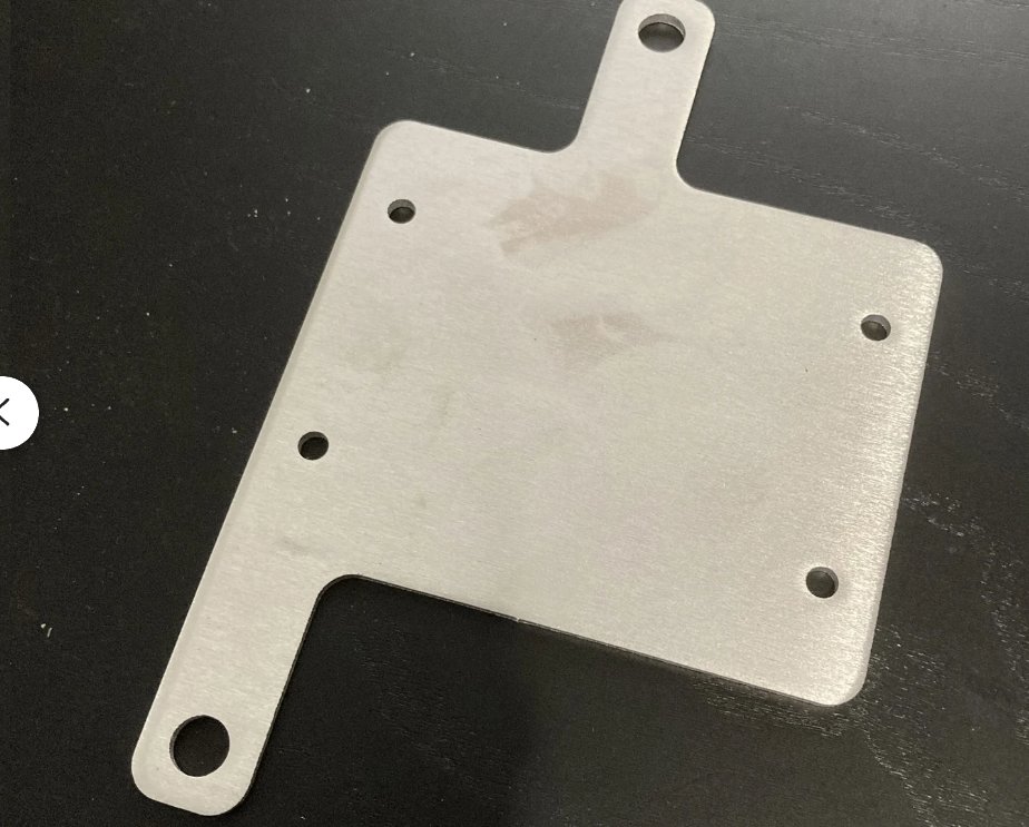

    As @GawainXR linked above this $25 mounting bracket makes for a clean and secure install.
