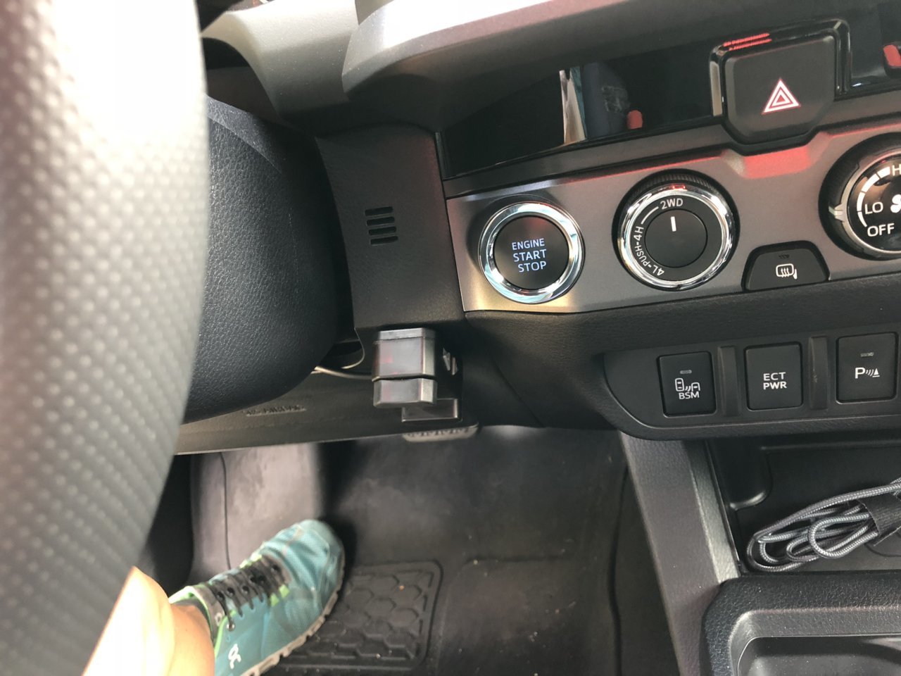

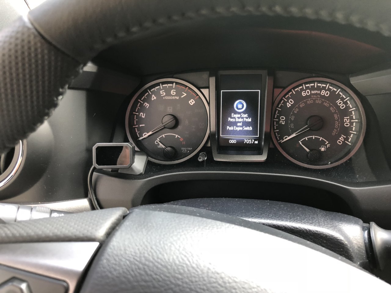

    Install is plug ‘n play if you have the tow package. I went with the Hopkins Insight 47297 controller, and 47816 harness. Amazon FTW.

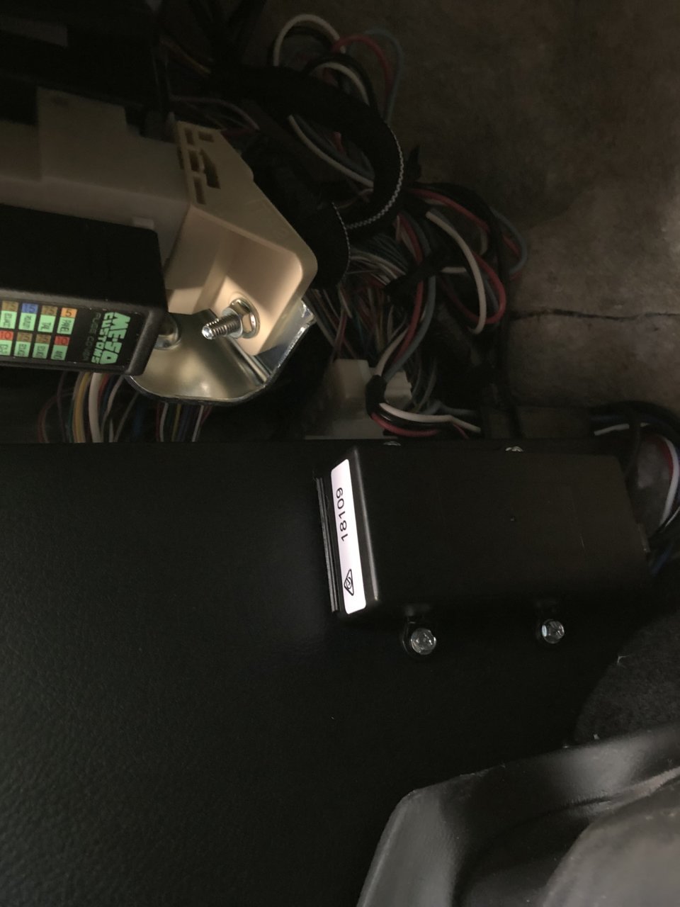

    The Insight has separate display and manual override modules, which provides more flexible mounting. I have the display mounted on my instrument cluster, and the controller under the right side of my steering wheel. The controller “brain” is screwed to the kick panel left of the brake pedal.

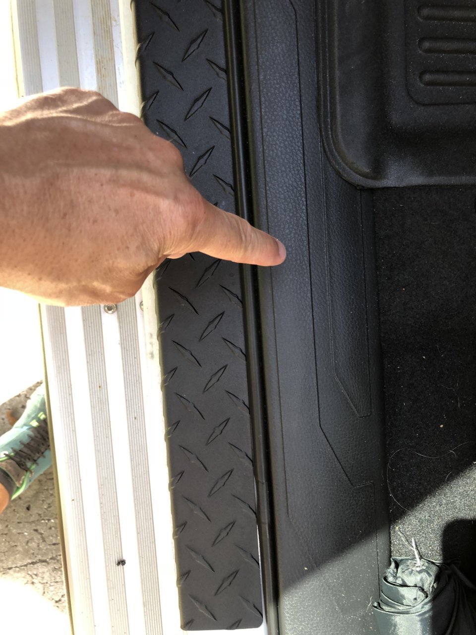

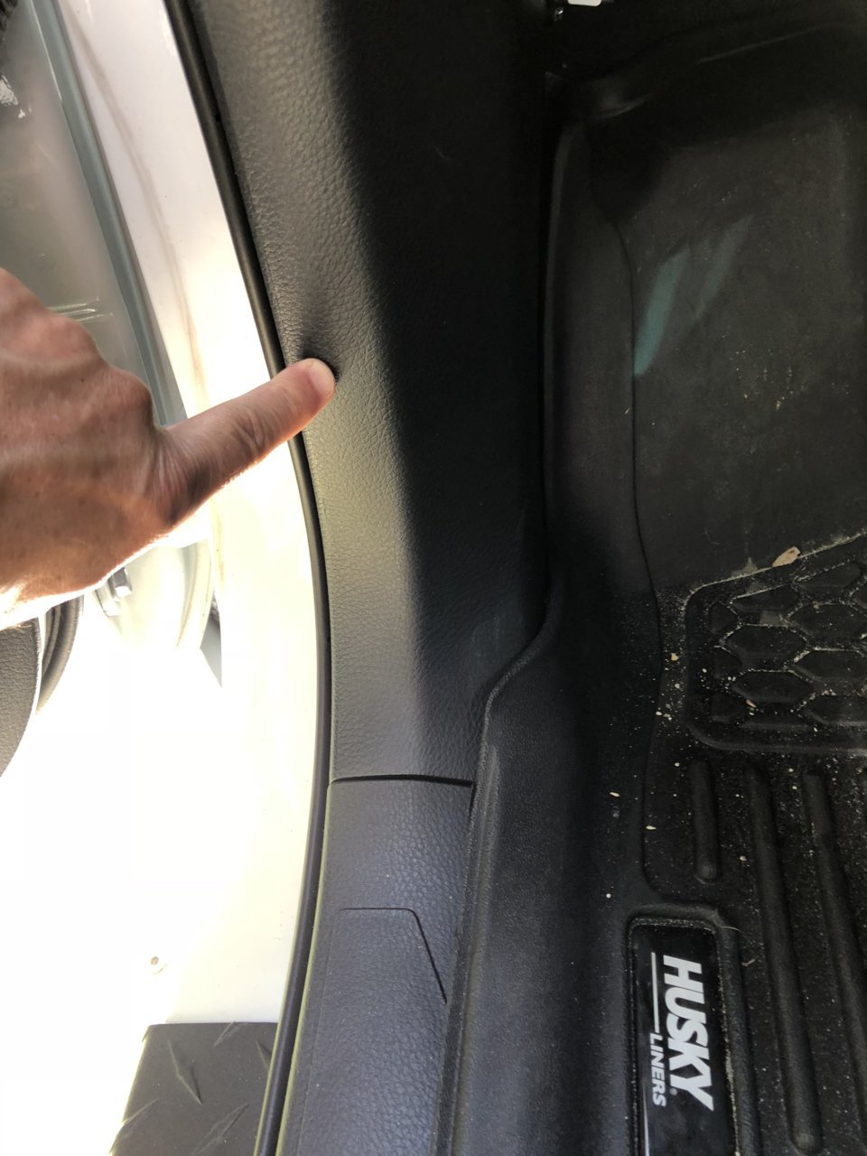

    Pop off the door sill plate, then the driver’s side kick panel. The connector is bundled up there.

    First remove the door sill plate:
    Then remove the kick panel: BF43BCA6-9E30-4C27-9347-241F7A51C1BF.jpg
    The connector is up underneath behind the fuse box:
