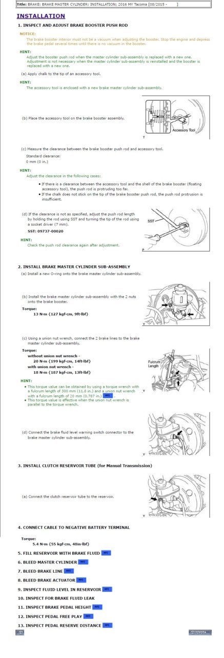

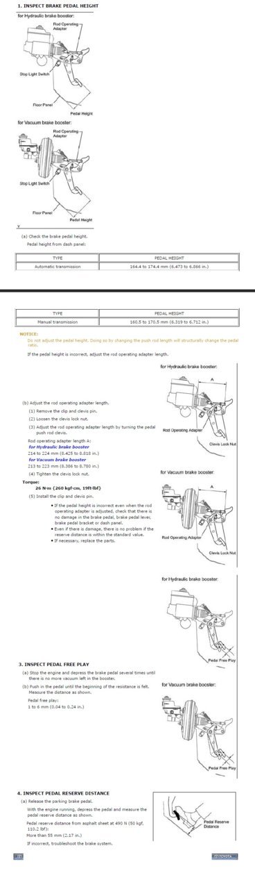

  6. Oct 27, 2020 at 7:43 AM
    splitbolt
    splitbolt Voodoo Witch Doctor
    Mar 7, 2010
    #32761
    7,858
    NW Arkansas
    2016 TRD OFFROAD DCSB MGM
  7. Oct 27, 2020 at 7:49 AM

  8. Oct 27, 2020 at 7:52 AM
    splitbolt
    Mar 7, 2010
    #32761
    7,858
    NW Arkansas
    Skydvrr and shakerhood like this.
