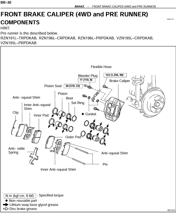

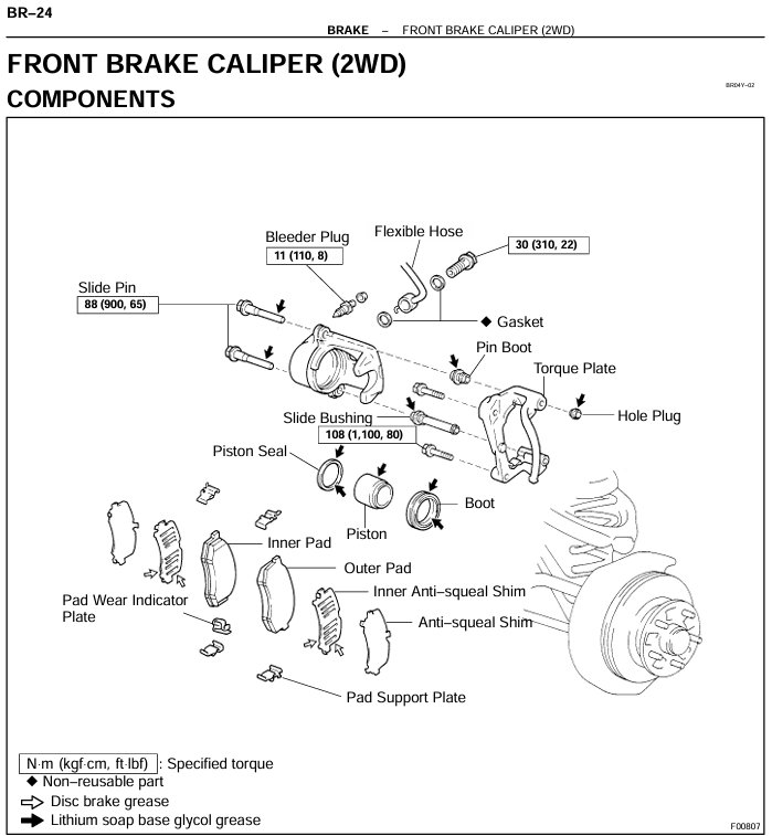

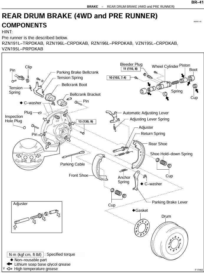

    He is indeed, but I don't think he has much in the way of 5 lug content. So OP should just be aware that most of the guides, videos, etc... and even the parts store folks are gonna have more resources for 6 lug trucks.
    5 lug:
    6-lug:
