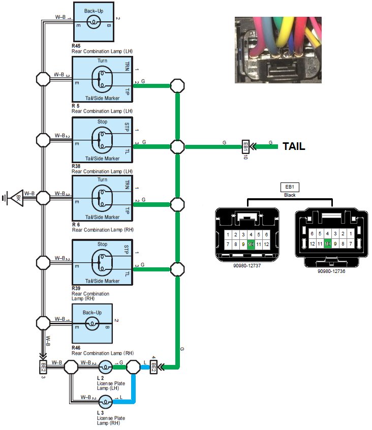

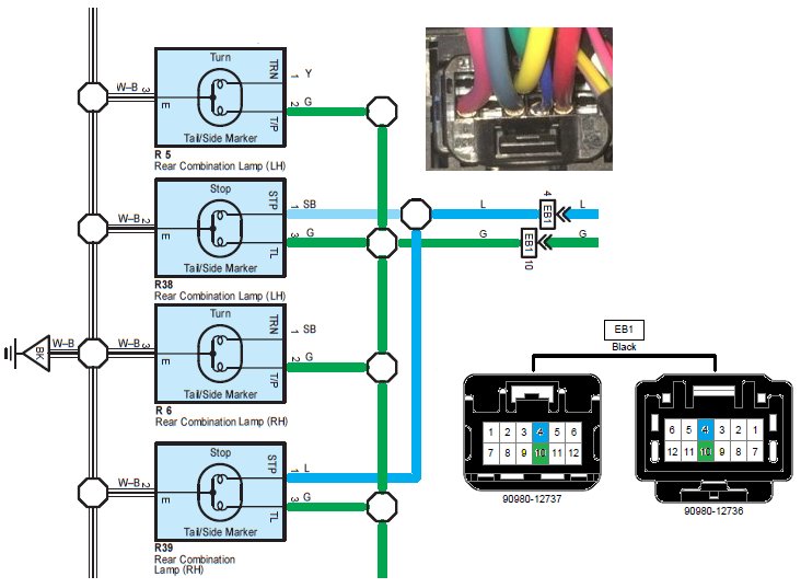

    The ground is shared by ALL the rear lamps to a single point on the left rear chassis.
    I'd verify the wiring for some chaffing since it's affecting 2 circuits, STOP & TAIL.
