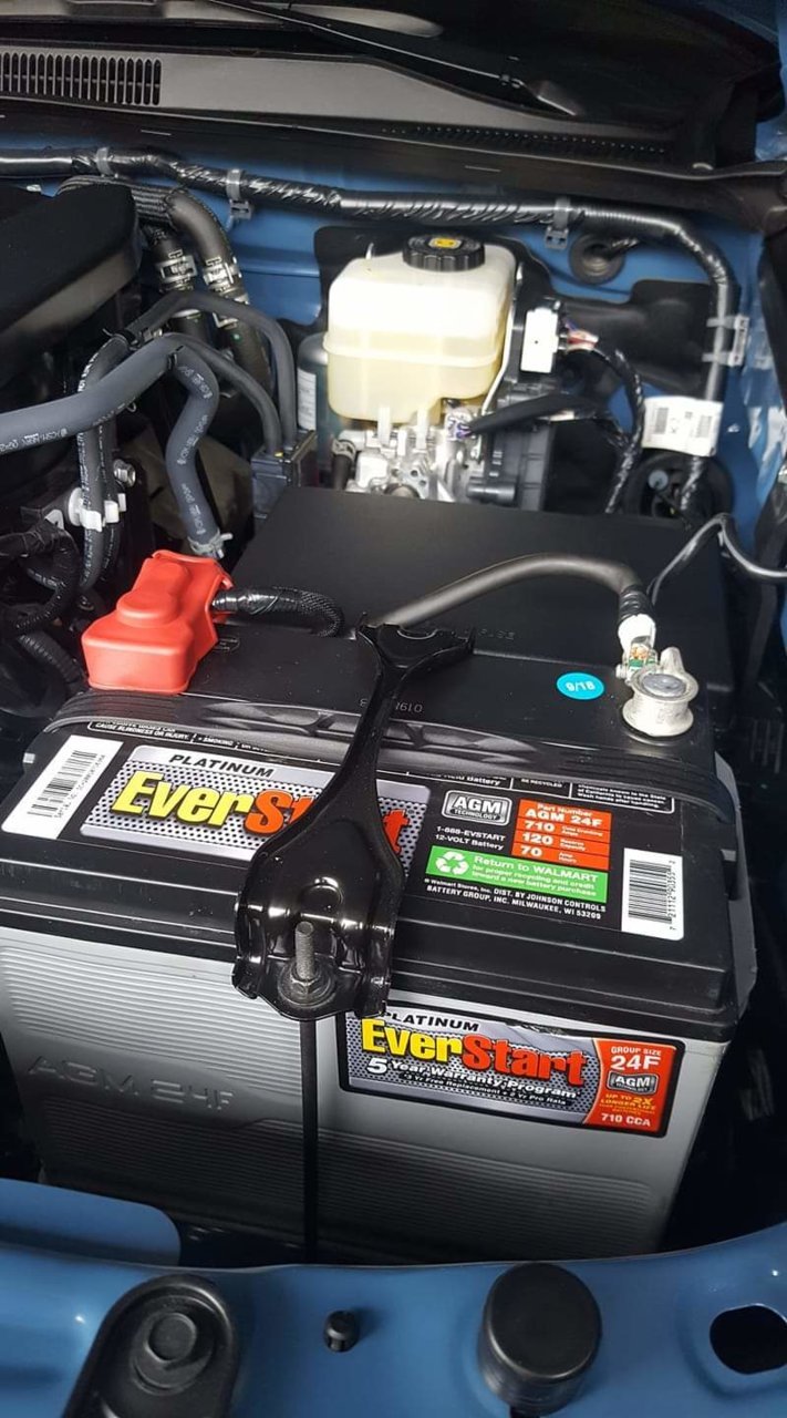

    The Dealer would have replaced the battery under warranty

    Oh yeah I know but I didn't want to be stranded again six months later.

    Ironically you bought a battery made by the same company lol. Johnson Controls makes Everstart as well as OEM toyota batteries.
    But you got an AGM so hopefully have a different experience, although I'm 3 years and 45k miles on my oem battery and its spent a good amount of time in below 0 weather and over 110, hasn't skipped a beat so they're not all crap :)
    I wouldn't be so quick to blame the batter either, you put in some aftermarket stuff that clearly messed with your electrical/canbus system... when you do something that causes electrical problems its not uncommon for the battery to be a victim.

    Agreed. The thing I don't like about OEM is the majority or not maintenance-free so it's very easy for the acid to boil out of the top caps. It was already leaking acid the lights did not cause that. Doing more research I had the lights hooked up wrong. It would have been nice if they would have sent something to show the correct way but it is what it is.
