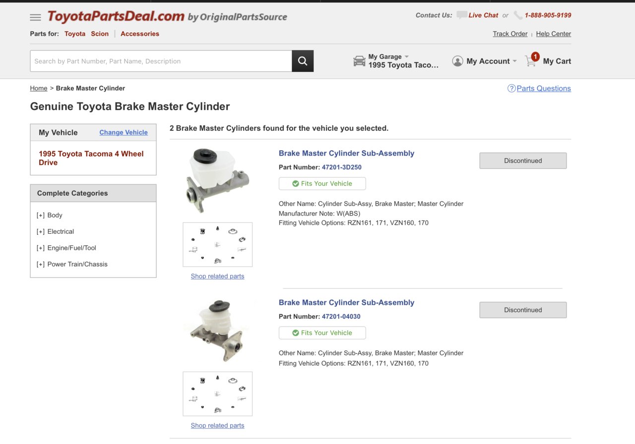

    And nothing lasts forever...eventually you'll have to replace master.....
    or obtain a rebuild kit....
    the more years you put off parts....the more likely you end of having to use Chinese aftermarket....

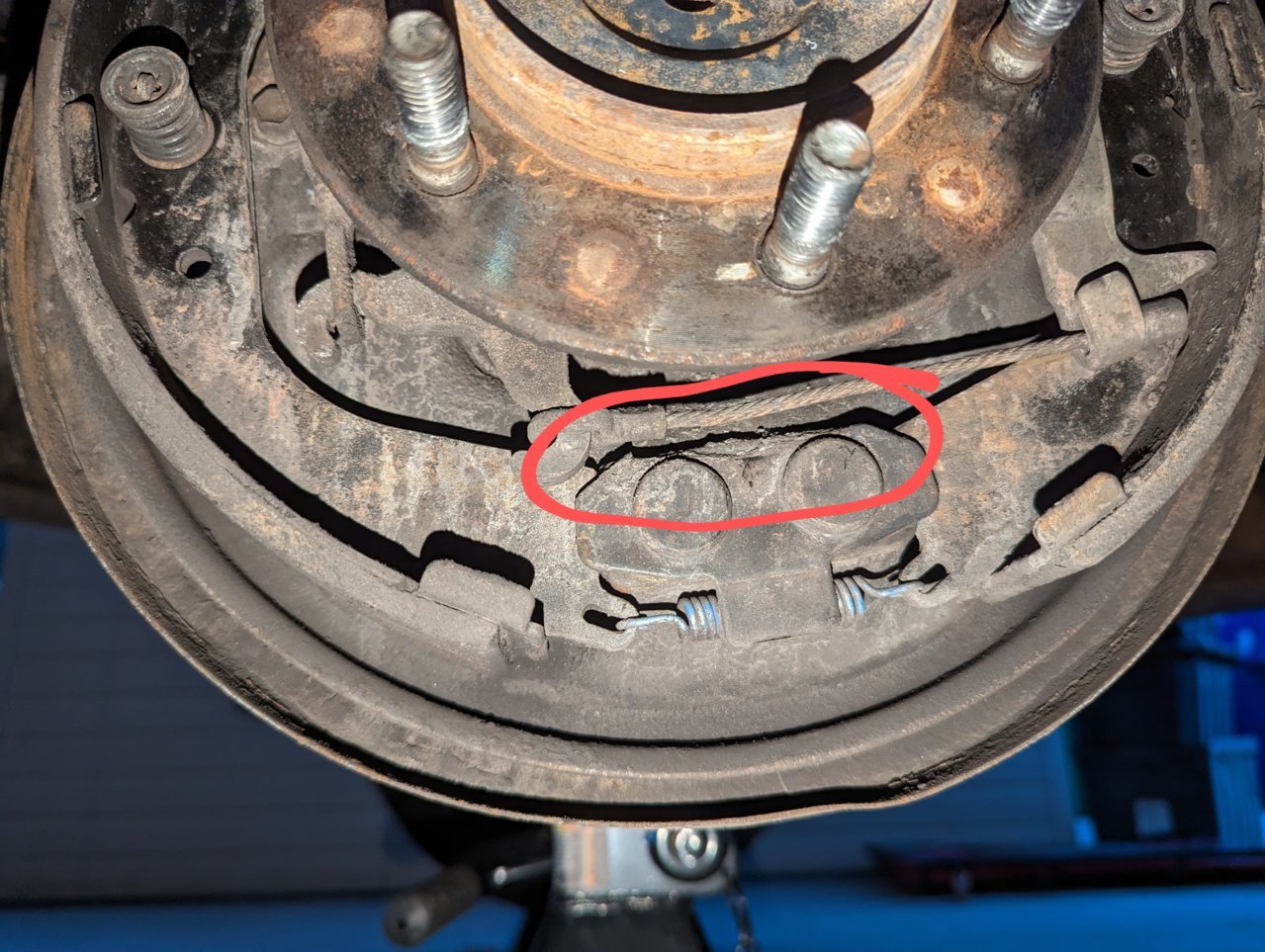

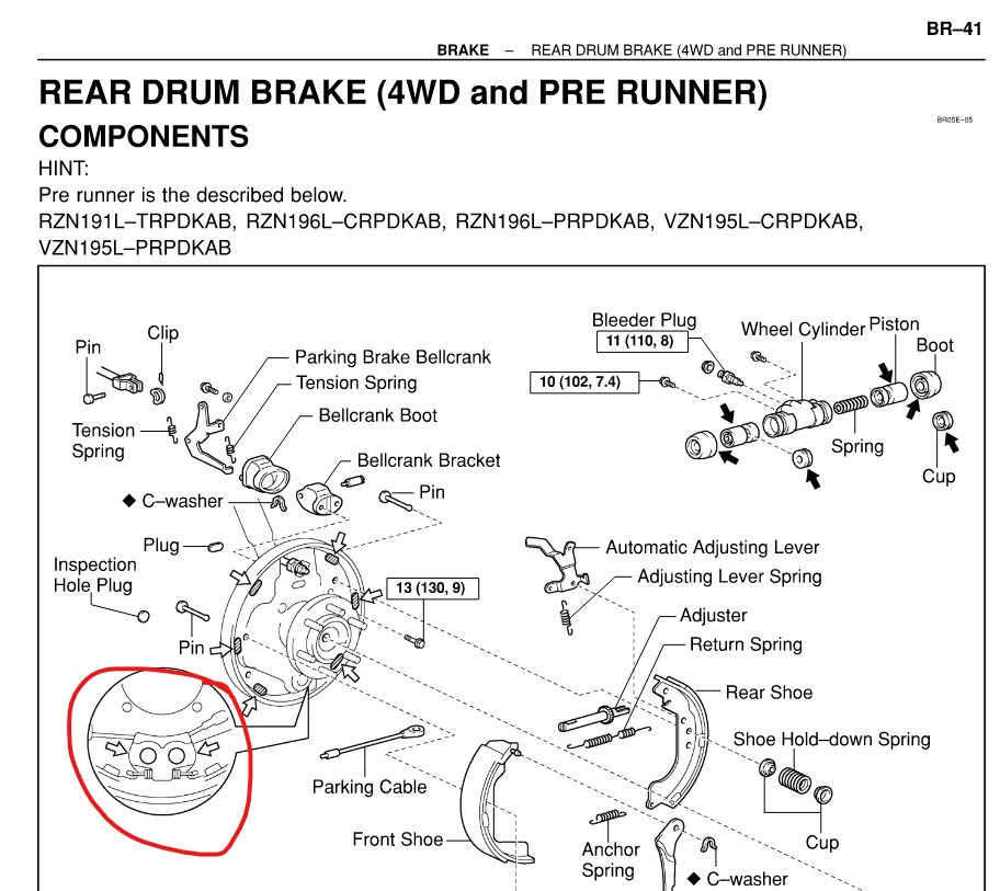

    Maybe the following will help somebody in this situation.
    Last night I was adjusting the emergency brake cable and I just could not get it tight. I removed the drums again and saw that there was a piece missing in the circled area. Normally, that small cable goes under a tab that is bent down. For some strange reason, my truck is missing that bent tab on both wheels. With that little tab missing, the emergency brake cable needs to be pulled much further to operate properly. Guess I better figure out a plan to replace that little tab that is riveted to the backplate. Or, guess I better just replace the entire backplate. I also need to replace the bell crank adjustment bolts but I have no idea what size they are and they are rusted enough that I'm afraid of breaking them off. I'm open to other suggestions.
    edit: After more research, it appears that there were 2 different backing plates used in the 1st gen switching in 2002. At first glance, my truck is the first version. But, I am having a hard time finding a picture of the part. If any of you are in a spot to take a picture of yours, it would helpful for me to track it down.

    Thats a good reason to bust in there every couple of years.....
    not only did lack of lube eat that guide away...
    the shoes were most likely sticking in place and made it even worse...overwhelming the cable...
    PTFE in a syringe....
    This is definitely another bullet point to check when you get the soft pedal and the other obvious stuff checked off...
    If I had a 6lug and lived in the rust belt......I would have an extra set rear drum dust shields on hand......for that inevitable day....
    Hopefully they're easier to get off than the 5lug.....

    Looks like a complete overhaul of the rear brakes is gonna be my next project. If I have to take it all apart far enough to replace the back plate, I may as well just replace everything with clean rust-free parts. Shouldn't be too bad, I should be able to knock it out in a saturday afternoon once I have all the parts.
