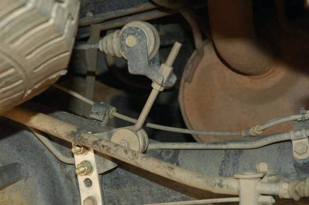

    FYI...This is what he needs:

    Installed like this:

    Without one, as your truck goes up, your rear brakes work less when applied. $19.95 includes metric hardware & USPS priority shipping. :thumbsup:

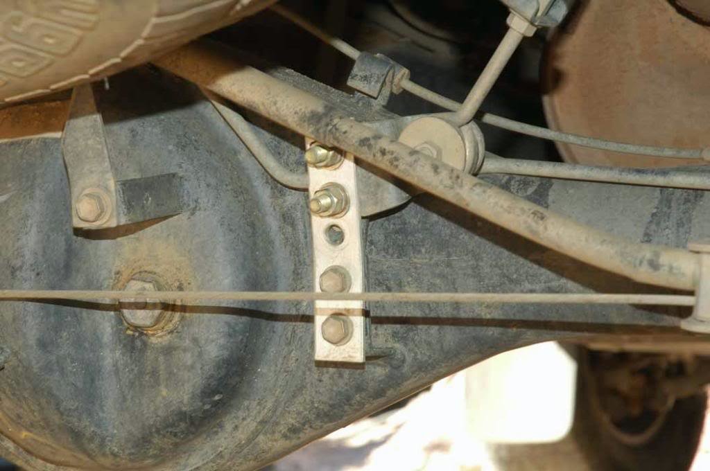

    I know, but they're closed today. :) plus that's my adjustable one w/multiple holes, $10.99 + shipping gets you this one....theirs looks pretty thin too, mine's Beefed with metric hardware so you only have to take 1 socket & 1 wrench under there.
