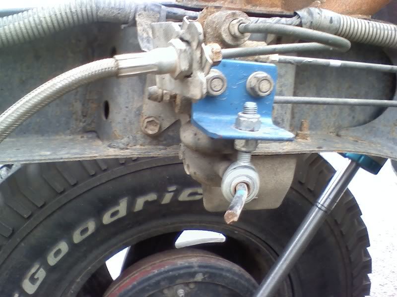

    You guys are making an mountain out of an ant hill. There is no need to spend anymore more than 2.50$ at your local hardware store. Just replace the eyebolt for the appropriate length. Get a long one so you can adjust on your own after you've measured the length increase then go out and test it.
    Go out on a chilled rainy day and start brake testing on black top. That'll get it way closer than you'd ever need.
    Edit: I'll go take a picture of mine. It's worked just fine.

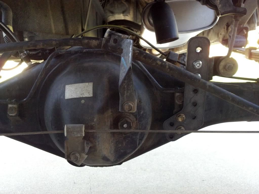

    Thanks Jlee....your brackets look great!!
    Had I know before yesterday I would have ordered one but my truck is on a lift today getting the OME kit install...my mechanic fabbed one ...hope it works...here is the pic:
