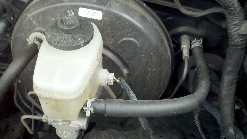

    It may not be on his, but the clutch does share the reservoir on mine. The black hose goes through the firewall to the clutch master cylinder.

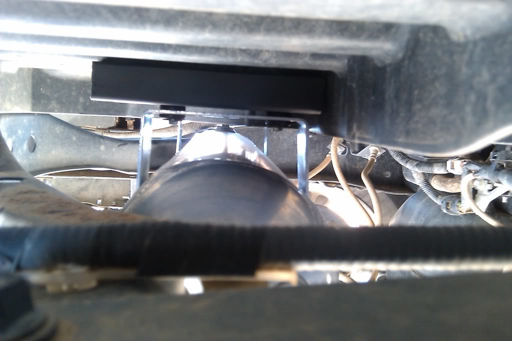

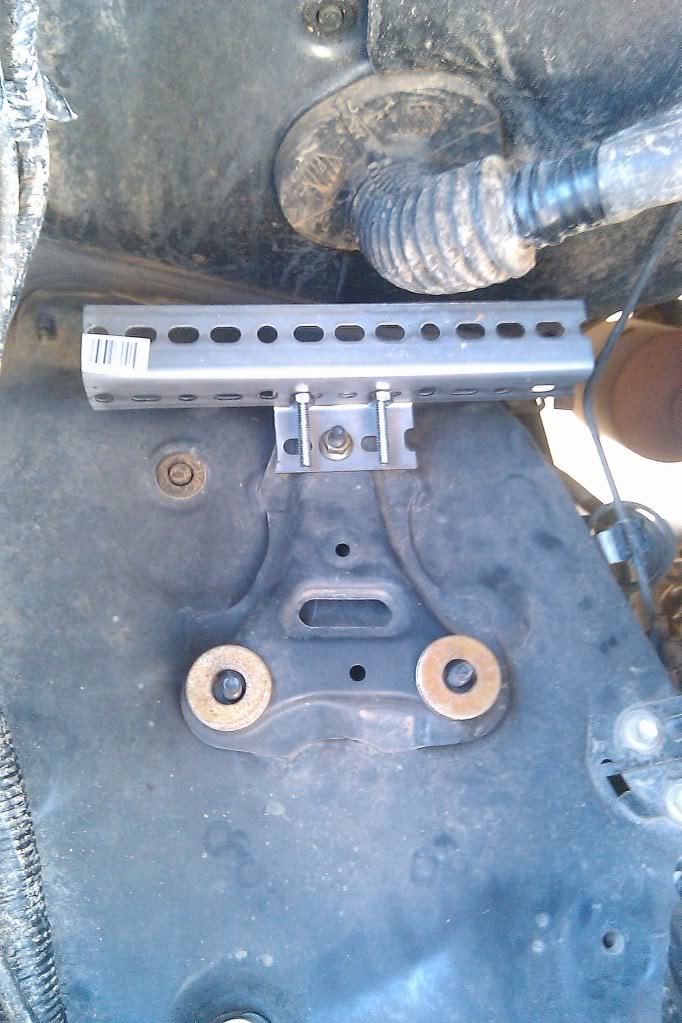

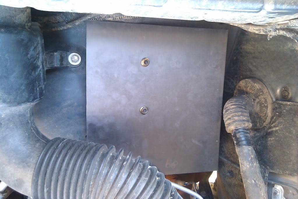

    Yes I did think about this but want to keep all my electric on the driver side if possible. Yours looks great. Love the Viair, that is on my list and want to mount it pretty much right where you did.
    How do you feel about the vibration with the Viair being on the same mount as the fuse box?
    Where did you put your air tank?

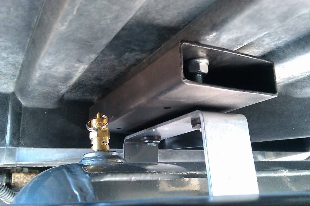

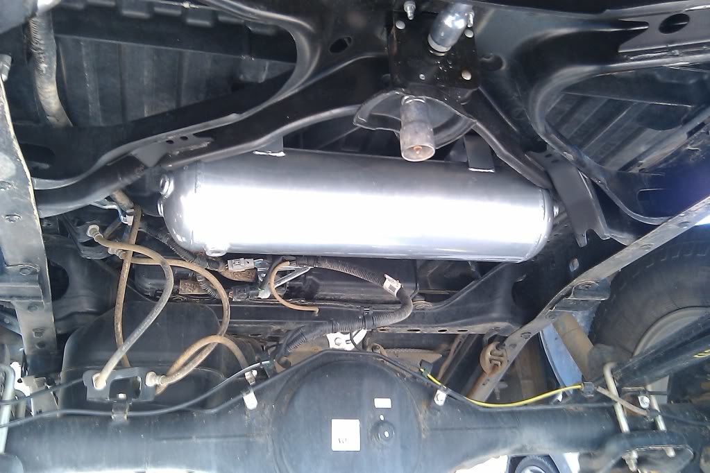

    I am a,bit concerned about the vibes too. I did use lock washers on everything. The compresser does have rubber mounts, but that ain't saying much. I'll just keep an eye on it and mod it If I need to
    I mounted the tank under the bed just behind the axle. I building a bed mount for the spare so there is extra space now. I have seen them mounted between the spare and the hitch, nut I think it could get bashed by a rock easily there.

    The OP has an OFF ROAD TRD 4WD, so he has a HYDRAULIC BRAKE BOOSTER... (not electrical).
