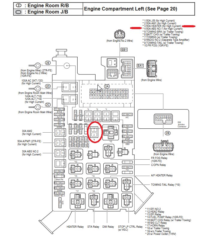

    Then that was the DAC or Auto LSD Relay. The devices the OP circled are fuses.

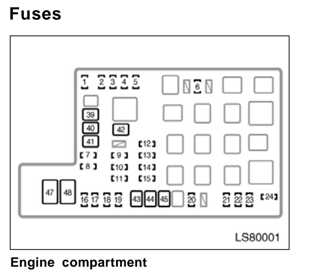

    I might have been thinking of something else I pulled a relay for. It's fuse #42. I didn't have DAC, and I had a real LSD. (Auto LSD was 2009+)

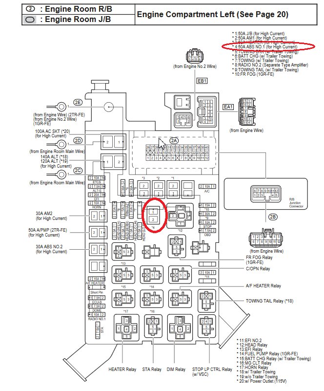

    What you have circled in the picture is the 50 amp ABS Fuse # 1.

    Labeled as 42 in the manual

    I understand that. But it is still the 50 Ampere ABS Fuse # 1. Not that it matters we could call it Fred and it would still be a fuse rated at 50 amps for the ABS System...
    From the Toyota Shop Service Manual.
