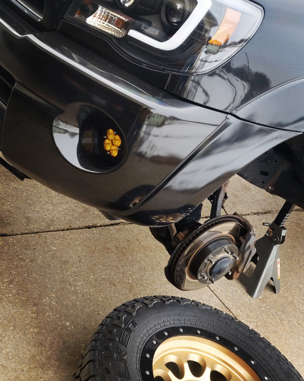

    Im running Stoptech Slotted non cryo treated rotors with Hawk HPS pads. Night and day difference from my old worn out factory brakes. Very firm pedal and excellent stopping distance. Highly recommended for anyone looking to do a slight upgrade over factory parts.IMG_20190309_004508_637.jpg
