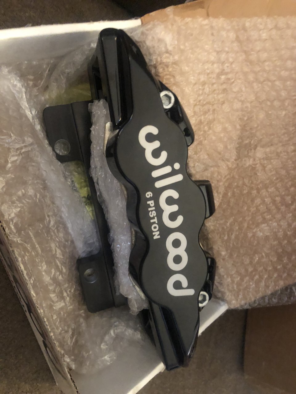

    Look into the 5th gen TR4 2010-2015 at least which is the same as the GX460 not GX470. Issues I have heard on that one. Same pads as Tacoma calipers but the piston is 1mm bigger and the Rotors are about 19mm larger. I have a write up on it and running that setup now. Its been good but now the truck is heavy AF.
    T4R setup:
    https://www.tacomaworld.com/threads...-2nd-gen-tacomas.504234/page-10#post-20336876
    RR-Racing makes a kit that uses the Wilwood Aero-6 Calipers with an option for an external dust shield for better "dirt" play time. The beauty of this kit is its made to work with GX/TR4 rotors (338mm) and are easy to replace if you run into any off.
    Mine arrive tomorrow so will get replacing my TR4 Calipers with the Wilwood Aero-6-DS setup. Currently running Stoptech Sport Slotted (338mm) Rotors.
    Link to RR-Racings Kit:
    https://www.rr-racing.com/RR-Racing-Front-Big-Brake-Kit-for-Lexus-GX-4Runner-p/gx4fbk0002.htm

  7. Aug 13, 2019 at 1:37 PM
    #447
    nudavinci64
    nudavinci64 Robert @ Holy Horsepower
    Nov 14, 2013
    #116533
    10,145
    Robert
    San Mateo/Cayucos, CA
    13 S/C TRD OffRoad 4x4
    Boosted Money Pit....
    These guys arrived today!
