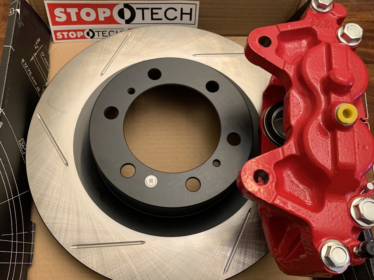

    338mm 4Runner parts! Still waiting on a few things to complete the swap.

    2010+ 4runner 338mm Stoptech slotted rotors (didn't go Cryo this time)
    #126.44174SR
    #126.44174SL
    Purchased from Amazon
    2010+ 4Runner dust shields
    #47781-60140
    #47782-60140
    TRD Pads (same as covered in this thread, 2010 4runner uses the same pads as Tacoma)
    PTR0989111
    PowerStop 2010+ 4runner remanufactured 'performance' calipers - uses larger pistons than Tacoma
    Toyota 4runner 14WA calipers
    Note summit's coupon codes at top for extra savings
    -You can use less expensive remanufactured calipers. Centric is a good name and less expensive, I just wanted a high quality rebuild and liked the idea of having them powerdercoated. There is nothing truly adding 'performance' about a stock caliper rebuild.
    Stainless brake lines from Wheelers Purchased these as they are USA made. Though seeing Headstrong offers +1" is interesting.
    All this is well documented in this thread:
    https://www.tacomaworld.com/threads...unner-bbk-upgrade-for-2nd-gen-tacomas.504234/
    What I like is that everything is OEM, so you have off the shelf parts availability/flexibility. Size is up from 319x28mm rotors to 338x32mm rotors, which is really close to the StopTech 340x32mm BBK. The front calipers have larger pistons as well, so you are also getting a better caliper too, though not as nice as forged aluminum StopTech calipers. Though, you can get Wilwood BBK 6piston calipers from RR-Racing for the 4runner that would be plug and play with these rotors on a Tacoma, giving the advantage of a larger off the shelf rotor bug nicer caliper, while still coming in at a decent cost savings over other BBK alternatives. Although the 4runner calipers have a larger piston volume than the 6 piston Wilwood calipers.

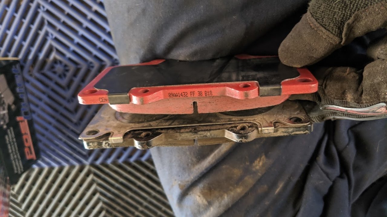

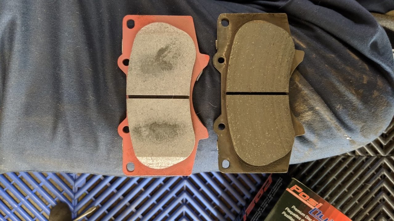

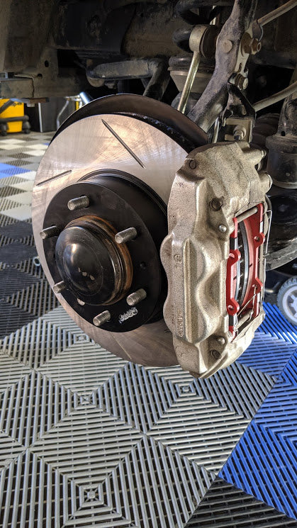

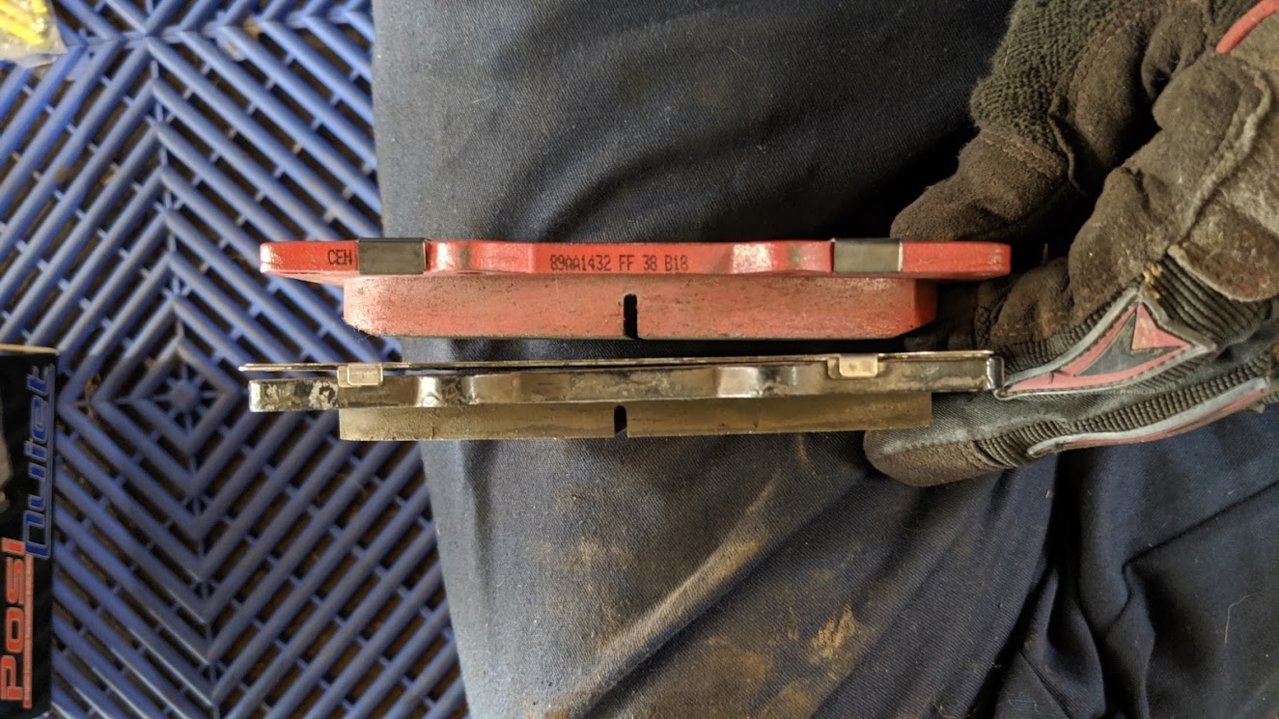

    The OEM 3rd gen pads and the TRD performance pads are interchangeable. See the pics below. I installed those pads with the cryo Stoptechs on my 3rd gen with no issues yesterday. Now to find somewhere I can do some 60 to 10 pulls/stops...

    Awesome info!! Thanks for being a pioneer for 3rd Gens! Strange that Toyota doesn’t list it as compatible for 3rd Gen. I’ll add the info with a link to your post in the original post.
