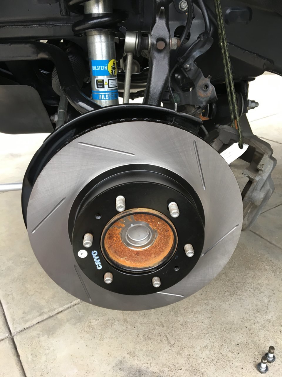

    I just ordered a set of rotors. I just found out that my breaks are done. I was waiting for a light to come on, but since the breaks have been making a grinding noise I decided to check and no pads left. Hopefully I don’t mess them up during the break in.

    Tacos have no electronic brake wear indicator, in other words no light is going to come on, on your dash.

    Done. Thank you for the info. Now I have to figure it out on how I’ll set the pads. 60mph to 5mph 10 timess in a row?? Not sure that I have a road close by where I can do this.
    Any suggestions?

    I tried for early morning Sunday highway, but still no luck. Ended up having to do the alternative break in procedure.

    Find one good stretch and go back and forth. I did it behind the HS down the road from me on a Sunday am.

    I think that it works If you do it back to back to keep the heat on the discs. That’s why it says 10 times.
    Can these disc get resurfaced?

    Yeah the brakes have to get hot enough to melt some of the pad surface evenly all around the disc. And yeah they can be resurfaced once
