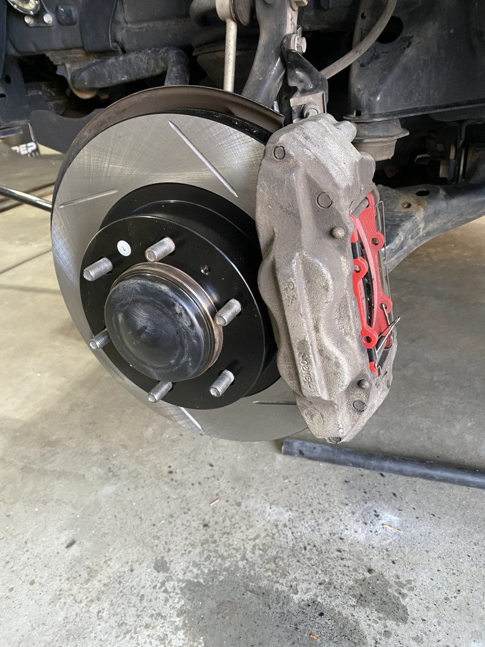

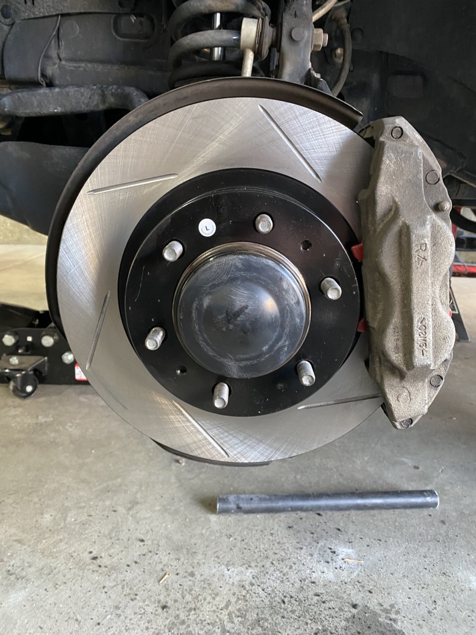

    Got the kit installed last night, fairly simple install. This thread, a couple of YouTube videos and two beers made it easy. I was able to do the 10 hard stop break in procedure for the pads. After letting them cool and giving them a good couple of tests, there is a noticeable difference in braking. Delivered to my door I paid $324 for everything, dealer quote for just new pads was $343, total no brainer.
    Thanks @crashnburn80 for such a great thread!

    Finally had chance to break in the TRD pads and find cell coverage. To recap for everyone, we installed stainless steel brake lines in the front with stop tech slotted rotors, and TRD brake pads. Total cost including installation for the rotors was about $500. I did install the brake pads themselves, first time for me. It was super easy.
    My overall impression is that breaking feel is a bit more firm and stopping distance has been improved slightly. However our primary goal is improving breaking reliability going down steep mountain passes with our extra heavy weight. I believe, that has been achieved. I would do this again.
