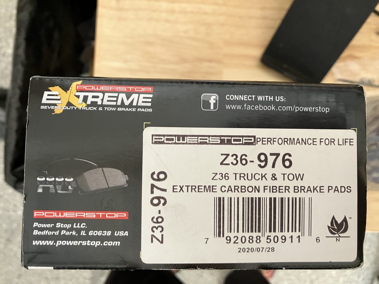

    Anyone know if I can use these pads on either of my stock Tacoma calipers / rotors (‘05 and ‘16)
    My limited understanding thinks they will, got them for my Tundra but went with EBC green at the last second.
    I guess I should get rotors too?

    Organic EBC green stuff isn't one I'd recommend for a Tundra, I wouldn't even recommend them for a Tacoma. They have good initial bite but fade very early with low peak operating temp, making it easy to put more energy into the pads than they can handle with a heavier truck. They are much better suited for a light weight car.
    As for your pad question, 05 and 16+ take the same pads. Do 1st Gen Tundras and Tacomas take the same pads? If so they should be usable.

    I think the truck / suv green might be different pads than the car green?
    but now I will have to look and confirm if I’m running orange or green for the 5500 lb tundra.
