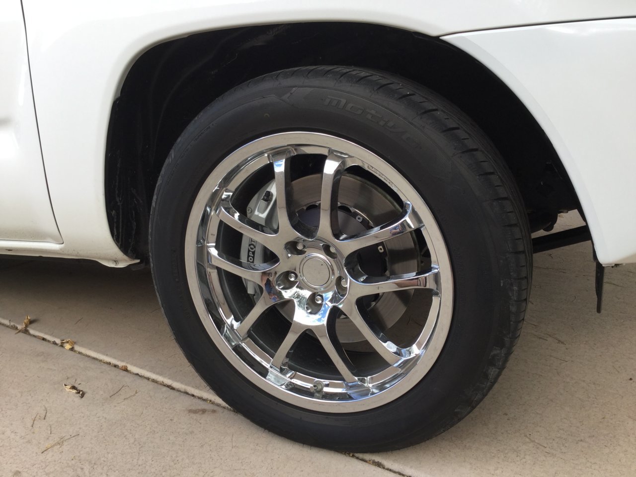

    Hayrider
    Hayrider Over the hill & going down fast...
    Jun 29, 2018
    #257836
    844
    Hey You…
    Convection Oven AZ
    15 DCSB & X-cab SOLD for more than new‼️ Now 05 & 07
    Reg Cabs, 5 lug, 5 spd, Magnuson & LS Swap, StopTech’s, Yada Yada Yada…
    I also like plan rotors! Can you say noise wheelies?
    Oh, the wheels are 19" foraged Rays with 245/50-19 or 28.6" tall Nitto's. Stock 215/70-15 or 26.8" tall.
