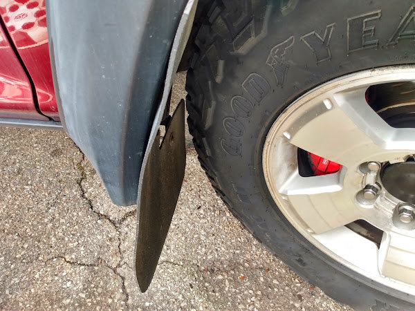

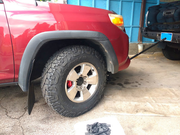

    14WA calipers and matching rotors fit stock 17" +30mm Tacoma wheels. Running them on my 5th gen 4Runner to clear 33" skinnies on stock suspension:
