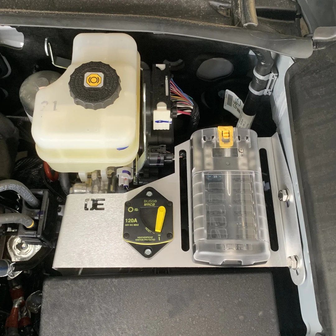

    Sorry to hear what happened. When the hydraulic booster fails, you can still stop but it takes a LOT of effort. Clearly so much effort that in this situation it was too much and you couldn’t stop. Do you by chance have any mods like the Overland Equipped power tray near the booster installed?
    Unfortunately if you do not have that tray then it must be a freak thing and you probably need a new booster as a result…..that really sucks to find out it doesn’t work when you need to stop.

  16. Jun 9, 2024 at 6:37 AM
    #16
    soggyBottom
    soggyBottom Well-Known Member
    Sep 19, 2018
    #266818
    1,991
    This is most likely off topic, but isn't that a blue sea fuse block? Correct me if I'm wrong, those are rated to 100A combined. Why is there a 120A main?
  17. Jun 9, 2024 at 6:41 AM
    #17
    BLtheP
    BLtheP Constantly Tinkering Member
    Apr 5, 2022
    #394355
    4,602
    Plano, TX
    2021 MGM TRD On-Road DCSB MT
    RC60F Transmission ADD delete with FJ full-time tube FJ Metal Clutch Pedal OEM Mexico-Spec Condenser Fan 265/70R16 Michelin Defender LTX M/S 2 OEM 1-Piece Lug Nuts Custom Built Switch Panel for all Electrical Accessories Rigid Amber Pro D-SS Ditch Lights Rigid 30" SAE High Beam Driving Light Bar Rigid SR-Q Pro Back-Up Light Kit (Recessed) VLEDS Tail Conversion VLEDS Foot Well Light Kit KC HiLites Cyclone V2 Under Hood Lights Operable (Switched) Clutch Safety Bypass
    I don’t know, not my photo. Just showing an example of that tray which has caused failure of the hydraulic booster in the past by being too close to the booster’s power wire and rubbing through the insulation, shorting it to ground.
