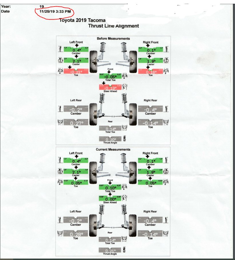

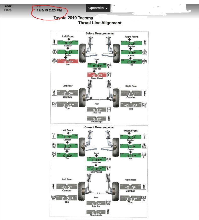

    Keep in mind the before and after specs are deceiving. The steer ahead is not centered on either of the before specs. basically when the tires are turned to even it out it will change your toe angle. ex. on the 2nd alignment you had -0.21 and + 0.16.. once the steer ahead is evened out the toe angle would be -0.025 on each side. the toe angle spec range is from -0.13-0.00 therefore the toe angle was within spec when it arrived. they did adjust it a bit but the specs where nowhere near where they appear at a 1st glance.

    You've got .2 degrees more caster on the left, so of course it's going to pull to the right, especially on a crowned road. And the dealer didn't check your tire pressures before their first alignment. That might have a tiny effect, but it's the caster that will really define it. Always remember that it pulls toward the lower caster side, which is this case is to the right. Add to that a road crown and there you go. Certainly the tires didn't help but your numbers are off from the git-go.
