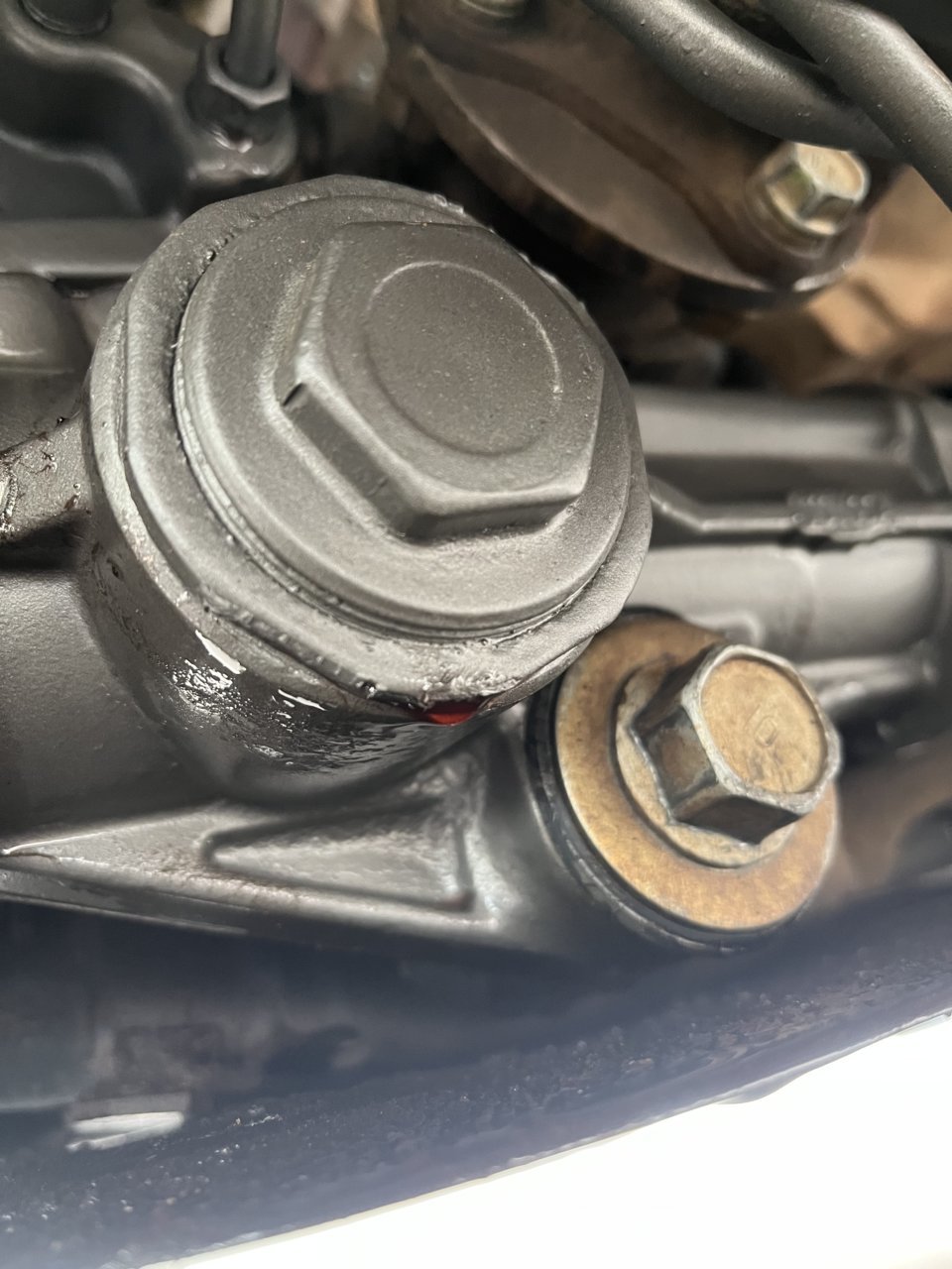

    Hey all,
    First time poster here…
    I bought a 2002 Taco two weeks ago. I discovered a significant leak on the steering rack where it meets the boot. I had it replaced with oem rack and tie rod ends. It was parked in the garage and noticed atf leak coming from multiple points, but primarily the big nut. Is this normal for a new rack or should I bring it back to the shop? Unfortunately the shop is quite far from me, but was highly recommended in a fb group. Thanks!

    A new rack should not be leaking

    I bought a new OEM rack from McGeorge a couple months ago. Yours doesn't look like the one I received. The "big nut" on mine is recessed vs external on yours. Might want to ask the shop where they bought the rack from.

    That looks like an old rack that has been spray painted silver. Maybe a reman, definitely not new and it definitely should not be leaking.

    I find it hard to believe that Toyota would spray paint all over the hard lines. Might want to look at your work order to see where they bought it or call them and ask.

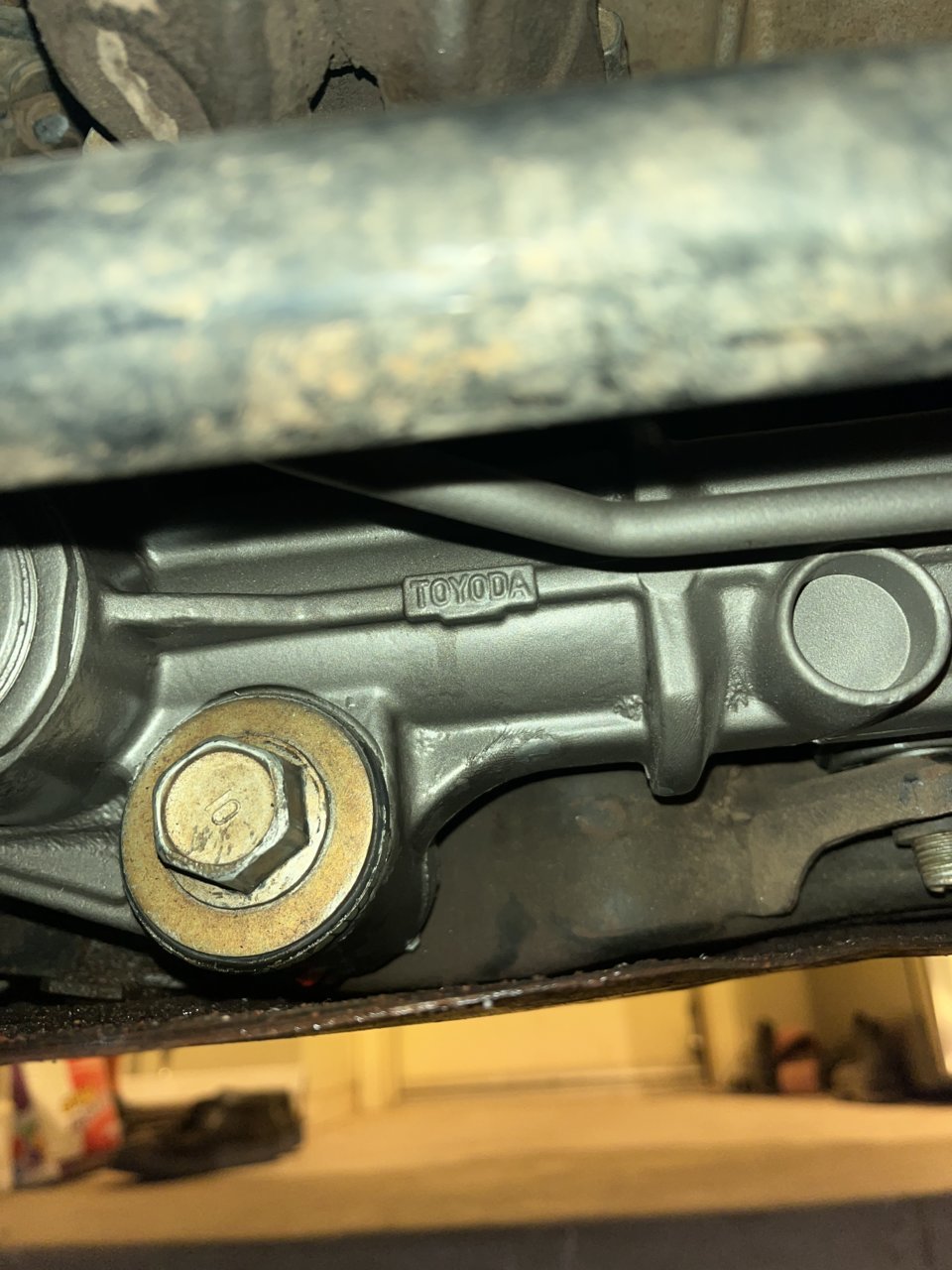

    Ah, that’s a bummer… I noticed mine and the one above says “Toyoda” and not Toyota. Is that how it’s supposed to be?

    Yes, that's actually how it looks on the OE rack. Toyoda is how the family name was originally anglicized https://en.wikipedia.org/wiki/Kiichiro_Toyoda

    Yes it should say Toyoda, the family name is spelled that way and they build the racks in house. That part is right, but that is an early model rack and clearly a cheap rebuild. You want the newer OEM style

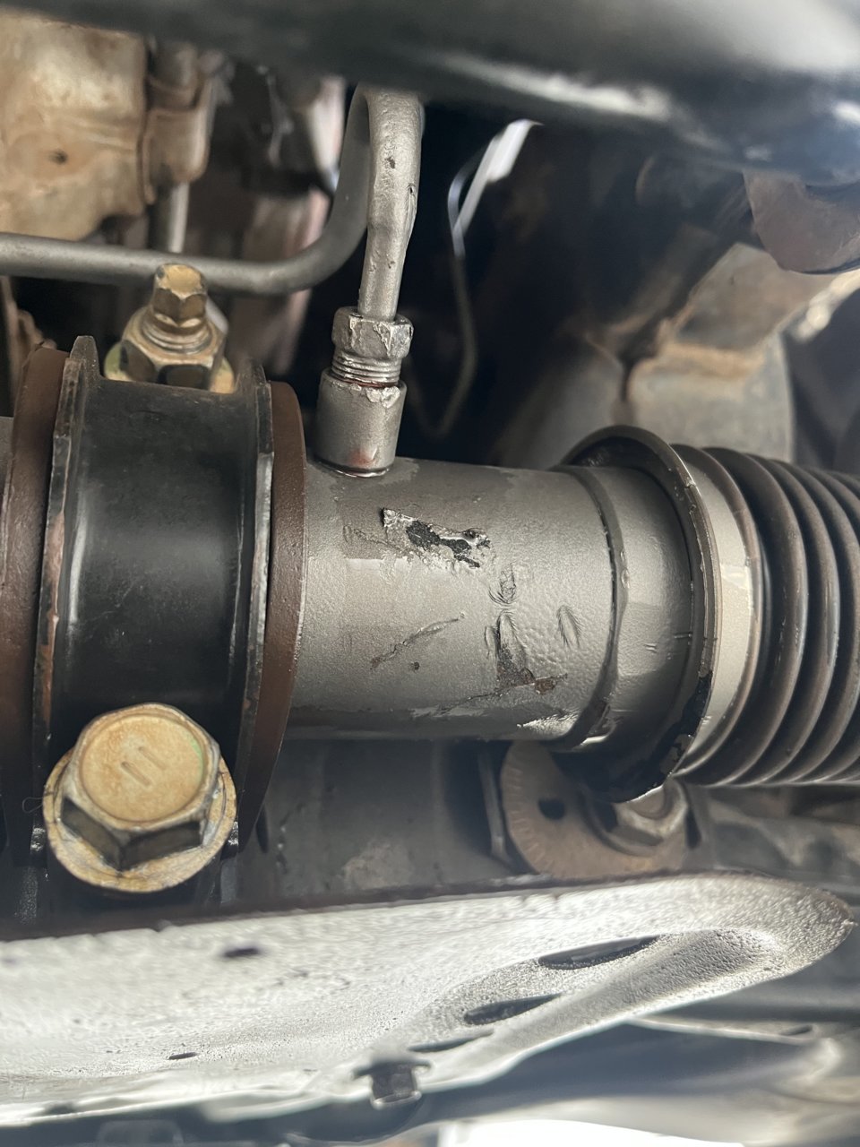

    @beebzor even the reman I bought at Detroit Axle was the newer Allan style bolt, not the Hex bolt.
    and yeah, they sprayed cheap silver paint over everything, looks like that rack was marred already on the side of the passenger bushing, wtf
    maybe they "remanned" your rack and though it would be ok with new seals?

    Ok, so it is a reman. The shop is doing a warranty on it so hopefully it’s all good this time around. Thanks everyone for the quick responses!
