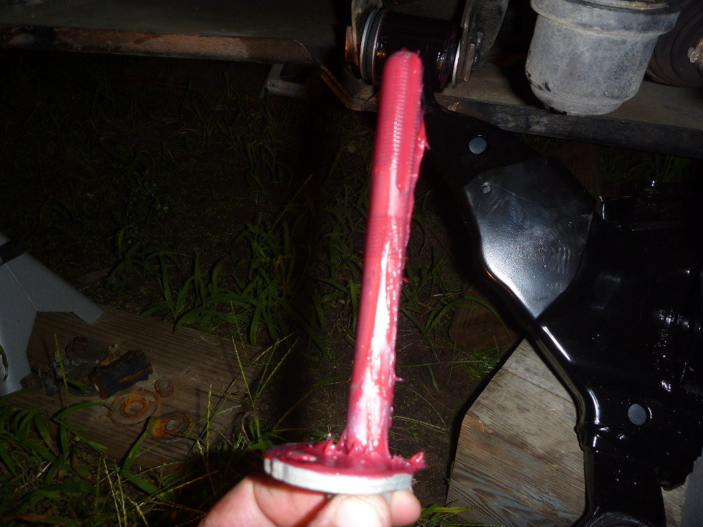

    Threads finally done for them. http://www.tacomaworld.com/forum/su...-cam-replacement-2005-tacoma.html#post5088138
    Keep your shit greased.....PB and WD ain't gonna do it.

    XXXX, do see any reason not to use anti-seize compound instead of grease? Based on my experience with it in similar conditions, it holds up well enough for this application, maybe better than grease.
