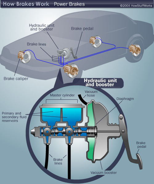

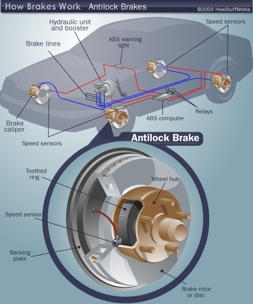

    It sounds like a master brake cylinder to me, but only because I’ve seen this problem a couple of times at max on one vehicle without ABS and one with ABS.
    I would rule air out because I can’t recall ever seeing a hard brake pedal with air in the system.
    But if the brake feels spongy, then yes air is fair game. But this (air) ought to be ruled out by now at the dealer.
    But I would still suspect the hydraulic modulator and ECU module.
    If it would happen to me, and If I could react fast enough, I would put it in neutral, pump the brakes quickly while pulling up on the emergency brake handle.
    I would listen to see if the engine is in fast idle, or wot (wide open throttle).
    If the vehicle comes to a very quick stop, I would suspect some type of computer failure, but if it comes to a stop slowly, I’d concentrate my efforts on the entire brake system.
    Give the service rep as much info as possible, write everything you can think of that you observed at the time, and safe-keep a copy for future reference.
    It helps to practice these steps, as this can happen with any vehicle.
    Stay safe
    Cheers!
