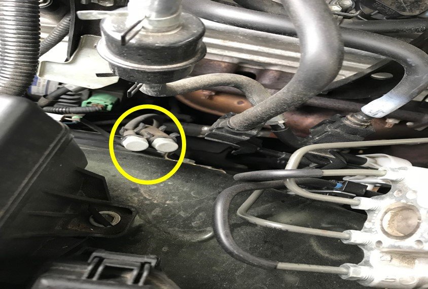

    I have a 2014 DCSB with Auto Trans and V6. Very Stock.
    I am having trouble identifying what breathers are in the engine bay. There is one to a smaller hose and one to a larger hose.
    Front Diff and Transfer case? Does the Transmission have one?
    Thanks for your help.

    Those are in fact your front diff breathers. You also have one on the rear diff that most people relocate

    I found the rear one. Lots of good stuff on relocating that one. Just wanted to make sure the other ones on the truck were high enough.

    those are both transmission breathers!

    Are you sure as it has always been identified as front diff breathers

    Those are in fact the front diff and transfer case breathers. Nothing to do with the transmission.

    I've had my tranny out 3 times! it's an 06 & thats where the ones on my truck are from.

    yes, one does come from the transfer case, hence tranny

    T case and transmission are not the same

    but it is connected & it the hose does meet up with the hose connected to the tranny & comes up the fender well.

    So Front Diff and Transmission?........not Transfer Case? Transmission and Transfer case....not front diff?

    i have a manual, & both come from there

    OK; I like beating a dead horse. There was a lot of conflicting data being slung in this thread. So, there are two breathers under my hood. One is for the front diff, the other is the transmission? Also I have a breather in the rear dif.

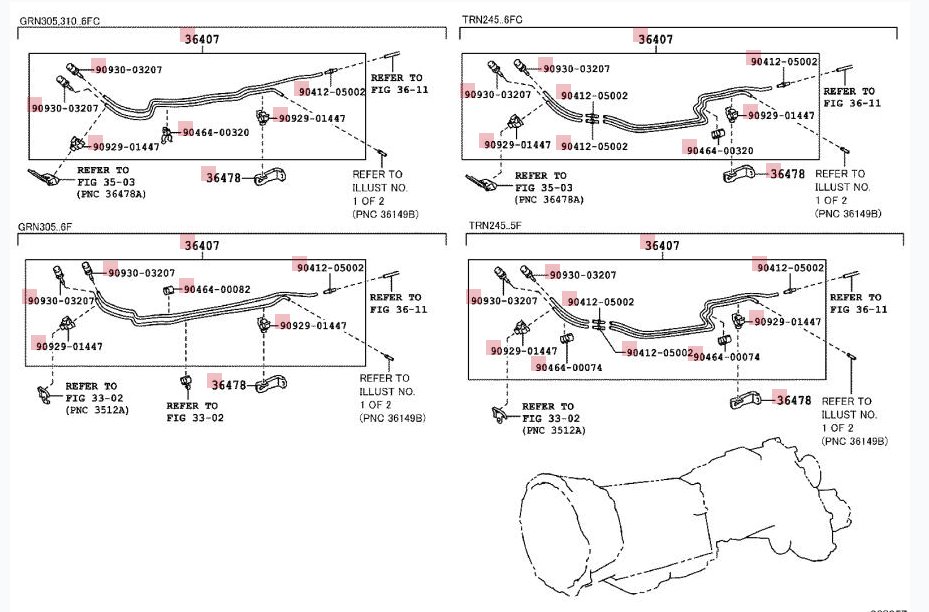

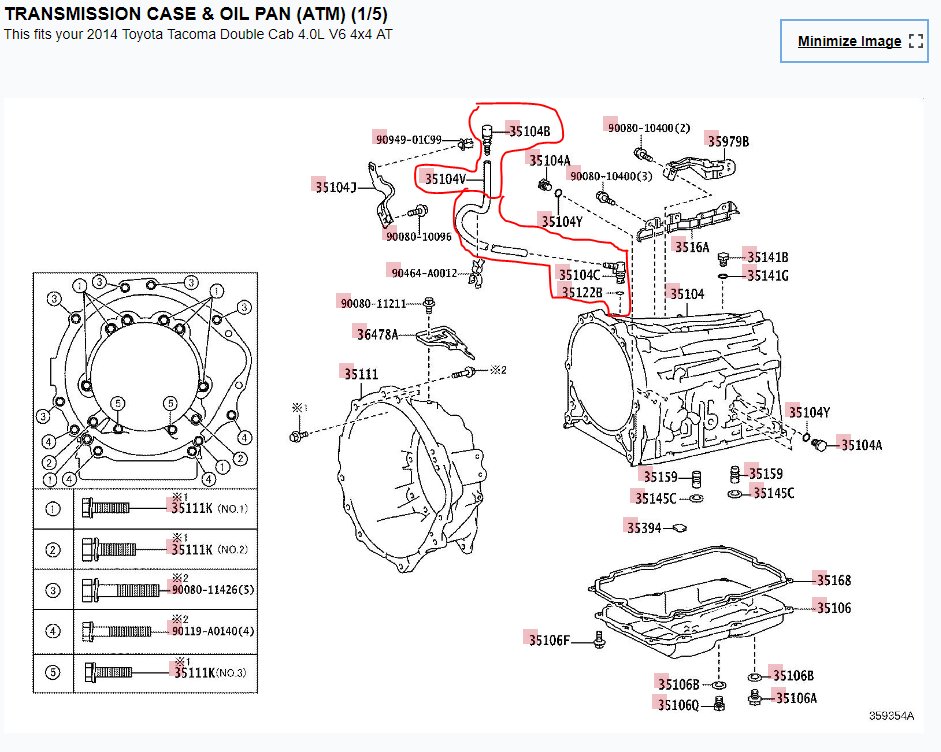

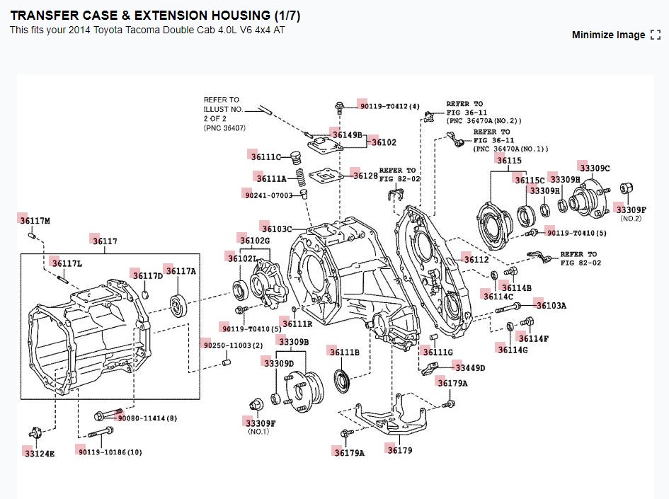

    Transmission - Yes breather (previous picture)
    Transfer case - Yes
    Transmission and Transfer case - breathers may be mounted on the left side of the firewall? :notsure: Can't really tell from the parts diagrams.
    Font axle - Yes (yes appear to be the pictured ones from your original post.)
    upload_2018-1-4_12-41-50.jpg[​IMG]
    https://parts.toyota.com/a/Toyota_2...T-AXLE-HOUSING--DIFFERENTIAL/674470-4301.html
    https://parts.toyota.com/Toyota_2014_Tacoma-Double-Cab-40L-V6-4x4-AT/Transmission-and-Driveline.html
