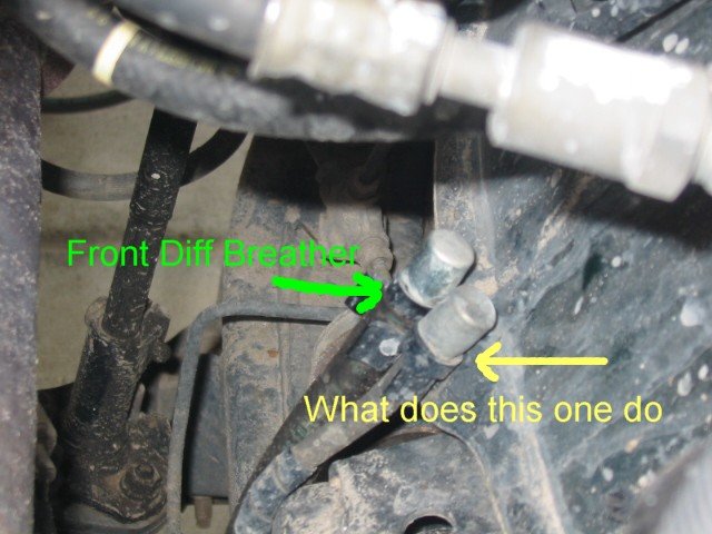

    FIRST OFF I SEARCHED. here and ttora
    and it seems that the more i search the more i get confused so this is for clarification.
    so there are a total of 5 or 6 breathers??
    1.the green one is for the front diff
    2.the yellow one is for the ADD
    what the hell is the ADD?
    3.one on the rear diff that little one right on top. that everyone extends.
    4?.does the e-Locker have one? (or is that on like land cruisers only)
    5.one on the tcase, i dont know where it is but ive heard it goes into the tranny is that right?
    6. one on the tranny goes up to the shifter?
    i have an 02 v6 auto tranny 4x4 e-locker with 4wd shifter, not push button
    Pics would be awesome!!!

    I believe the ADD stands for Automatic Differential Disconnect, that is the auto locking hub system they use

    I might be wrong here, but I think one is for the tranny.....:confused:
    I do know that there is one for the front diff & one for the rear diff. (It is right on the top of the rear diff.)

    One should be front diff, the other is for the transfercase, and then you extend the one on the rear diff.
