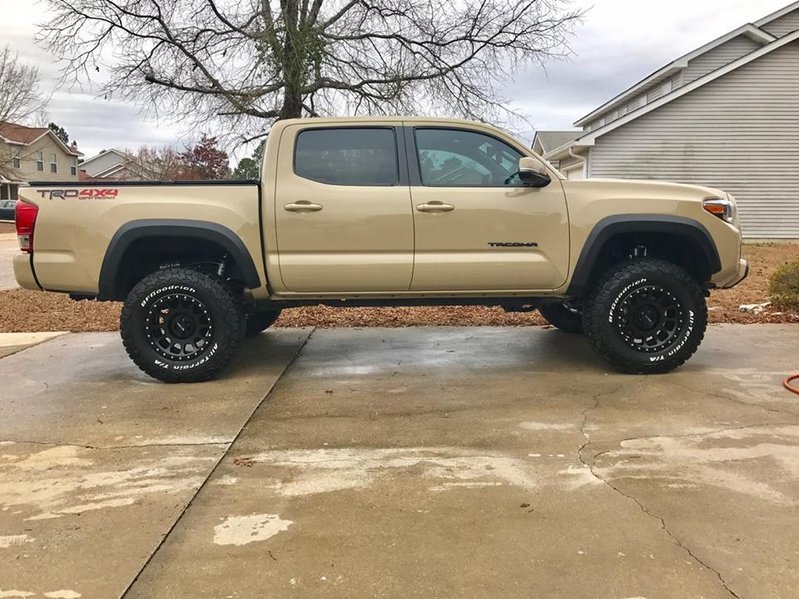

    How She Sits Today
    Exterior
    - Tailpipe chopped above rear axle
    -DIY Power Tailgate Lock
    -Bedliner coated grille with paint matched Toyota logo
    -Black painted "Tacoma" on doors
    -"V6" badge removed
    -Matte Black Tailgate inserts
    -LED license plate lights
    Engine/Transmission
    Stock
    Wheels/Tires
    -Method NV 17x8.5 0 Offset
    -BFG KO2 285/70R17
    -Procomp Splined ET Lugnuts

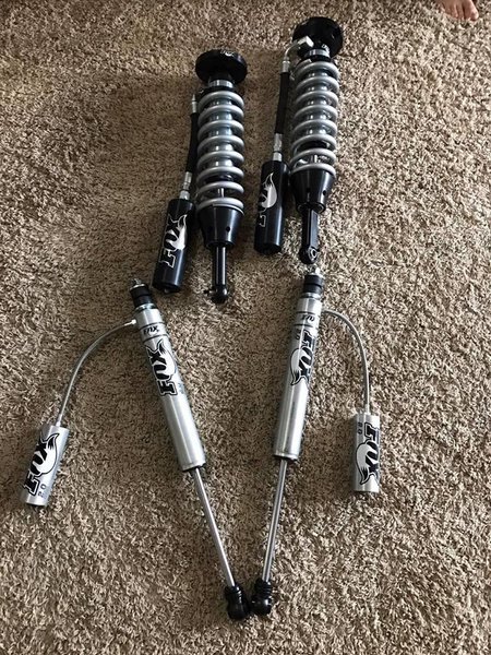

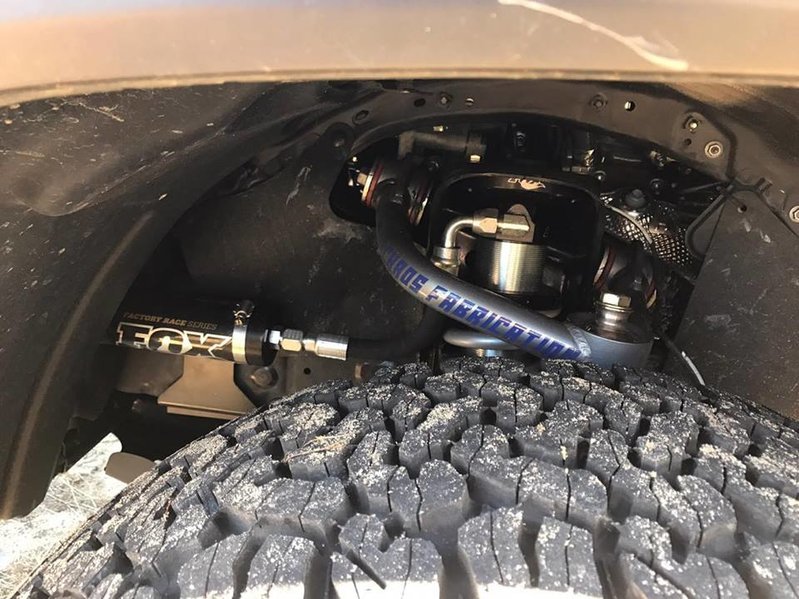

    Suspension Front
    -Fox 2.5 Extended Travel Coilovers w/Resi
    -Total Chaos UCAs
    Suspension Rear
    -Fox 2.0 w/Resi
    -OME Dakar full leaf packs w/extended Ubolts
    Driveline
    -1" Diff drop
    -ECGS 8" Clamshell bushing swap
    -OME carrier bearing drop
    Brakes
    -Crown Performance stainless steel extended brake lines
    Armour
    -All-Pro Apex Sliders Planned
    -Full skids Planned
    Interior
    -Front Weathertech floor liners
    -Rear Weathertech floor liners
    -Complete LED Interior lighting
    -Color Matched Quicksand Bezel surround
    -Quicksand glovebox inserts

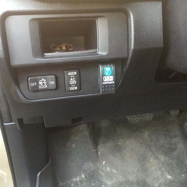

    -ARB CKMA12 Onboard air compressor
    Miscellaneous
    -3" x 30' Tow Strap
    -Jumper Cables
    -First Aid Kit
    -Tool Kit
    -Tie Down Straps
    -Spare Fuses
    -Ice Scraper
    -Gloves

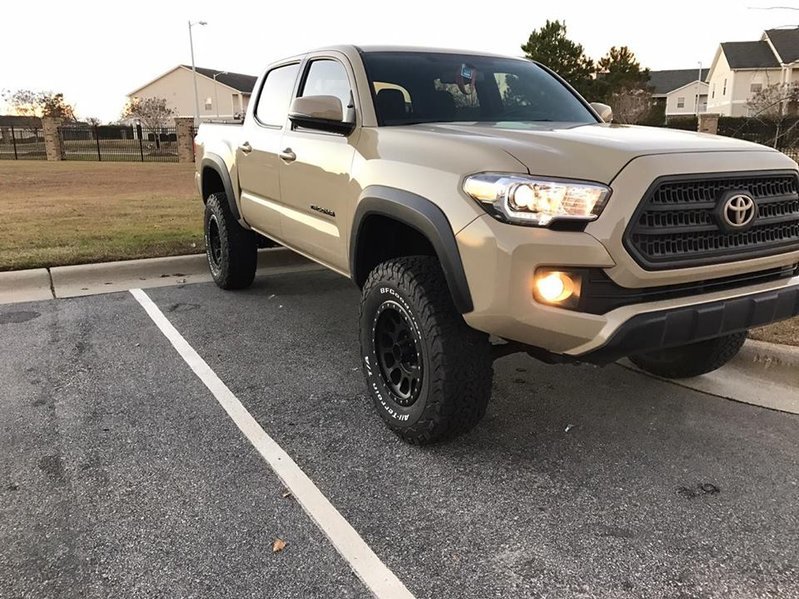

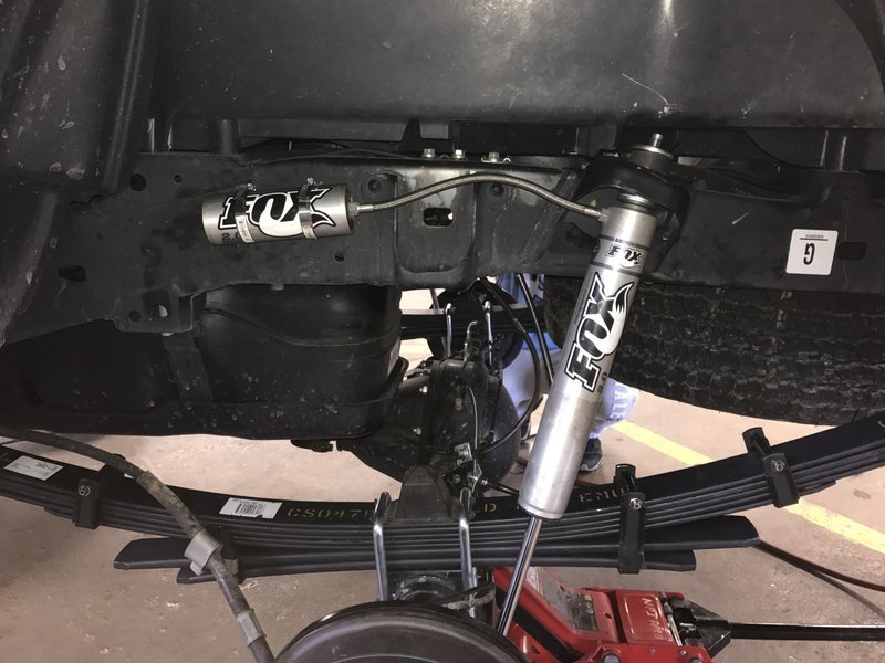

    Any vibrations with the dakars?
    Stiffer than stock?
    brendanwebster911[OP] likes this.
  5. Dec 25, 2016 at 2:06 PM
    brendanwebster911
    brendanwebster911 [OP] Well-Known Member
    Jan 10, 2016
    #174548
    1,044
    Brendan
    Fort Bragg, NC
    2016 DCSBOR 4X4
    Nope, no vibrations.I used the OME carrier bearing drop to avoid those.
    They are a tad stiff when unloaded. But I constantly have weight in the back so I don't get the stiffness at all. They're great with weight.

    Nice. If I do a lift in the rear I'm likely going with the dakars. Might remove a leaf or 2 since I don't haul stuff.
  7. Dec 25, 2016 at 2:27 PM
    brendanwebster911
    Jan 10, 2016
    #174548
    1,044
    Brendan
    Fort Bragg, NC
    2016 DCSBOR 4X4
    Don't remove a leaf!!!! Haha
    I said the same thing. First I removed the 3rd leaf thinking the same thing you said. It felt like stock leafs after that.
    Then I re installed the 3rd leaf and removed one of the overloads. Then it wasn't high enough.
    Finally I put the whole pack together and it was perfect. I wasted a bunch of time to figure that out.

  8. Feb 9, 2017 at 4:41 PM
    East_river AZ
    East_river AZ Active Member
    Jan 15, 2017
    #207631
    33
    2017 TRDoR MT Double Cab (silver)
    Did you loose any wheel travel with the fox shocks and coilovers?
  9. Feb 9, 2017 at 4:44 PM
    brendanwebster911
    Jan 10, 2016
    #174548
    1,044
    Brendan
    Fort Bragg, NC
    2016 DCSBOR 4X4
    Loose?
    No way. I gained travel for sure. Especially the down travel in the rear.
  10. Feb 9, 2017 at 4:45 PM
    East_river AZ
    Jan 15, 2017
    #207631
    33
    *lose
    That's great!
  11. Feb 9, 2017 at 4:47 PM
    brendanwebster911
    Jan 10, 2016
    #174548
    1,044
    Brendan
    Fort Bragg, NC
    2016 DCSBOR 4X4
    Haha my bad.
    I love this setup.! I was pretty iffy at first spending a few thousand, but after a handful of trips to the mountains I'm very pleased with the choice.

    Any rub at all with that wheel/tire combo? The front must be lifted about 3 inches from stock eh?
  16. Feb 9, 2017 at 6:13 PM
    #16
    brendanwebster911
    Jan 10, 2016
    #174548
    1,044
    Brendan
    Fort Bragg, NC
    2016 DCSBOR 4X4
    No rubbing with my current set up. Even on bumps and turns. I trimmed a little plastic from the rear portion of the fender.

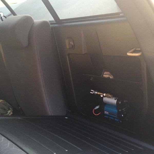

    Very nice. I have 17x9 -12mm offset 4.5 backspace wheels--265/75/17 tires and they were rubbing until I put my 6112's on the top notch, bout 2.5 of lift. Just curious what the air compressor is for? I didn't see air bags on the Dakar's.
  18. Feb 10, 2017 at 10:46 AM
    #18
    brendanwebster911
    Jan 10, 2016
    #174548
    1,044
    Brendan
    Fort Bragg, NC
    2016 DCSBOR 4X4
    I use the compressor for tires mostly. I air up and air down quite often when I hit the trails or mountains.
    I also use it camping to pressurize my water containers to shower and to have running water. I've also run my air impact gun with it for fast tire rotations. It's a lifesaver
  19. Feb 11, 2017 at 5:40 AM
    #19
    stevotivo12
    stevotivo12 Well-Known Member
    Feb 3, 2016
    #176967
    1,638
    Stephen
    2016 Silver Tacoma TRD Sport MT
    Front hellwig sway bar,All pro sway bar end links, Fox 2.5 Resi Coilovers and Shocks, Fox 2.5 Hydraulic Bumpstops, Budbuilt Traction bar, Total Chaos UCAs w/ heim joints, Icon AAL, AFE Power Intake with dynamic scoop, URD spec U, URD short shifter, Flossy weighted shift knob, michelin tires, black badges, black tailgate letters, black grill with custom Diaz Fab Devil horn yota logo, retrofit/morimoto HID conversion, red interior LED lights, Pioneer head unit, kenwood excelon door speakers, 2 10" pioneer subs,
    OP truck looks great! I wonder, did you need to do a diff drop in the front as well with your lift or just the carrier bearing drop? I have a similar lift installed and am wondering if I need the diff drop total chaos sent with the control arms or if this part is unnecessary and I could take it off and put my skid plate back
  20. Feb 11, 2017 at 5:52 AM
    #20
    brendanwebster911
    Jan 10, 2016
    #174548
    1,044
    Brendan
    Fort Bragg, NC
    2016 DCSBOR 4X4
    I used both the did drop and the carrier bearing drop. Not sure if it was needed, but figured it couldn't hurt!
    stevotivo12[QUOTED] likes this.
