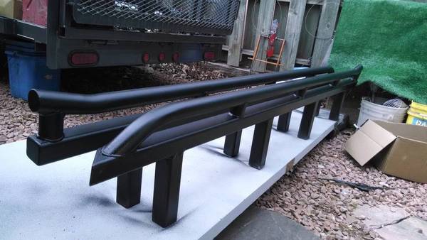

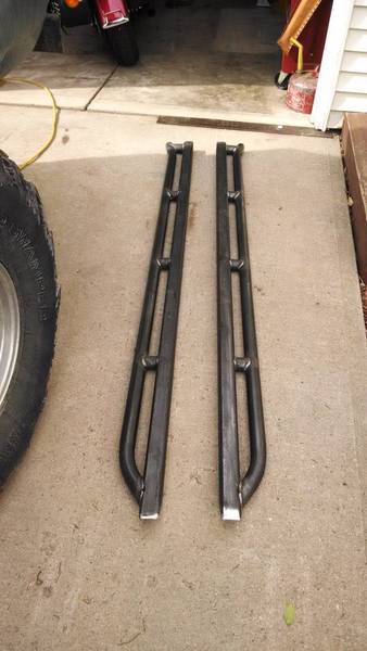

    Sliders are done! Come and get em.............

    :yay:
    I'll be down this afternoon, thanks Scotty!

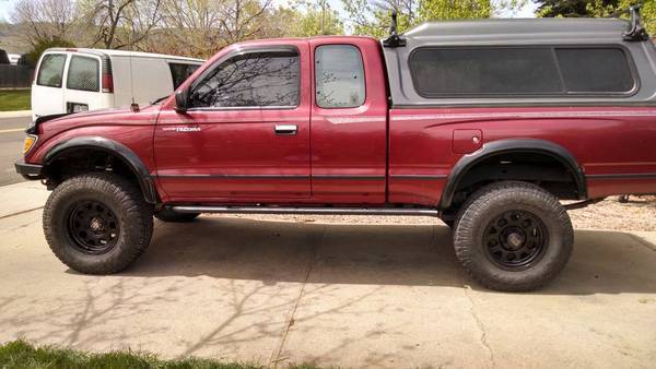

  13. Apr 25, 2014 at 3:50 PM
    #193
    Deathbysnusnu
    Deathbysnusnu [OP] Work is just a daily detour to happy hour.
    Oct 4, 2013
    #113825
    17,236
    Brett
    Fort Crawlins, CO
    Vintage Tundra
    Dog, camper.

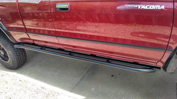

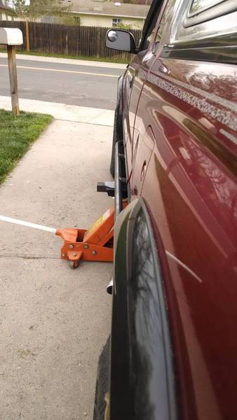

    Just a dry fit today :D
    I'll put a bit more angle on 'em when their mounted.
    :D:dancingbacon:

    Honestly if it were me I'd leave them level. Will help protect the body more. Have fun cleaning the frame rails off. Took forever to get the undercoating crap off.

    Yeah, but a slight angle looks sporty :cool: I know what you're saying though.
    I got flap disc's, and wire brushes attached to 4 1/2" angle grinders, so hopefully cleaning the surface won't be all that bad.

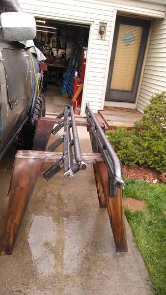

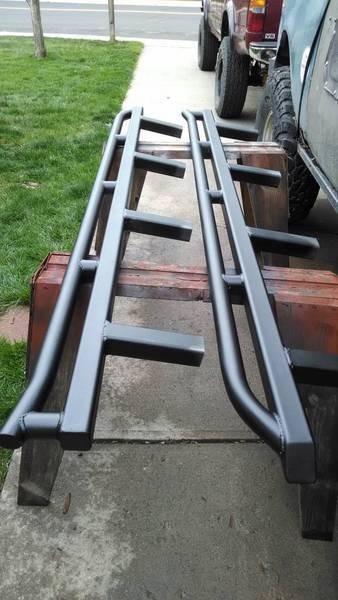

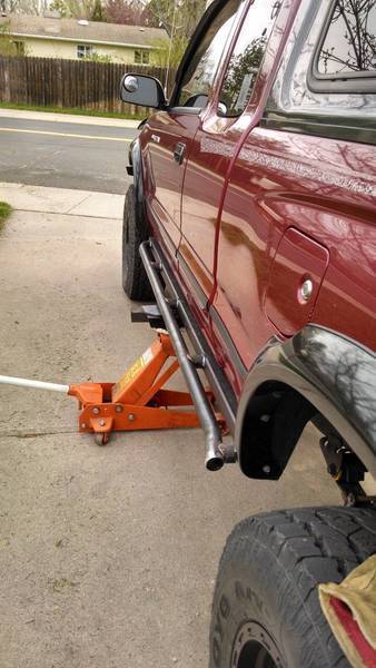

    This will be a slow process as time and the weather are not on my side.
    Welded the legs on today.
    Washed them with degreaser.
    And a coat of Harbor Freight bed liner
    Maybe later this week or next weekend for the install as I need another set of hands.:rolleyes:

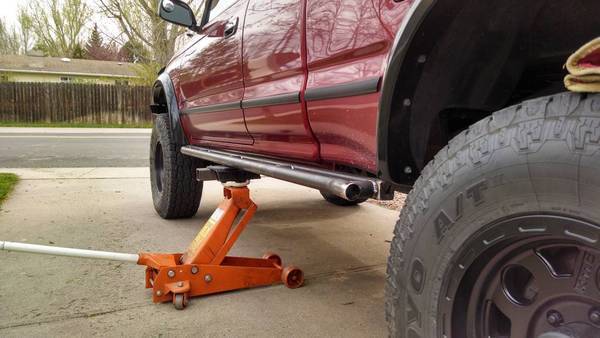

  17. May 4, 2014 at 7:42 PM
    #197
    Deathbysnusnu
    Oct 4, 2013
    #113825
    17,236
    Brett
    Fort Crawlins, CO
    Vintage Tundra
    Dog, camper.

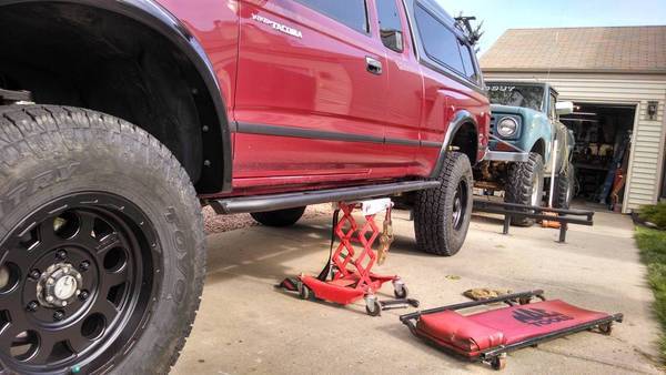

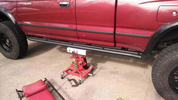

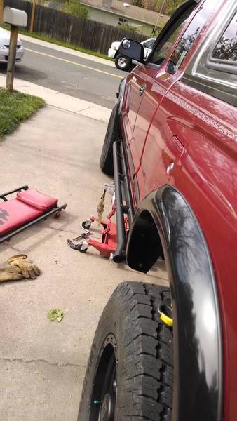

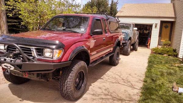

    Today was the day!
    After screwing around with a floor jack, 2x4's, jackstands and a mild hangover, I remembered my transmission jack that was hidden behind the shop bench. If you have access to something like, I highly recommend using it.

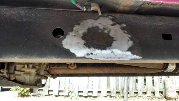

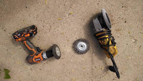

    A selection of destructive tools for removing undercoating.
    Turns out this little $2.00 abrasive disk from HF worked great.
    Cadmus likes this.

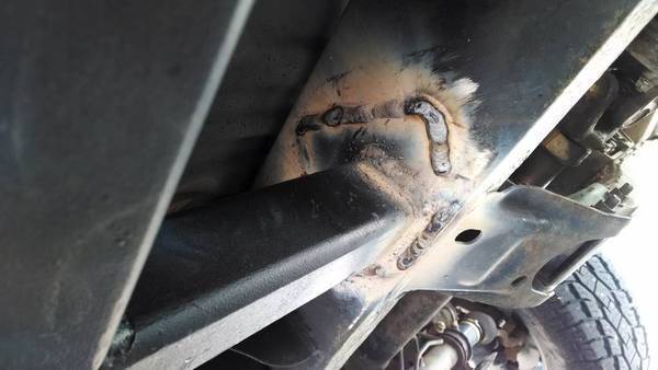

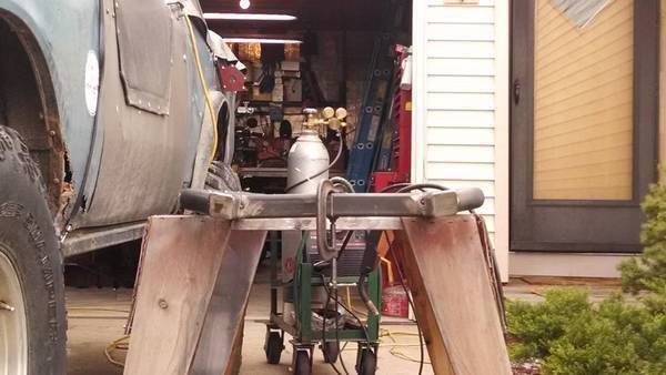

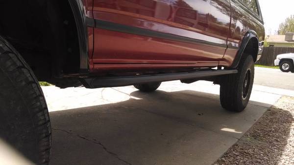

    Naturally I forgot to take pics of the clamping process, just used C clamps to hold in place.
    I used flux core wire because it's what I had. This is a flux weld before it's clean.
    Of course I didn't take any pics of a clean weld but trust me they look fine.:spy:

    Next up is a rear locker and bumper. Undecided on what brand/design for either at this time.
