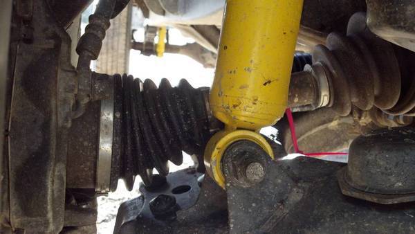

    Pic of the cv angles with the diff drop installed

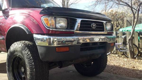

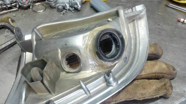

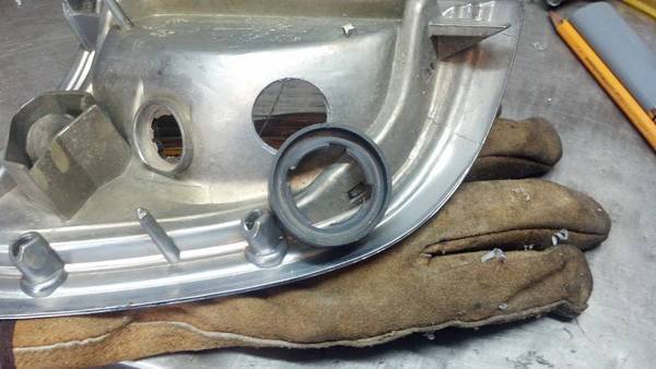

    Next mod was to prepare for a new front bumper.
    Toyota thought it was cool to put the turn signals at the very bottom of the bumper. I was bummin' about that cause most of the bumpers I liked either didn't have a provision for signal relocation or I wasn't happy with how it looked.

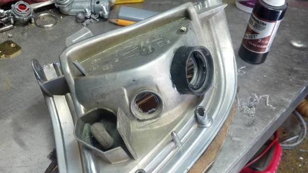

    Then I found this thread from Blackdawg.
    http://www.tacomaworld.com/forum/1st-gen-tacomas/186115-free-blinker-light-relocation-mod.html
    So I went for it. Easy mod, no reason not to do it.
    I won't go into detail as the link does a great job of that, I will provide pics of what I did.
    Drilled an 1 1/8" hole in the location shown, I used a stepbit.
    The plastic ring is what I cut of the blinker housing from down below.
    Used some CA glue to give the mounting ring a quick hold in place
    And some Liquid Nails to seal it up and hold it in place.
    Had to install amber bulbs as mine were clear. Works great, highly visible compared to the stock location. Looks a bit cleaner.

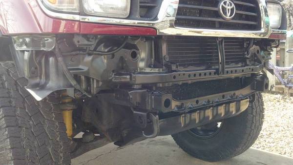

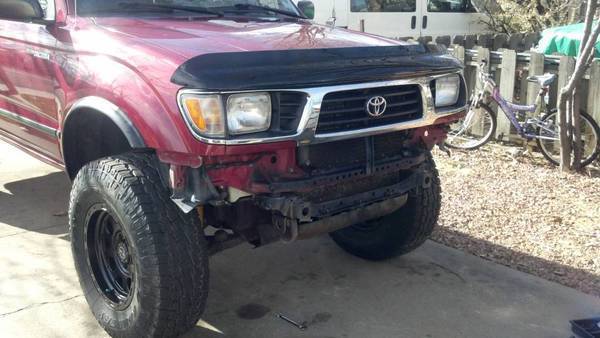

    Next in preparation for the new bumper I removed the stock tin.
    Before
    After. Not too pretty.
    And painted the stuff behind it. I used Rustoleum Hammered finish in black because I had a can on the shelf. Otherwise I would have used black.

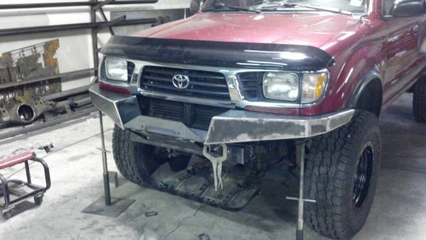

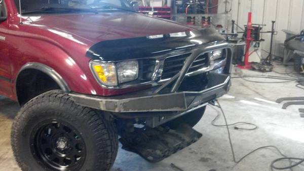

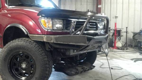

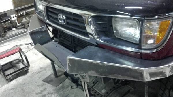

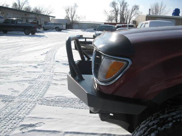

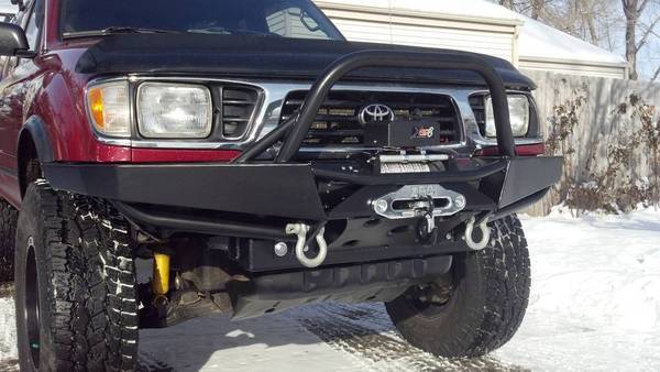

    Teaser pics. This is all so far, they are waiting for a project file so they can cut the new plates. You may notice the plate gap towards the center, this is what is being re-done and the current holdup on the project. 96 Taco's have a flatter front end, this was actually forseen before the install started but was unknown at that time just how big the gap would be
    One more. The gap is not that bad imo, I would have lived with it. Scotty however wants to fine tune it and get a tighter fit and I'm perfectly fine with that. :)
    So currently waiting patiently in the middle of a Siberian deep freeze with lots of fresh snow and a newly purchased winch on the garage bench.:cool: (worth the wait!)

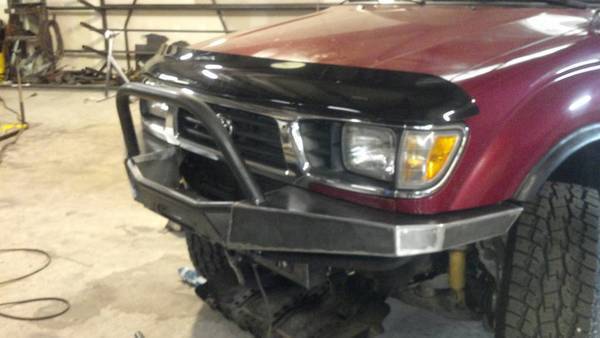

    Update:
    Bumper is coming along nicely!
    Ready for the gussets...
    Final pieces installed...
    One more shot...Ready for final welds and a coat of paint :)
    Apologies for the blurry pics, my droid has been around the block and should be upgraded but that takes money away from the Taco fund...

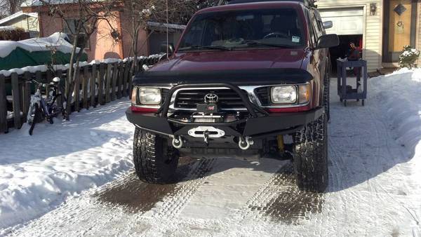

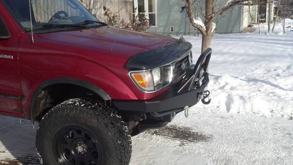

    Update: Bumper complete. :D
    Pics stolen from Addicted Off Road facebook page as he has a better camera.
    Thanks Scotty! Looks great!
    Winch install to follow.

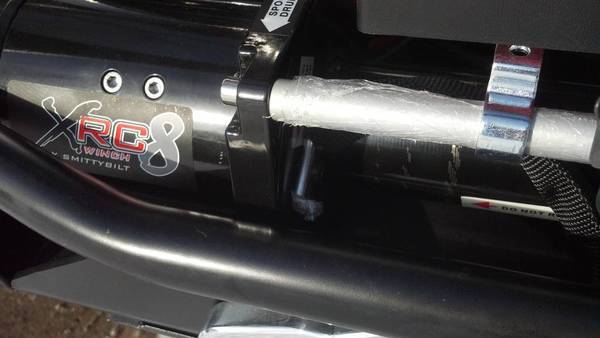

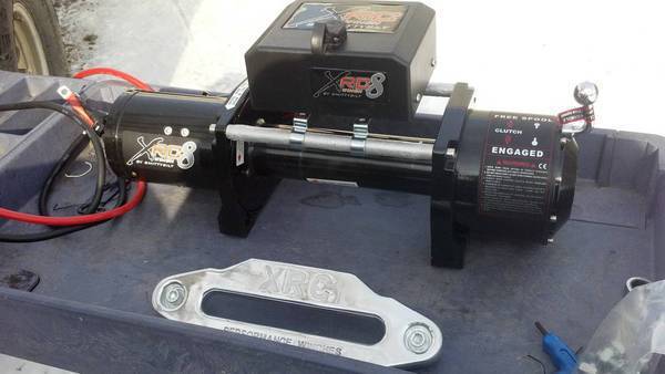

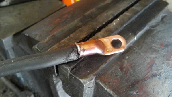

    Winch install

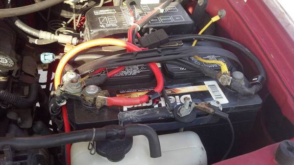

    Added another item on the "to do" list, need to clean this mess up and add second battery...
    Attaching synthetic line
    Done deal.

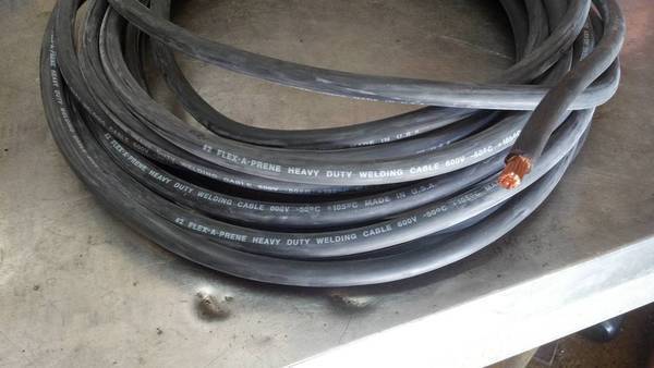

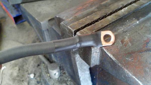

    Not too happy with the control box on top, I want to install it under the hood and run a 3 way toggle inside the cab and move the plug assembly for the handheld control to the front in an obscure location.
    It was around -2 degrees outside when I installed this so this will have to do for now.

    #17
    AddictedOffroad
    AddictedOffroad Well-Known Member
    Jan 29, 2011
    #50143
    316
    Windsor, CO
    2000 4runner. Linked and locked
    70 lbs. same as our tube bumper
  18. Dec 8, 2013 at 5:31 PM
    #18
    Deathbysnusnu
    Deathbysnusnu [OP] Work is just a daily detour to happy hour.
    Oct 4, 2013
    #113825
    13,126
    Brett
    Fort Crawlins, CO
    96 Xtra cab, 3.4, OME/Dakar, and it's red.
    882, Dakar, Detroit, 4.88, Warn 9K, Wet Okole, Dog Hair. Addicted Off Road front bumper and sliders. Rucas Built rear bumper 120' synthetic rope, Ultragauge, sway-bar delete,
    Bumper and winch with synthetic line is around 130lbs.

    In preparation for re-locating the winch control box, I found some 2ga welders cable (30') and spent some time soldering lugs to the ends. It's still too damn cold outside to start this project but it may warm up in the next few days.
    more to follow as the weather permits...
    Update:12/20/13
    After buying 2ga cable, the copper ends and all that is needed to relocate the control box, I decided that it really is a fools errand and I'll explain why...
    There are 5 heavy cables associated with the winch. Two for the battery and three for the control box to winch connection. Moving the control box under hood would have left me with 4-2ga cables running from under hood to bumper, the three for the control box and the ground cable. The positive cable goes direct to control box.
    This would have been a pain in the ass if I have to remove the bumper for whatever reason, I would have to disconnect 4 cables and thread them thru.
    Not to mention the wiring needed to relocate the hand control to the front bumper. Not difficult to accomplish, but in the end not really necessary. Currently there is only the positive and negative cable to deal with.
    I would still like to have a three way toggle inside to operate the winch from the driver seat. Easy to accomplish, I just need to decide where i want the switch mounted.
    So I apologize if any were anticipating this project, I have decided to put it on indefinite hold for the time being.
