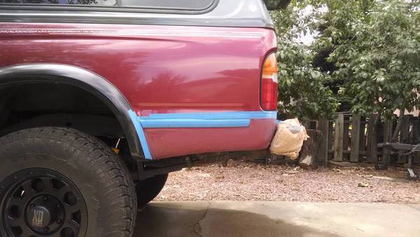

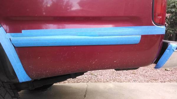

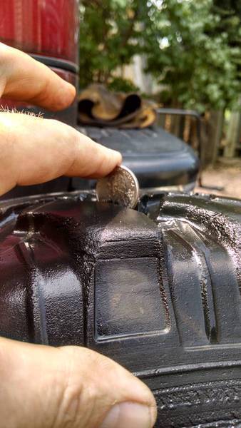

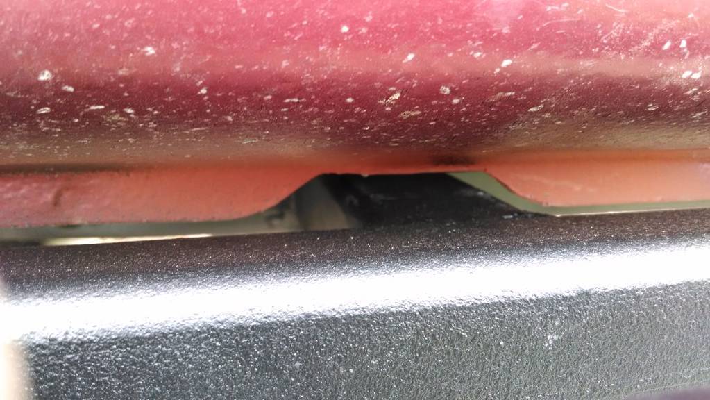

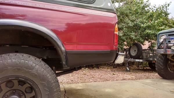

    Started on covering the rock chips on the rocker panels. Just did the back of the bed for today to see how it was gonna look.
    Taped
    Lightly sanded to break what was left of the clear coat
    Sprayed with bed liner
    I'm thinking I need to redo the flares the same and maybe go ahead and cover the rubber strip too...what do you guys think?

    Mall shopping cart protector.
    I used Harbor Freight spray on bed liner. It's on my sliders and bumper too but not long enough to say anything about fading. I've stepped all over it though on the sliders and it hasn't scuffed or peeled.

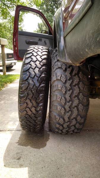

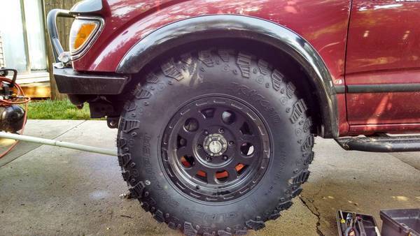

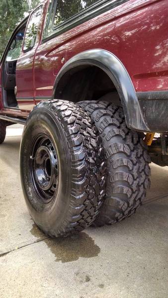

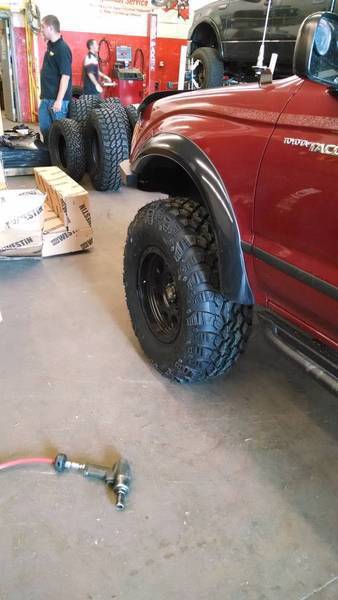

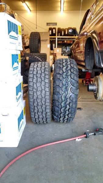

    Sitting on the floor, fresh off the truck. Me tapping my foot and pacing behind the camera
    265 vs 285

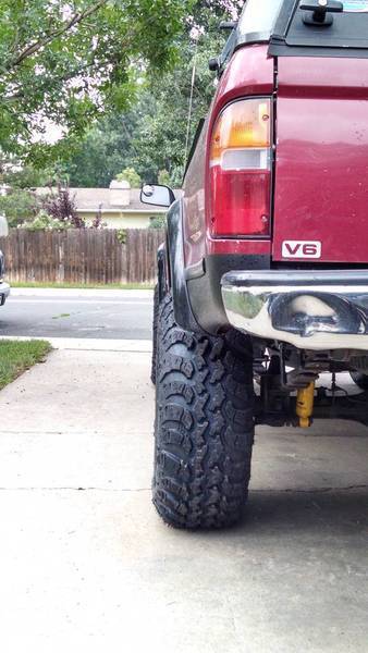

    Test fitting the front. Just wanted to make sure I could get home. I've actually got quite a bit of room at ride height. I'll pull the front struts this weekend and cycle them to see what needs trimmed.
    Right after I got home last night
    I don't think their too wide at all, looks perfect to me. :D
    So much rubber.
    This is exactly what I wanted.
    For $151 and some change per tire, I don't see how they could possibly be wrong. Yes, they will wear fast compared to others. But the quick wear is also what makes them excel in the rocks, dirt, mud, snow.

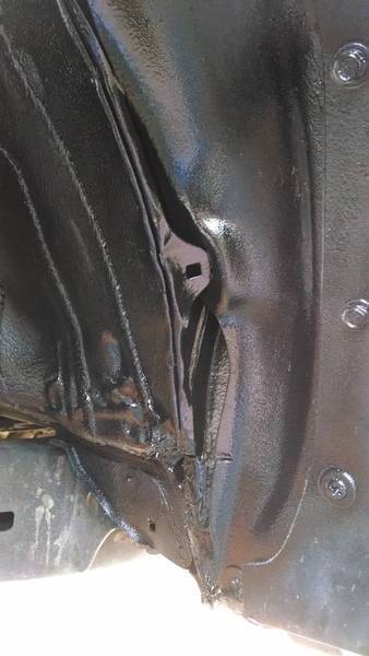

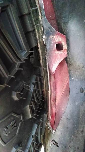

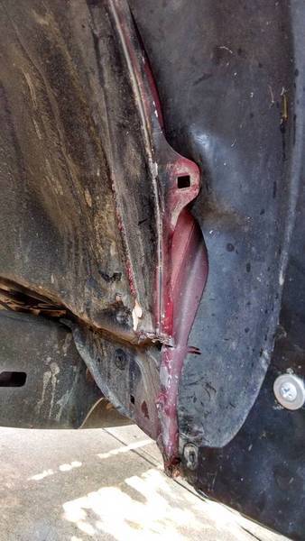

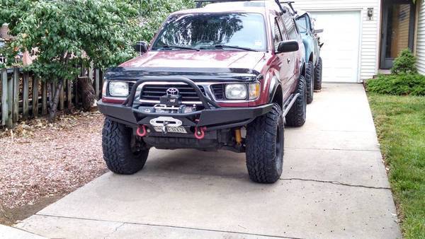

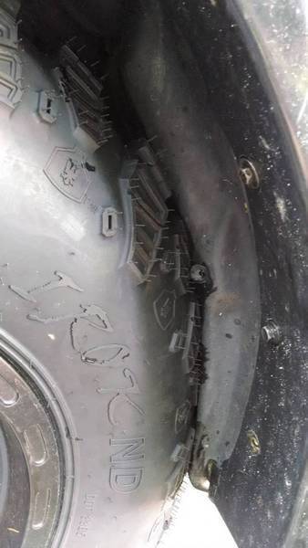

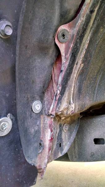

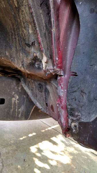

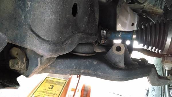

    Stuffed the front today
    By removing the front shock/coil
    Found the rub
    Cut some stuff out, prolly could have been neater with it...:eek:
    Beat some stuff back
    Clearance is close but should work, I rarely get full stuff anyway
    Replaced a hex head bolt with a flat head screw, sprayed some bedliner on it.
    Did the passenger side too

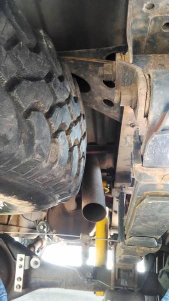

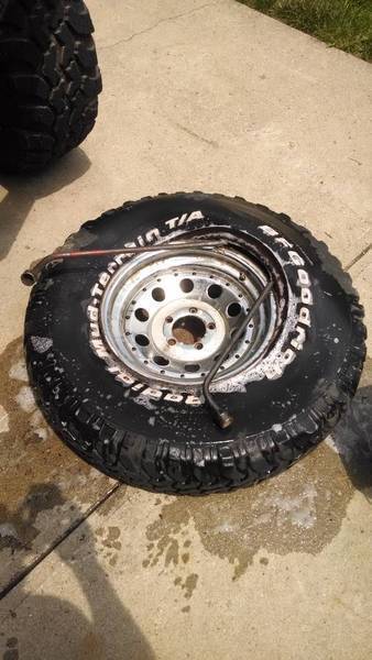

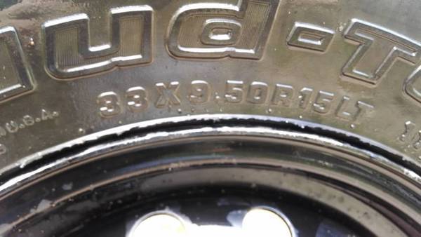

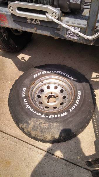

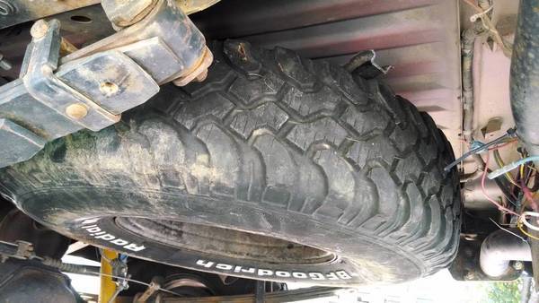

    :D Too bad BFG don't make these anymore.

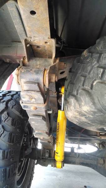

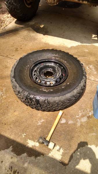

    You made me go look again... :p Springs have plenty of clearance, the rear diff does look close, but only if it's fully compressed both sides will it have a chance of contact..I suppose it's possible. If it hits, it will fit in the bed like you did and it's light enough to move around easy.

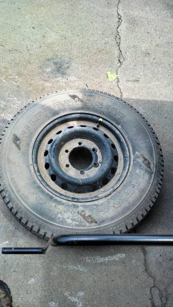

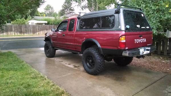

    I did have to cut off the ends of the whatchamacallit basket thing and then kind of nudged the tire into place as I tightened it down.
  19. Jul 26, 2014 at 2:51 PM
    #219
    Deathbysnusnu
    Deathbysnusnu [OP] Work is just a daily detour to happy hour.
    Oct 4, 2013
    #113825
    17,236
    Brett
    Fort Crawlins, CO
    Vintage Tundra
    Dog, camper.
    Seems pretty snug, I'll make a trip to sonic in a bit and see how it does.
  20. Jul 26, 2014 at 2:53 PM
    #220
    Deathbysnusnu
    Oct 4, 2013
    #113825
    17,236
    Brett
    Fort Crawlins, CO
    Vintage Tundra
    Dog, camper.
    It does move a little, it wiggles. I may remove those flimsy arms altogether and tighten it up to the crossmember..
