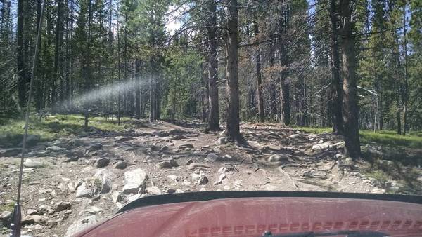

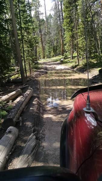

    So Saturday I went up Green Ridge a bit to try out the new rubber.
    The entrance, it's deep, see video a page or two back.
    Starts like this
    some of this
    Lots of puddles, use caution, they do not have smooth bottoms, slow speeds are highly recommended. Some are as deep as the entrance.
    This one is muddy, most are somewhat "clean"

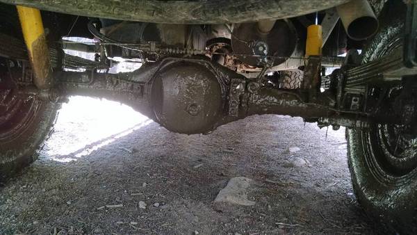

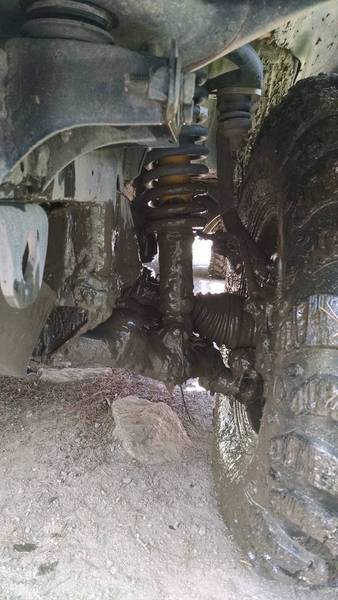

    Not really deep, but I'm pretty sure it was responsibly for my pinion seal leaking, Maybe.

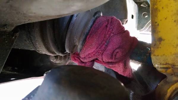

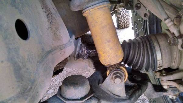

    Finally tore one boot, new shafts will be here tomorrow morning, I don't feel like messing with a re-boot. Notice how clean they are now, pic was taken in the parking lot while airing up. Lots of deep water on this trail.

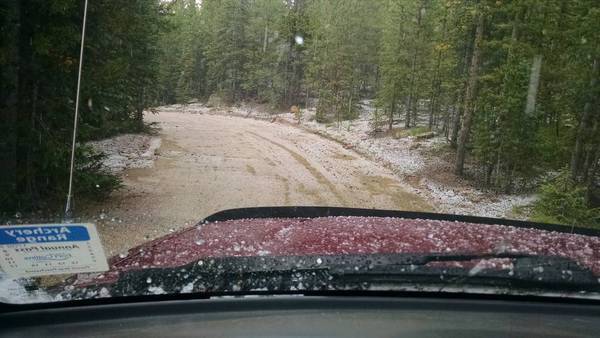

    Got some hail.
    There, it's fixed.:cool:
    It actually held just like that all day Sunday..

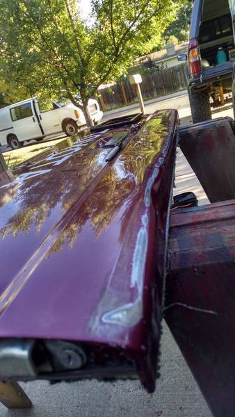

    Today I finished lining the rocker panels. I also removed and sprayed the flairs with the same stuff. Harbor Freight spray bedliner. Has a smoother texture than most I've seen and has held up well to foot traffic on the sliders. I'll have to wait and see how bad it fades, peels or flakes over time.

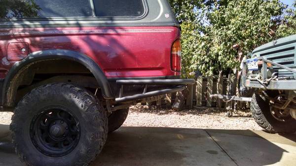

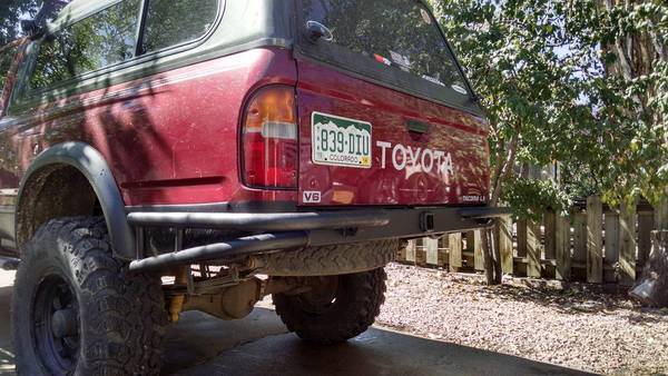

    Rucas Built :cool:
    I'll deal with the plate in a minute, just temporary to get around town..
    Fit was great, really didn't take long to install, was more work to remove the old one. This was actually a bit lighter on the back scale than the stock one plus the receiver mount.
    I'll get some better pics this weekend, ran out of light again...:rolleyes:

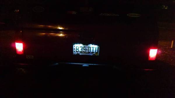

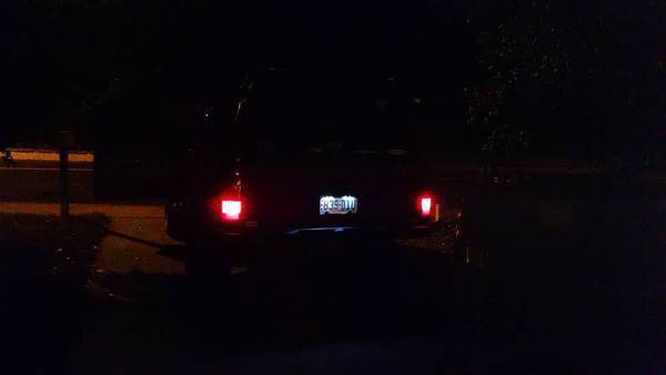

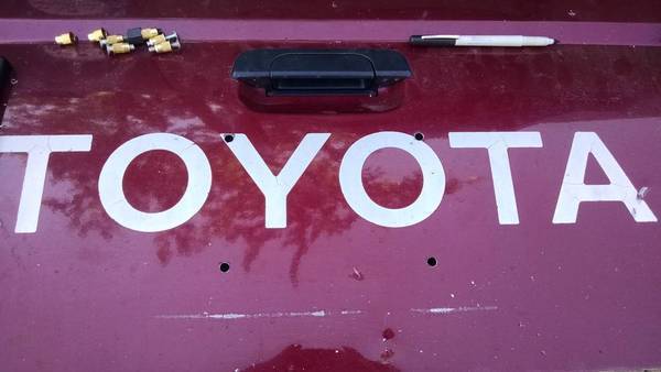

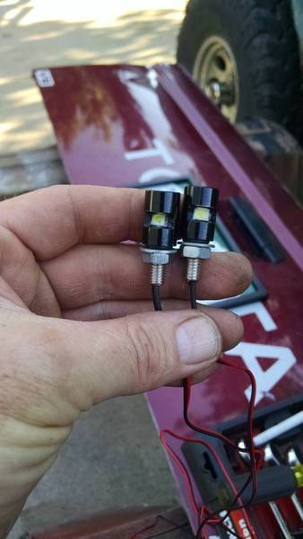

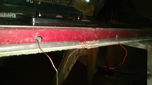

    So the license plate needed a home and it's own night light. I had thought about frenching it in.... but after consideration of my highly abused tail gate I decided on a simpler route.
    Killed me to drill holes in it. And later removed the lettering :(

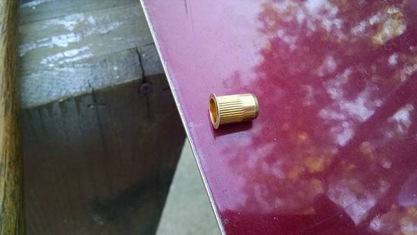

    1/4"x 20 nut inserts were used to hold everything on, sheet metal just doesn't have what it takes to hold a thread.
    The two top screws were replaced with these nifty LED units that Rucas had for me. They had a metric thread, so being the redneck I am, I re-threaded them 1/4"x 20 so they could be used a little easier. I was originally going to mount them on their own but thought this would be cleaner.
    Then a friend came over for dinner and delayed me a bit.
    I removed the lettering after they left with a heat gun, hand rubbed the shit out of it with rubbing compound then gave it a coat of wax. No pics naturally. I'll get it tomorrow.
    So here's the wires as I pulled them through the bottom. this was just a staging for the wiring, the are now tucked all inside and come out on one corner only through a smaller hole.
    Should keep me legal.

    Ya know, I bench tested them, and like you, was skeptical.
    They seem to do the job just fine, lights up the ground a wee bit too.
    The plate being somewhat reflective helps too I think. ;)
