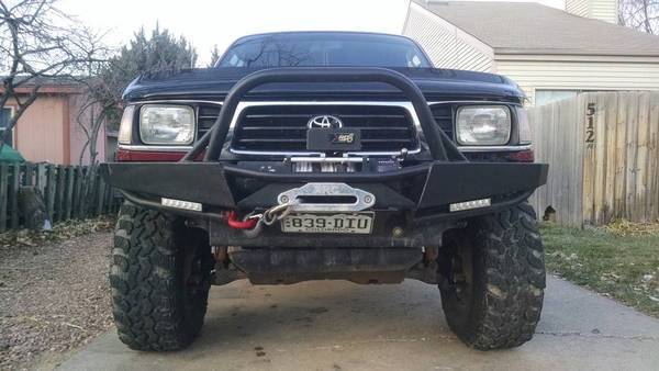

    Wired and mounted. Night pics to follow...
  5. Dec 6, 2014 at 6:54 PM
    #285
    Deathbysnusnu
    Deathbysnusnu [OP] Work is just a daily detour to happy hour.
    Oct 4, 2013
    #113825
    17,236
    Brett
    Fort Crawlins, CO
    Vintage Tundra
    Dog, camper.

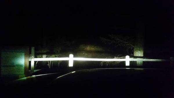

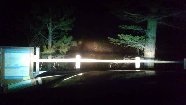

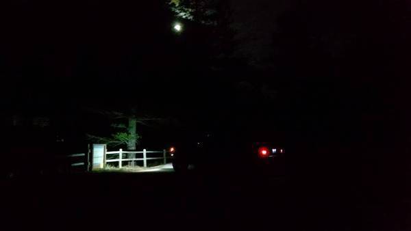

    dims
    dims with lite bars
    brights with lite bars
    brights only
    broke :mad:
    now I know what I'm doing with the third one....:rolleyes:

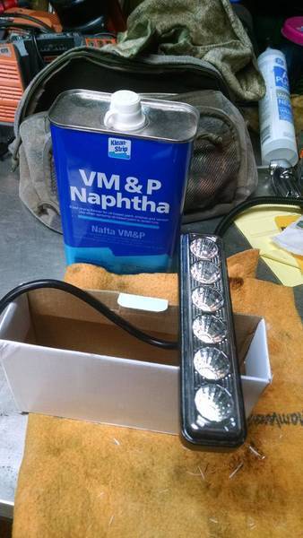

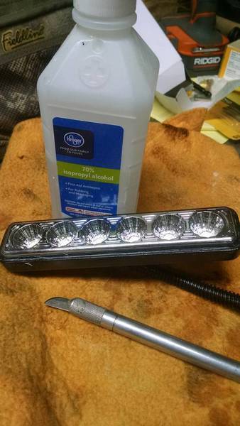

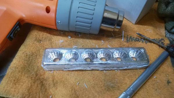

    So I took the light apart today.
    Started with alcohol, rubbing :rolleyes:
    and a hobby knife for cutting.
    this was a slow process.
    Decided to try something with more kick.
  8. Dec 7, 2014 at 3:22 PM
    #288
    Deathbysnusnu
    Oct 4, 2013
    #113825
    17,236
    Brett
    Fort Crawlins, CO
    Vintage Tundra
    Dog, camper.

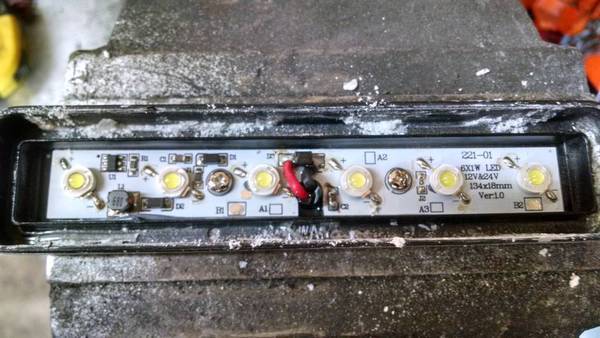

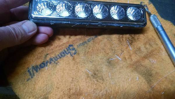

    Chemical warfare wasn't working so I got the heat gun out and that did the trick. I was able to get the blade in there and cut through it after it was hot. it pried out fairly easy after that.
    The inside.
  9. Dec 7, 2014 at 3:32 PM
    #289
    Deathbysnusnu
    Oct 4, 2013
    #113825
    17,236
    Brett
    Fort Crawlins, CO
    Vintage Tundra
    Dog, camper.

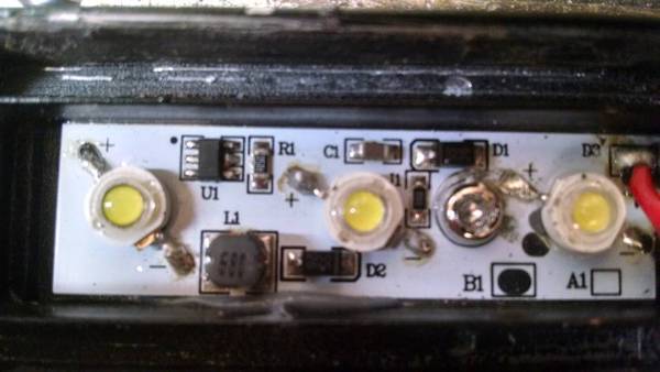

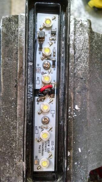

    I cleaned it up.

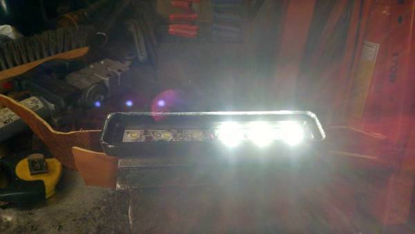

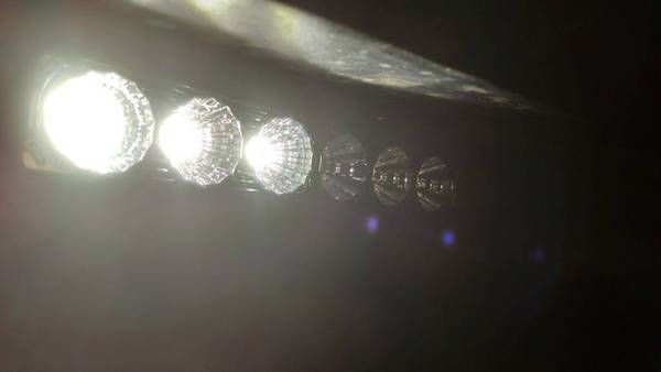

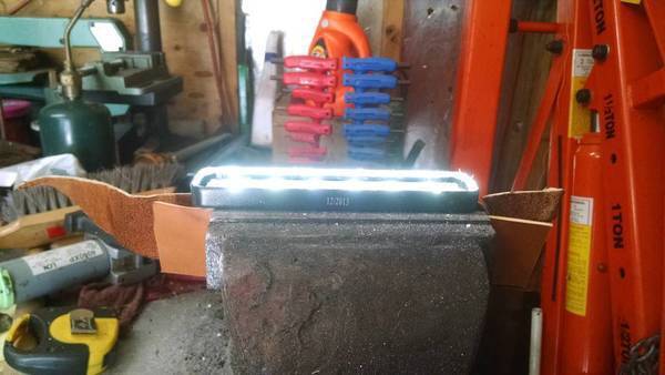

    And proceeded to diagnose. What I did was heat up a soldering iron, plug in the light and re-heat each joint, hoping something would happen.
    It worked:D The center LED on the + joint needed a bit more flow or something, after it melted, the light came on.
    You can see I started on the right and moved left, the far left LED is untouched.
    :cool:

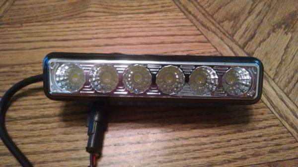

    And after all that, I put the lens back on, tested it a few times and was satisfied.
    put it back on the truck and it quit altogether.:(
    Bench testing again, no glow. Put the spare on the truck, no problem. Must have just been a lemon period. The LED's appear ok, I think it's a bad fet or maybe a poor etching on the board. Either way it's fubar.
