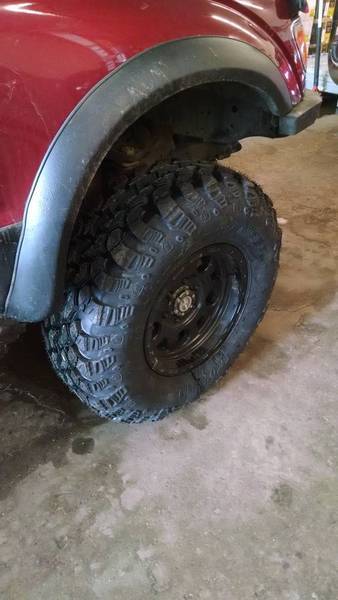

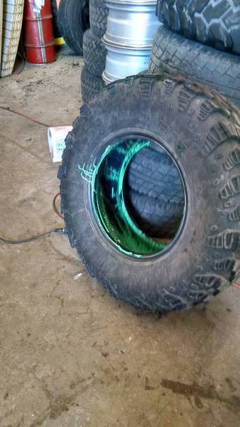

    Not much going on here lately, replaced a tire that had sidewall damage.
    Just a slight pinch in the sidewall and it was losing air daily and after airing it up everyday for the last 3 weeks I decided to do something about it.
    Somebody put that green slime crap in it.:anonymous:
    Tire guy said Fix-a-Flat is better.:p
    A bit of wear.

    Nice shoe :p when are you getting the others to match..... jk

    :goingcrazy:
    I'm sure it will wear in quick. ;)

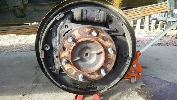

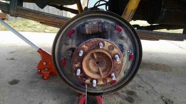

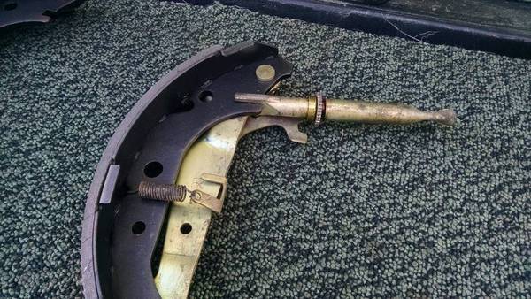

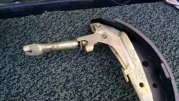

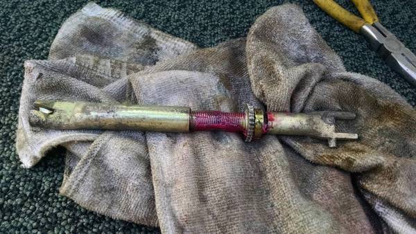

    Replaced rear brakes today.
    Started like this.
    Took all that crap off, skipped the pics because I forgot.
    remembered about this stage .

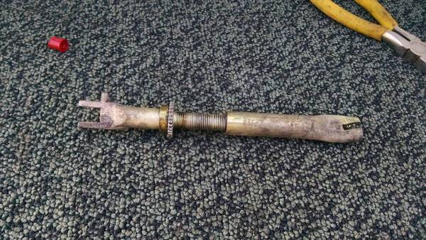

    Self adjuster. slightly cleaned up.
    Lubed, threads and the end that spins.

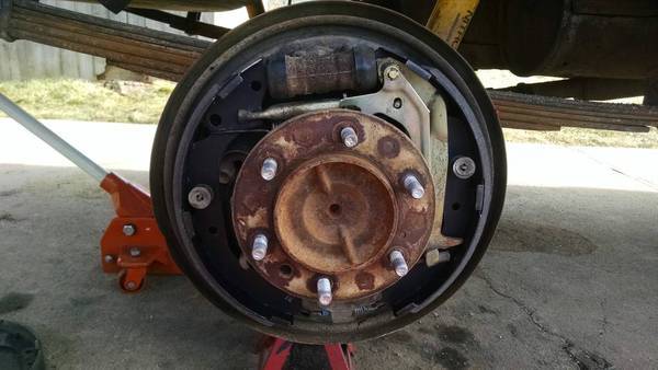

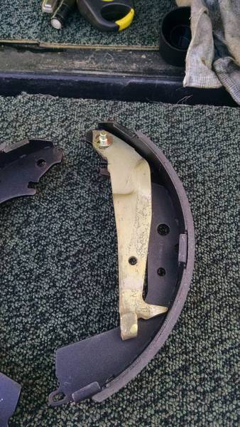

    E-brake lever installed
    Adjuster mechanism.

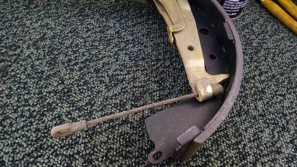

    Don't forget this cable for the parking brake, mush easier to do it now than after you have all the springs installed.
    Backing plate "cleaned":rolleyes: and greased.
    And completed. Looks just like the other side but reversed.

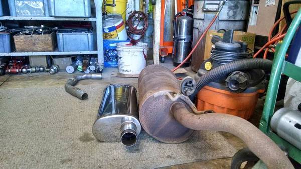

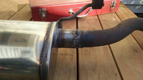

    New Magnaflow. Part # 14263
    You know the tail pipe end that everybody cuts off after a lift? Well the tip just happens to be a perfect fit inside the 2.5 :cool:
    And the stock pipe just happens to fit inside of that.
    "reducers" in place.

    Old can removed.
    I guess it wasn't that bad after all....:D:rolleyes:
    My shitty flux core welding, cause I just too lazy to buy a bottle of gas.
    I added some more hanger to what you see, I'll get a pic later.

    Nice fit.
    I angled the old pipe a bit more.
    Of course, I ran around the block first with no muffler right after removing it. I liked it a lot. :D
    But it did pop and backfire a bit and I'm already the neighborhood nuisance, so I finished the job.
    It idles almost exactly the same as far as tone and volume. Has a nice throaty growl when you step on it. Going for a drive.
