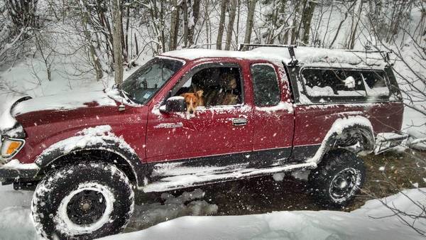

    Action shot.

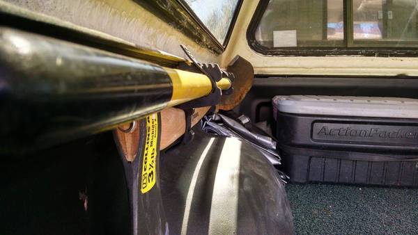

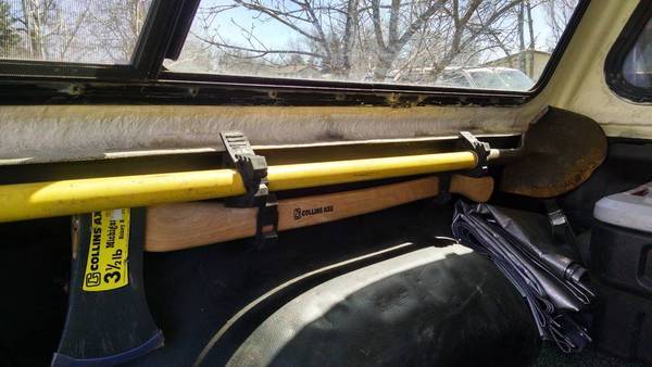

    Finally got around to ordering the Quick Fist knuckle busters, lol.
    Pretty cool little hold downs.:cool:
    I also ordered the big ones for strapping down scuba tanks. :spy:

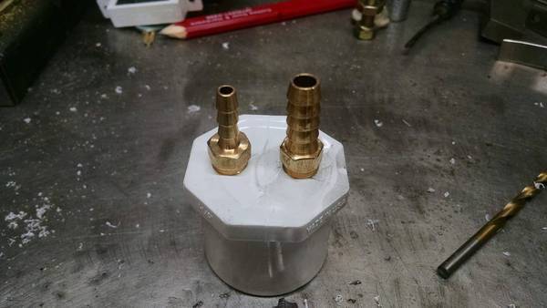

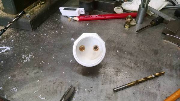

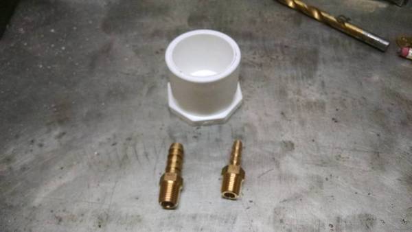

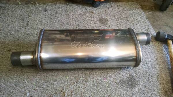

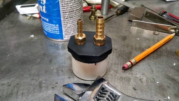

    Resonator delete. In did this awhile back and ended up putting it back on.
    After seeing some pics of another's ingenuity, I decided to give it another shot.

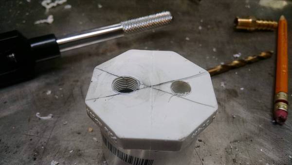

    A trip to ACE netted me these pieces of hardware.
    The PVC cap is 1 5/8" OD.\
    The nipples are 5/16 and 3/16 with 1/8 tapered pipe threads.
    Measured in 1/2" to make sure they fit on the backside.

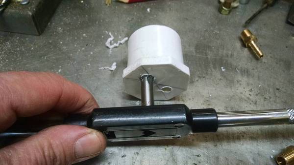

    drilled holes are 19/64". Pipe tap uses 5/16" hole but I wanted just a bit deeper thread. When using a pipe tap, you must run the tap all the way to the base of the threads or it won't work.
    One hole threaded and ready.
    Threaded and test fit.
    they ended up just past the inside edge so fully threaded and tight, not worried about air leaks, no need for ptfe tape or any kind of sealant.

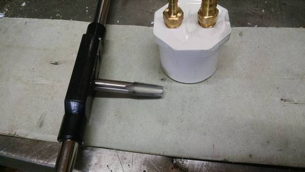

    1/8 pipe tap. You can see it is tapered. My tap and die kit had one in it but ACE carries these too.
  7. Apr 10, 2015 at 1:35 PM
    #327
    Deathbysnusnu
    Deathbysnusnu [OP] Work is just a daily detour to happy hour.
    Oct 4, 2013
    #113825
    17,127
    Brett
    Fort Crawlins, CO
    Vintage Tundra
    Dog, camper.

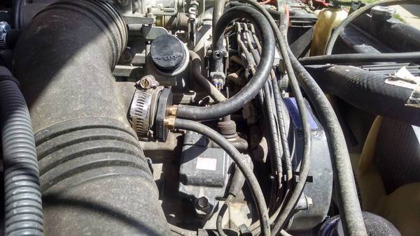

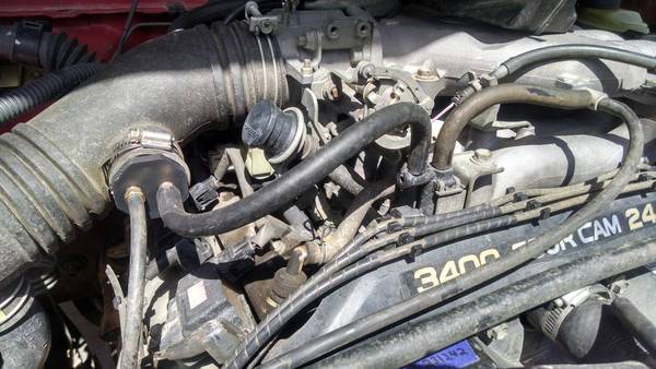

    Some paint to make it less noticeable. I would not paint the part that goes in the intake.
    And complete. You can see I have another vacuum line and a different setup altogether for the bigger line. They both ultimately run to the "T" on the upper right of the pic on the intake manifold. The smaller line runs to the power steering pump and back to the new cap in the intake. The bigger one runs through something that has wires and must be telling something what it needs than back to the new cap on the intake.
    Right after this pic I removed and cleaned the PCV valve and also replaced the vacuum line on it. Now to clean all that crud off since I can see it.
    Runs just fine and I really can't hear any more noise but I'm also old :p
    Really the only reason's to do this mod is
    A-out of boredom,
    B-it does give you a bit more room and makes it easier to keep things clean.
    Otherwise the original stuff works just fine.
    I didn't bother with the bottom "J" shaped unit as it really isn't in my way. But, the same size cap will fit in there if somebody really needs to get rid of it.
