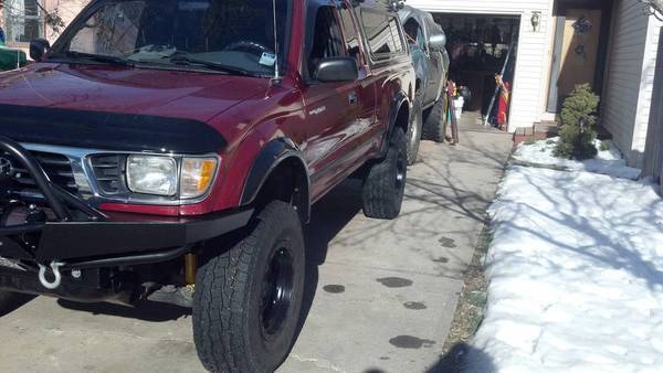

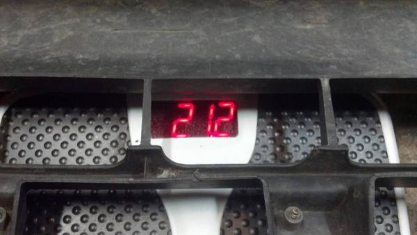

    Any idea what the stock stuff that comes off weighs? I'd like to figure out how much weight you are actually adding.
    The bumper looks very nice by the way! :thumbsup:

    Stock bumper was about 10 pounds, not too much there.

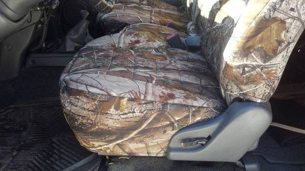

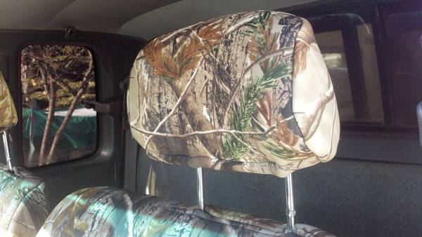

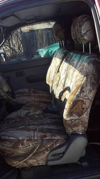

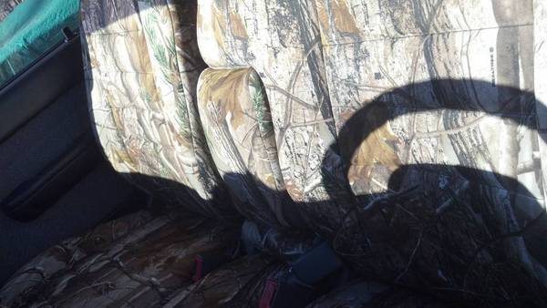

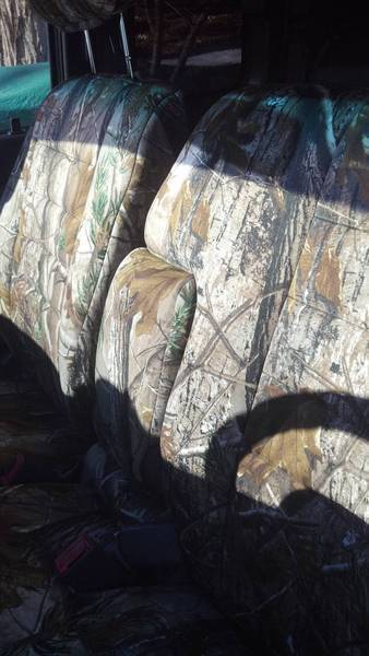

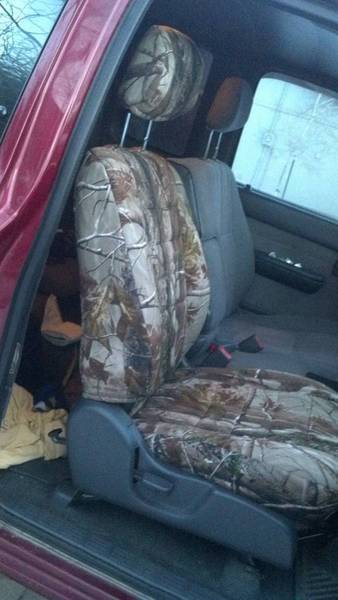

    Today I installed my Wet Okole seat covers.
    Nice tight fit and some added padding.

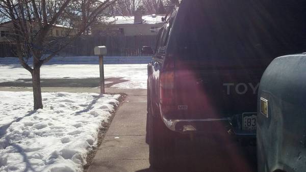

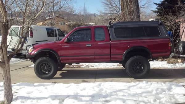

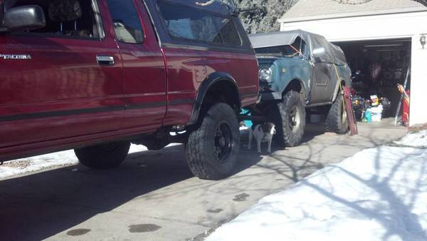

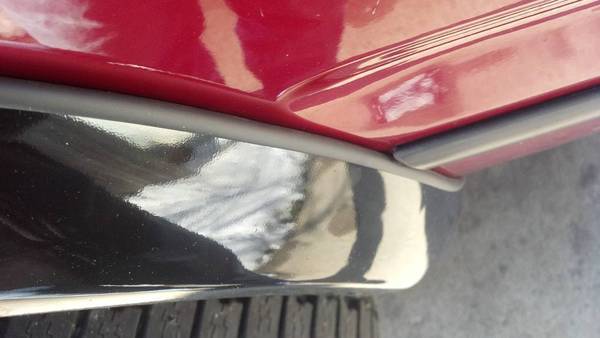

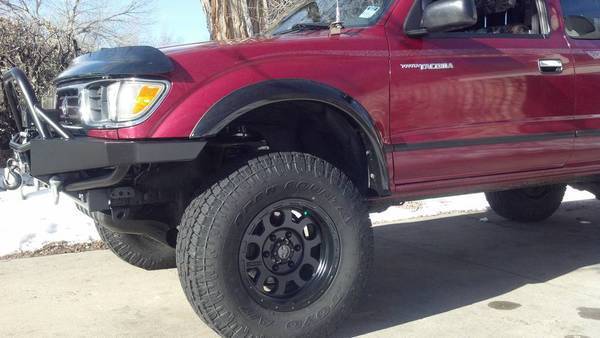

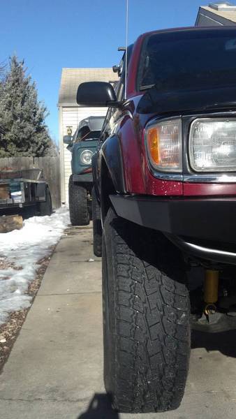

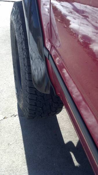

    Next I installed the Bushwacker flares.
    I decided to paint them, Krylon infusion satin and a couple coats of clear. they came out more glossy then I wanted but I figured they'll scratch up pretty quick at which point I'll most likely bed line them.
    These are the Extend-A-Fender 1 1/2" flair
    I think they look way better than the rubber pos I had on before
    Sunglare shot
    Rear fit
    Front
    The only fitment issues I had was one bolt hole did not line up on the passenger rear. This quarter panel has a slight parking lot dent so that may have been the reason why. The rest lined up fairly well, I had to push hard to get them to line up so the screws would go in. They are much tougher then they appear out of the box, I thought for sure I was gonna break them pushing them on. We'll see how they do over time.

    But there is the crush panel and skid plate mount too. Its actually closer to 40lbs total.

    I thought that 10 pounds sounded kinda light. ;)

    I can't speak for the newer models, but my stock bumper is about ten pounds. :)
    The skidplate mount is just stamped sheetmetal, and it weigh's less then a value meal. I removed the bumper before hand, Scotty and his guys gave me all the parts they removed, skid mount, assorted bolts and factory tow hook. There is nothing else.
    I have both here, I'll take a pic on a scale. At most I'll give it 20 pounds, but no where near 40.

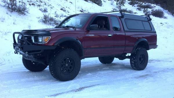

    MPG update.
    The following is with the bumper and winch installed.
    during the deep freeze that most of us got to enjoy I averaged about 15 mpg. Truck idled a lot during that time to stay warm and I was pretty heavy on the gas pedal as the truck is like a new toy now. Pretty much all driving was around town that week
    During this last week I ran to the top of Cameron Pass twice, once with hubs locked and once unlocked. Outside temps in the 40's
    Locked hubs mpg was 20.7 mpg
    Unlocked was 21.2 mpg
    Average posted speed is around 45 on that road and around 140 miles total round trip.

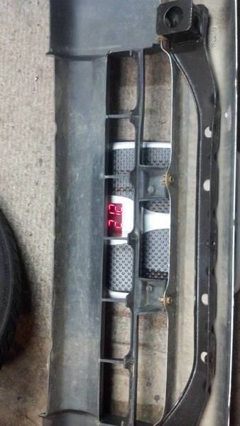

    21.2 on the scale. I did not include the bolts and tow hook, they may actually take it up to 25-28lbs. So a little closer to 40 then I thought, but this is what my old bumper and skid mount/crush weighs.

    Later models were heavier. 3rd gen 4runner ones were 40-45lbs when I weighed them.

    That's what I was thinking too, must be longer, heavier brackets used due to the shortened front frame that gives the extra weight. Or maybe just a heavier bumper overall. Either way even at 40lbs the things are not much protection in a collision.

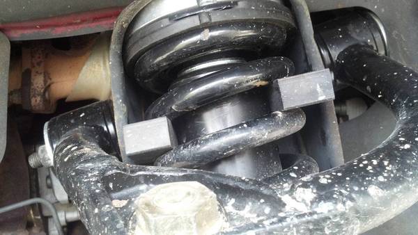

    I wonder if I will need the 1/2" top spacer with the 883's, or no spacer or maybe a thinner spacer...
    Right off I plan on throwing the 883's and the top spacer back in to see how it sits. I'll adjust from there.

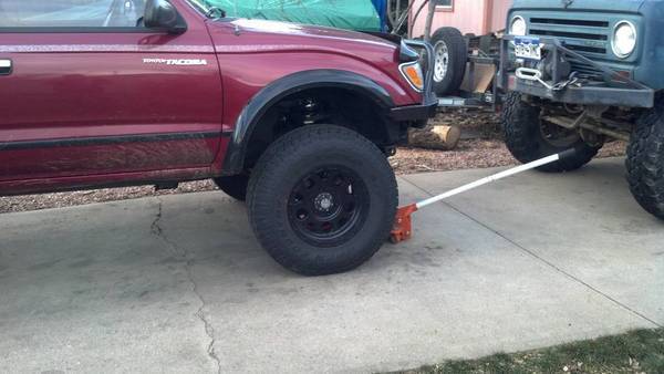

    In this pic, I have shoved a couple blocks of hard rubber between the coils, a big no-no, but I wanted to see what a small preload would do to the height. They give it back about a 1/2"
    I also have about 250lbs of weight in the back to pull it down so it looked "normal" again. Actually looks pretty good and i keep second guessing myself on the need for 883's...
    But I know when the rubber blocks are removed the front end drops another 1/2" and overall I lost about an inch with the bumper/winch combo. When the weight is removed from the rear it comes up close to an inch, so I'm left with a pretty nasty rake. Unfortunately I have no pics of that, but I can supply pics of my redneck coil spacers if needed.

    In preparation for changing of the coils, I removed the 881's and shocks and put the stock stuff back just for the night cause I don't have jackstands tall enough to reach.
    thought you might like the pics.
    Before, jack in place but not lifting anything. 23 1/2" hub to fender with rubber blocks between the coils to help out.
    after the stockers are back on, about 21" hub to fender
    Nice rake dude
    I'll post up tomorrow if I get the 883's back on before I lose daylight.
    These are the rubber blocks I had inserted between coils. Some leftover stuff from work, they are about 5/8" thick and are extremely hard so they don't compress and gave a slight lift on their own.
    pic is with suspension at full droop.
