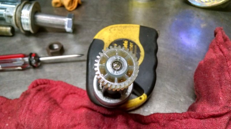

    My speed-o-meter being way off is also racking up miles that aren't necessarily being driven.
    So on the advice of Squeaky Penguin, I pulled my speed-o-meter drive assembly to verify my tooth count, has 30. Called the dealer and ordered a 32 tooth gear to see if that will get my speed-o-meter a little closer. I don't think it will be enough but that was the largest they said they could get. I'll find out in a couple days.

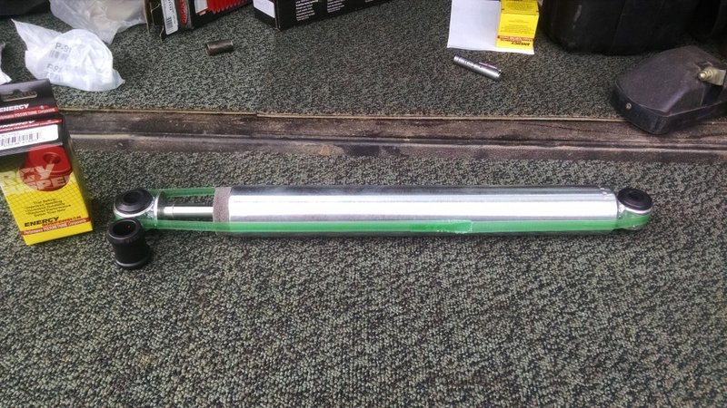

    Screwing around with shocks, round 3.
    No, they are not Bilsteins.
    Rancho RS7000. Specs and install soon. They are 26" extended length.

    A different set of bushings was available that fit the Tacoma stock mounts.
    How I pressed out the ones that came with it.
    One method for pressing in the new ones.
    This method works much better. A shot of WD-40 either way helps a lot.

    And some specs on them.
    Rancho part# RS7112 is what I bought.
    Extension
    OME-22 3/4"
    Rancho-26"
    Compression
    OME-14 1/4"
    Rancho-16 1/8"
    Travel
    OME-8 1/2"
    Rancho-10 1/8"
    The shaft size is somewhat smaller, but same dia. as any other Rancho shock I have ever run so I'm not concerned.
    The Yellow zip-tie was max up travel on the passenger side on the stock mounts.
    I removed the Grade 8 bolt mount I had made yesterday as I discovered the shock was bottoming out but never felt a hit, so I wanted to see how much random travel it had. I was close with what I had done but really needed a little more.
    So if this makes any sense...
    The up travel I had with the grade 8 bolt mounts I made and the OME shocks was
    Passenger side-2 1/4" and it was bottoming out but not hard.
    Driver side-3 1/2" and it came within 1/2" of bottoming out according to the tip tie.
    After removing the fruits of my labor and installing the Rancho shocks back in the stock locations I ended up with the following up travel.
    Passenger side-4 3/4"
    Driver side-4"
    Somewhat lopsided I know, the problem was I drilled the passenger side a bit too low, but no biggie, bolts are removed and holes are welded, moving forward..
