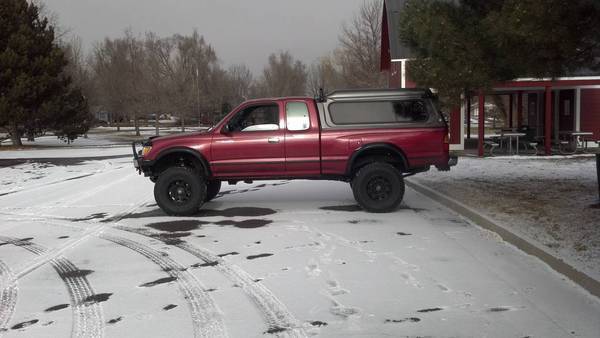

    Initial around the block impression: Stiffer then a honeymoon pecker!
    Ride height is at 25 3/4" hub to fender, a touch high perhaps...I'll pull the top spacer out and that should drop to 24 3/4" and give back a little rake.
    I hope they soften up, a little stiff for my liking at this point. I'll give a month or so before deciding to keep them or not.

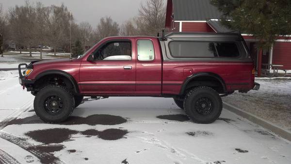

    Put about 25 miles on it last night just driving around, tagging speed bumps and aiming for the pot holes and the occasional corner curb. Urban wheeling:cool:
    Morning measurements are 25" hub to fender all four corners, so the front did settle after the initial install.
    The rear normally sits an inch higher but I have the winter weight in the back, couple hundred pounds plus.
    Still on the fence about the ride. For the most part on the city streets it rides great, good pavement feel, no front end lean or sway.
    Definitely stiffer though. But not stiffer then the rear suspension, about the same now. Biggest difference I noticed is simply hitting the railroad crossings at city speeds and it feels slightly more "jarring" in the front.
    I ordered a 1/4" poly top spacer last night to replace the 1/2" aluminum spacer. to lower the front just a bit and see if the poly makes a ride difference.

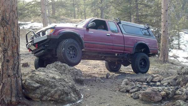

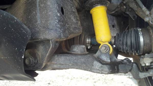

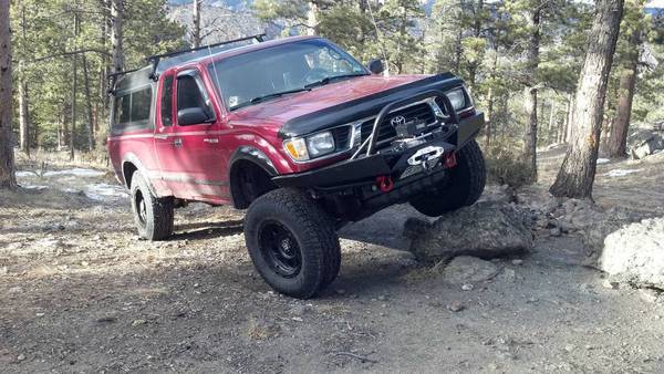

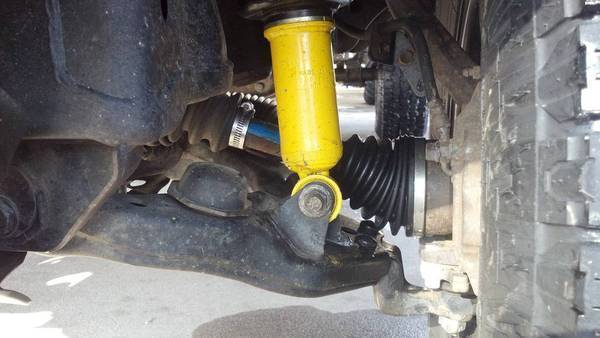

    Put another 100 miles on 'em and looked for a spot to check wheel travel.
    CV angle in driveway at current ride height.
    CV angle with struts as far compressed as I could get them...notice the bumpstop...
    Doing this.
    Not completely off the ground but awfully light

    So after running them down a dirt road with plenty of washboard action that I am used to with the prior setup I was surprised that they soaked it up fairly well.
    Running down my favorite paved canyon the extra stiffness was just like having the swaybar on, carved the turns with ease. Road manners are excellent.
    I still feel they may be too stiff in the end for trail use but I'll give them a chance and wait for the poly spacers to see if they have a psychosomatic effect at the very least.
    Running up a short trail felt ok but also felt like the struts were wanting to fully extend all the time rather than the higher tire soaking up the bump, the lower seemed to want to drop instead if that makes any sense. I ran a short trail I run all the time small game hunting so I'm very much in tune with the road and the vehicle.
    My setup just may not be heavy enough to properly work these coils.
    Stay tuned, there may be a set of 882's in the future. :rolleyes:

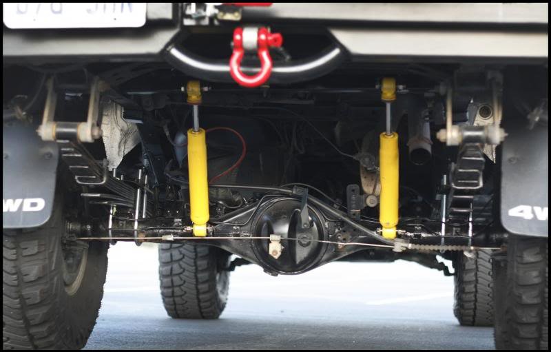

    Chances are that your rear travel is being limited by the rear shocks. The nitrochargers are a bit too short to allow full travel of the leaf springs. I like the nitrochargers so I just relocated my shock mounts to still use the shocks and not limit the travel of the rear springs. I gained 3-4" of extra suspension travel. You can see details in my build thread.

    I'm definitely being limited by the rear shock mounts, there's only 2-3 inches of down travel at best. I'll relocate those later. I've been very happy with the suspension as a whole. The 881's gave the ride I wanted and compressed nicely, they're just a bit overloaded for the extra weight that was added.

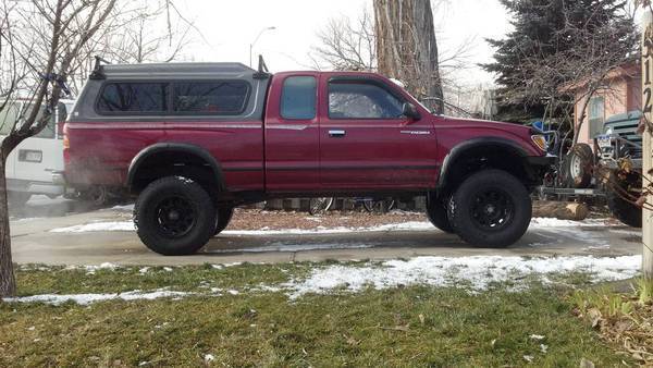

    So I installed the 1/4" poly spacers yesterday afternoon. No pics as there is not much of a visual change. They allowed the front to come down about a half inch which was expected. CV angle looks slightly better now. Short drive didn't really feel much change which was also expected. I'll go for a long drive today. Unfortunately all of our local trails are either closed for the winter are closed due to USFS politics so it's difficult to get a real world comparison. Best I can hope for is a washed out county road or travel the ditch.
    On a side note I also replaced the Tailgate cable supports. One was broke and the other was about to break. Pricey little cables at $22.00 each from Toyota but I knew they would fit as opposed to aftermarket.
    And an mpg report. Last tank running premium showed 19.87. This so far appears to be my average. When I get my front end squared away I'll run a few tanks of plain 'ol regular through it to see what happens.

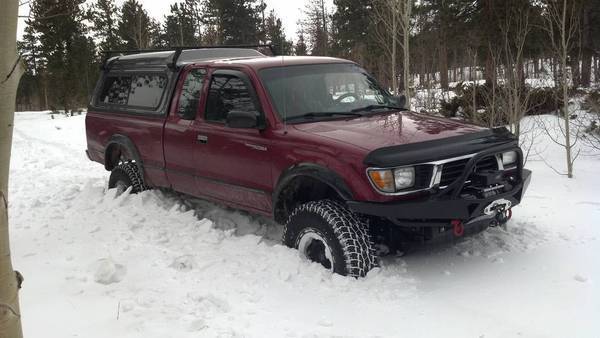

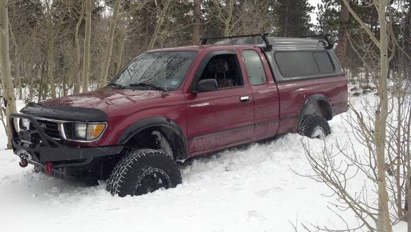

    Got it stuck in a dense snow drift.
    Was on top and broke through. Winch and bumper did their job and pulled it out.:cool:

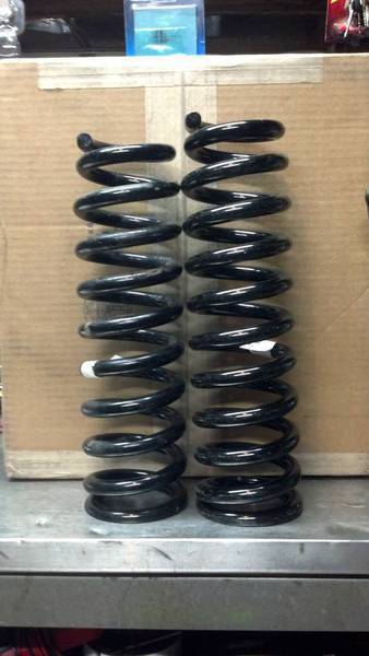

    882's showed up today. Too dark and cold to do anything about it.
    881 on the left for comparison.

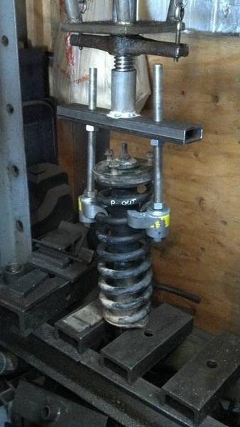

    I figured out how to use my press to remove the coils, should have thought of that before. Made an attachment for the ram that pushes the coils. I should have time tomorrow afternoon to do the swap. Looks sketchy as hell:eek: but it works and is stable. I practiced with a stock set.
    I have to admit the 883's feel pretty good now, I have grown used to them and probably could have left them as is, but I will try the 882's out of curiosity...
