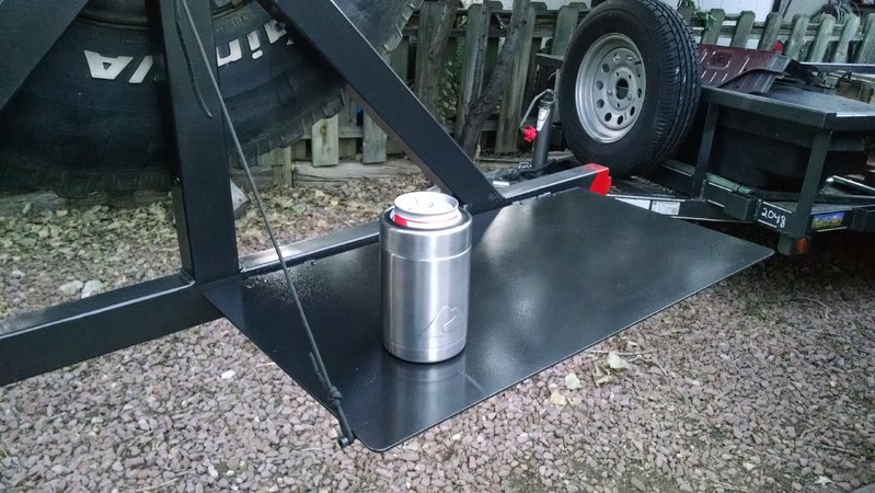

    I needed a place to set my beer.
    So I made a table.
    Just happens to fit the stove pretty well too.

    How does it stay shut? Pretty nifty!
  4. Aug 17, 2016 at 7:27 PM
    #624
    Deathbysnusnu
    Deathbysnusnu [OP] Work is just a daily detour to happy hour.
    Oct 4, 2013
    #113825
    17,193
    Brett
    Fort Crawlins, CO
    Vintage Tundra
    Dog, camper.
    That hand clamp for now. And parachute cord to support it. Keeps it rattle free and easy to adjust.

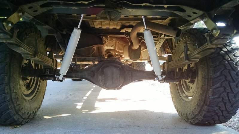

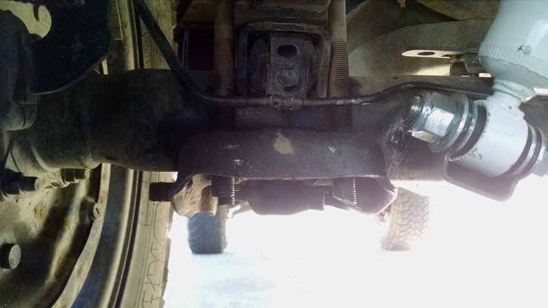

    Since the addition of the swing out, I have developed a gnarly case of wheel/bed hop from the rear at speeds over 60 mph. Like the frame is flexing, no surprise there.
    I already have the frame plate mod and this was a huge improvement.
    So hoping that it's just the poor shock design coupled with one shock that is actually blown.

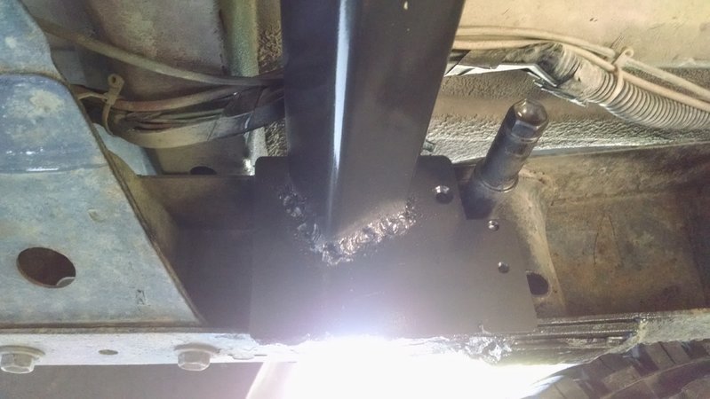

    I relocated them today.
    2" square tubing, 11 gauge. 11 gauge plate welded to the frame.
    If I had it to do over I would have used round tubing, but I had the square on hand and made it work. It's at an angle to make the mounting surface easier to work with.

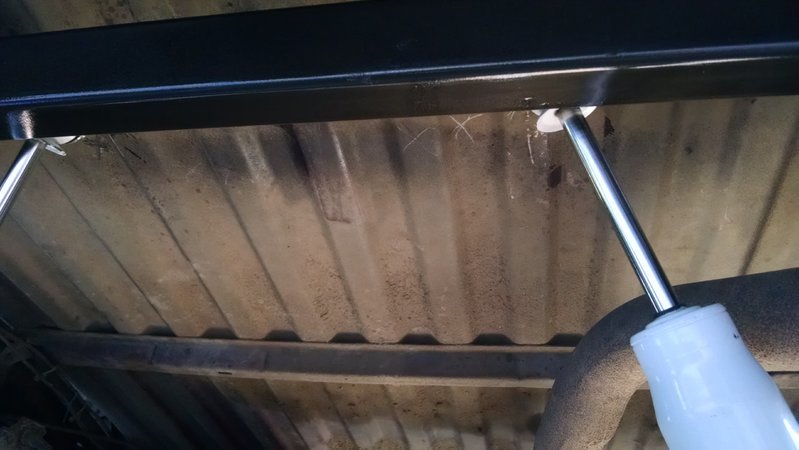

    Upper mount. The "X's" were target locations during the mockup.
    top mounts are 11" from the inside of the frame if anybody wants to know.

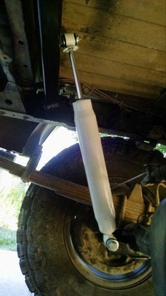

    This is ride height, notice the bumpstop travel compared to the shock travel.
    I still need a set of bumps, they will be ordered next.

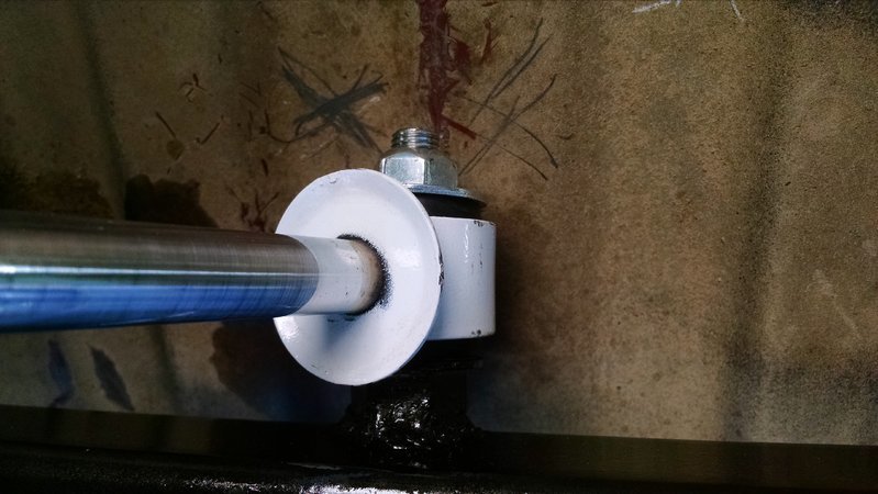

    For the driver side, I had to reverse the U-bolt plate so the factory shock mount was out of the way. I did think about just cutting it off, but decided to maintain the factory strength for now. I eventually want the U-bolt flip kit. I also want to maybe redo the axle shock mount, I wasn't 100% pleased with how they looked but maybe they will be okay.

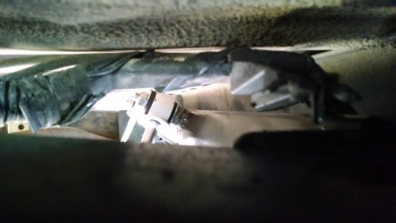

    View of the top mount looking between the frame rail and the bottom of the bed.
    I got them as high as practical and still be able to remove/replace them without fighting with the bottom of the bed.
    I took a short drive and got her up to 75mph and it was smooth as silk. Taking it wheeling later to see how that works out. I'll try to get some flex pics.

    Now, as for the shocks themselves...
    lol, they are no-name old school 70/30 emulsion shocks with a 2 1/2" dia. body and 12 1/2" stroke. 30" fully extended. They are much softer than the Rancho 7100's that were on there.
    At full droop they sit at 28" extended so i have some room for force flex.
    I bought them as mock up shocks, they cost me $25.00 each. :anonymous:
    and they actually ride pretty darn good. Not as nice as King's or the other high zoot offerings but will be fine for now. I just wanted the hop to go away and I achieved that. :taco:

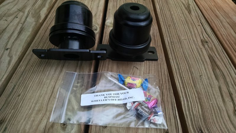

    Upcoming projects.
  12. Aug 31, 2016 at 3:00 PM
    #632
    Squeaky Penguin
    Squeaky Penguin Nothing Ventured, Nothing Gained
    Apr 5, 2012
    #76340
    10,069
    Brett
    Steamboat Springs, Colorado
    '01 4WD, SR5, TRD & '13 TRDOR AC
    Lots of dust and custom dents, Check Build
    Didn't want to fab you're own mounts? Going to be you'll need some spacers in there.

    Anyways, I didn't end up needing spacers, but I was just going to buy a sheet of UHMW and cut my own with a hole saw. The ones from Wheeler's are way overpriced.
  15. Aug 31, 2016 at 3:17 PM
    #635
    Deathbysnusnu
    Oct 4, 2013
    #113825
    17,193
    Brett
    Fort Crawlins, CO
    Vintage Tundra
    Dog, camper.
    I found it interesting that a package from Oregon made it here before a package from Red Feather Lakes, which is only 40 minutes away. Both ordered the same day and time.
    As for spacers, if any are needed for the pad to make contact, I'll just bolt on an appropriately sized something (scrap metal) to the frame pad to make it work. :D

    Keep in mind the bumps will compress down to like 1/2 of their free height. Are the necessary to stop bottoming out on your new shock setup, or are you just trying to soften up the hard hits so you can keep up? :D
  17. Aug 31, 2016 at 3:29 PM
    #637
    Deathbysnusnu
    Oct 4, 2013
    #113825
    17,193
    Brett
    Fort Crawlins, CO
    Vintage Tundra
    Dog, camper.
    Yes :D
