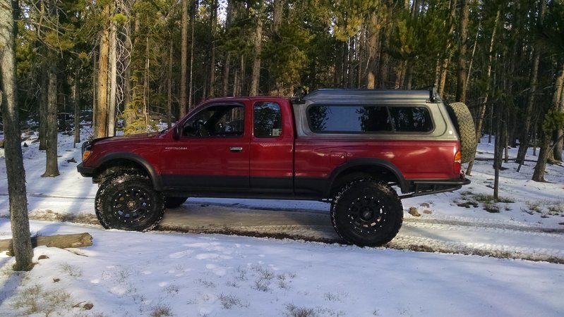

    I knew they weren't the answer, but the flair offers some coverage for the area that gets cutout. Pus the arch looks better with a larger tire. In the winter, that cut out area fills with ice, and opening the door can be sketchy in the mornings. I'll stick with the flairs I have though, and find a way to fill the gap. Prolly cut up the kids' plastic sled for a liner of sorts...:D
    Lumpskie likes this.

    It just looked like you had more clearance on one side than the other in the rear.

    The front wheels do because of alignment. Maybe that is what you were seeing. The rear is even on both sides, I had to go check. :p
    Reh5108[QUOTED] likes this.

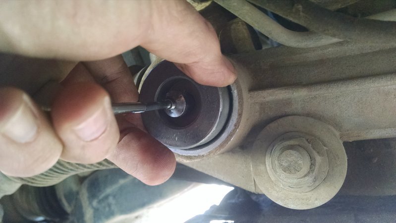

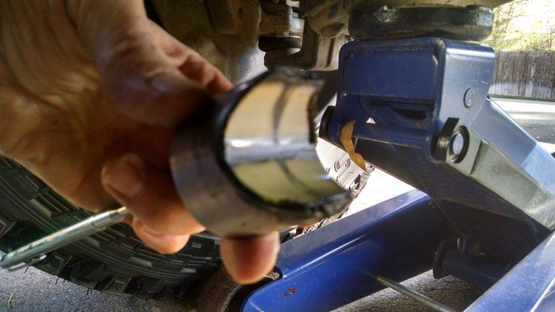

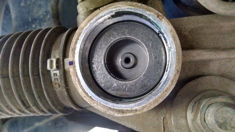

    I have had some play in the steering rack for several months now and really had no idea where to look.
    A couple guys in the 1st gen thread pointed the way.
    Thanks to @Speedytech7 for the explanation and to @TMFF for providing the links.
    And Mr. @Dirty Pool for his excellent writeup.
    https://www.tacomaworld.com/threads/rack-pinion-service-tools-tips-dry-wordy.312600/
    http://www.yotatech.com/f2/how-replace-steering-rack-guide-pictures-215931/

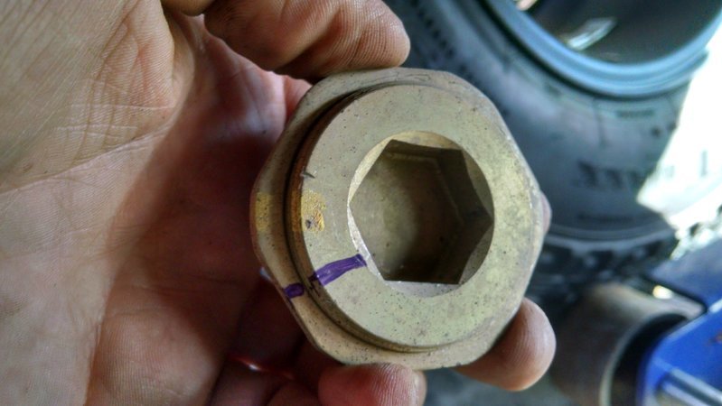

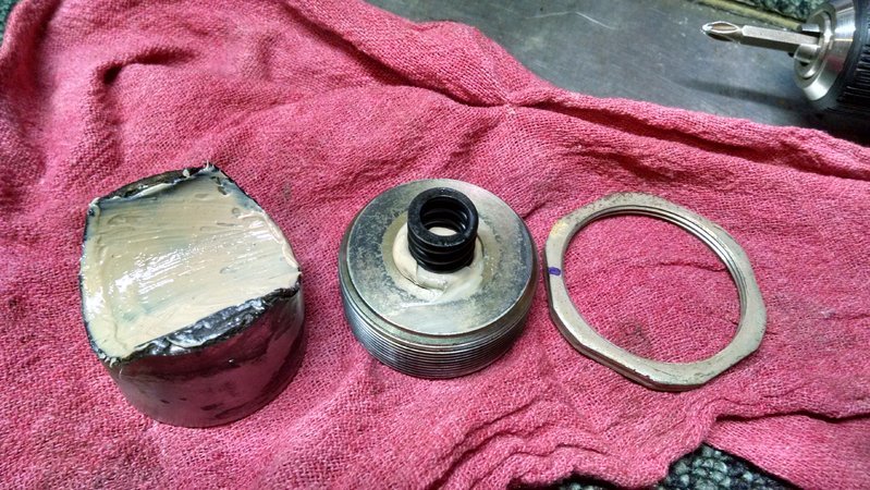

    Here is the cap, it is the newer style.
    The rack bushing.
    comes out easy with a magnet.
    After inspection, looked fine I guess, I gave it a coating of grease and a blob to hold the spring in place. Went right back together, no problem. I was able to get it to tighten up just a bit more, too much and you definitely feel it in the steering wheel, It gets stiff and won't return to center after a corner. So some of the slop was removed, there is a small amount left but overall an improvement. I'm wondering if the racks don't have a small amount of play in them anyway, when I get the new one, I'll check.
    https://www.youtube.com/watch?v=VgmcrVne3W0
    Drove just fine afterwards, so I guess leave it for now.

    There should be zero play (OE Toyota) when shaking the rack shaft by hand. The guide spring pressure can be overcome with enough force. Talking loose play here.
    When the plastic surface of the new style guide wears, it becomes semi elliptical. This allows the rack shaft (round) to "more freely" move up and down. When the adjuster is snugged up against a worn guide the result is usually a short lived symptomatic relief. The new guide should* cure this.
    There is a plastic bushing inside the pass side rack end cap that can also wear but it's a 360 degree thing and lasts much longer.
    Some observations.
    Judging from your year, you have a replacement rack. Further, it is one of the knock off "new aftermarket" racks commonly referred to as "AAE, Safari" and now a host of other vendors. I believe AAE is the importer.
    I base this on the style of boot clamp, the color of the guide plastic, the brass colored plating on the adjuster, the profile and machining of the adjuster and the lack of the "TOYODA" (yes, d) name cast on the rack housing just inboard from the adjuster.
    I mention all that because they have had a fair amount of issues. @Squeaky Penguin comes to mind and there have been others, Box Rocket had an inner tie rod "just snap". It seems to be mostly a quality control thing as there are plenty of folks with no problems, hard tellin not knowin.
    *Anyhoo, I am curious if a new OE Toyota guide is going to fit correctly in the clone rack. AAE also distributes "replacement" parts apparently for OE rack rebuilders, so I'm guessing an OE part should interchange. And put a good eyeball on those ITR's.
    S Penguin may chime in with any research he may have done.

    You sir have excellent powers of observation!
    First off, your write up is excellent, I have read through it enough I feel i can tackle a rebuild if necessary. :bowdown:
    You are correct, the rack is aftermarket. I have no idea of the brand, I had an independent shop do the replacement. It is about 2 years old and roughly 35,000 miles, give or take.
    I wondered about that play and felt that it should not be there. I appreciate your input that it should not.
    As far as trying to replace the guide with OEM, I think I would rather just replace with a brand new OEM rack and move on. I could easily end up chasing one repair after another being as the rack itself is prolly inferior in other ways. However, it may be interesting to tear down the aftermarket unit and see if it can be saved as a spare.
    As far as what I did, I tightened the cap snug, backed it off a tad, and set the lock ring. As soon as I pulled off the end of the driveway, I could tell it was too tight as there was no return on the wheel and felt stiff. Backed the cap off a little more, and it was free and a bit of slack had been removed.
    Monday I plan on going to the local dealer and ordering a new rack. Everything I replaced with aftermarket a couple years ago, has had to be replaced again with OEM in this last year. The rack is literally the last item.

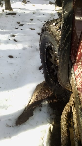

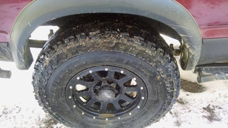

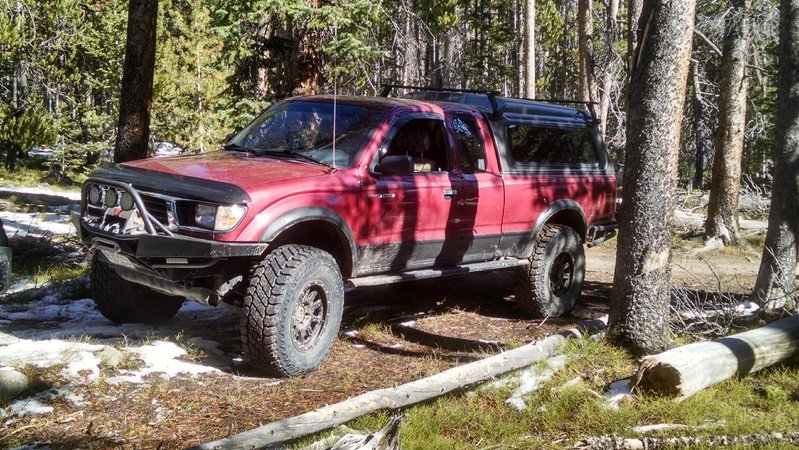

    Took 'em for a ride.
    First time off road. They grow up so fast.
    10psi
    I think I'm good here, I have 2" to go before bump stop contact and I've already determined i need to close that gap with a block about 1 1/2" . II don't see any need for trimming.
    They cleared well, I never scraped or rubbed tire all day. There was also a half load of firewood in the bed.
