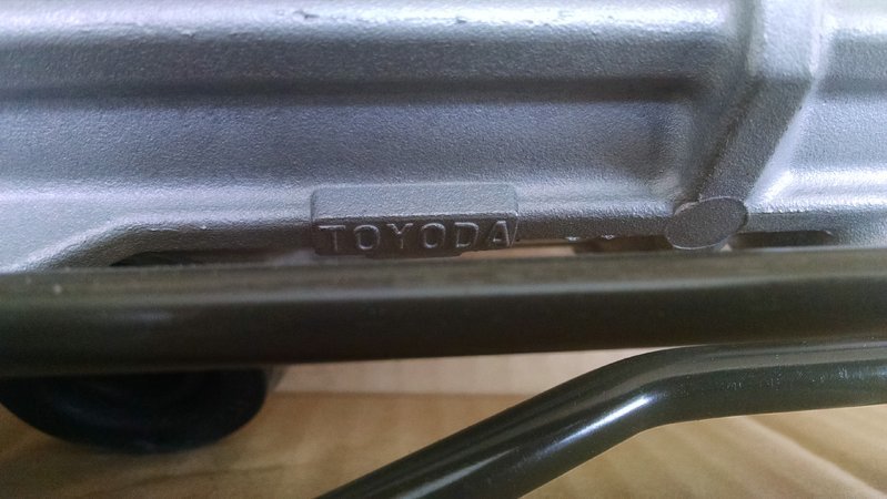

    I love when oem stuff says toyoda...they never should have changed it lol

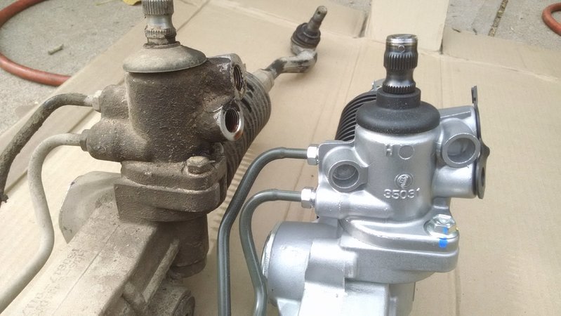

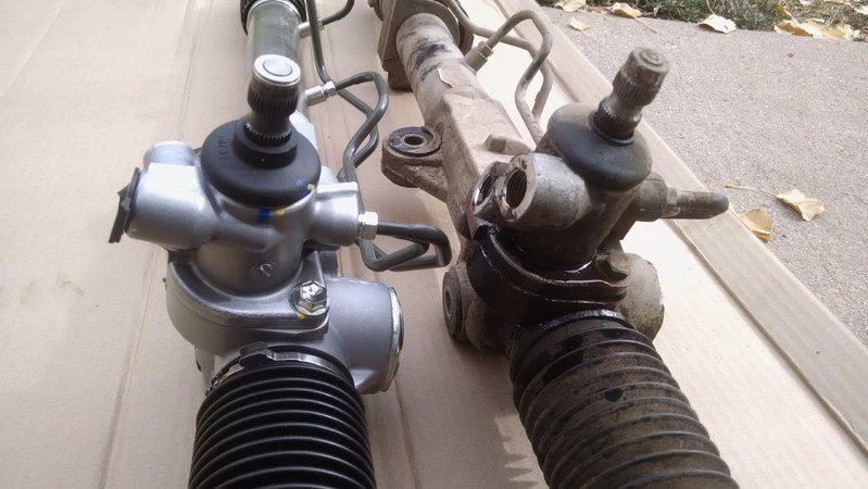

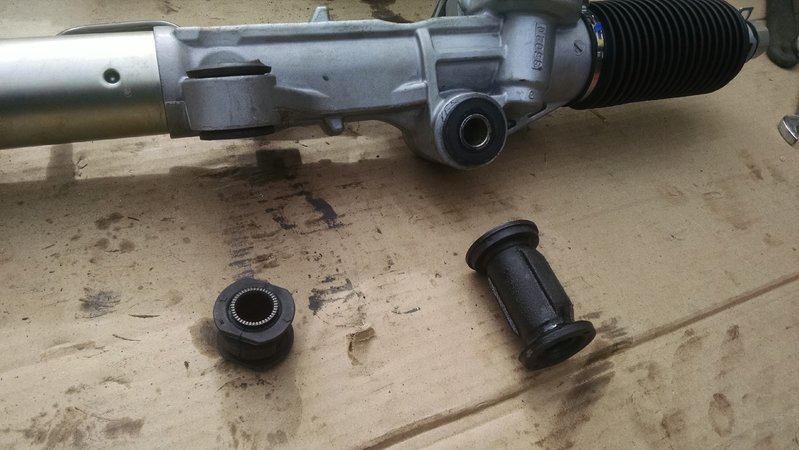

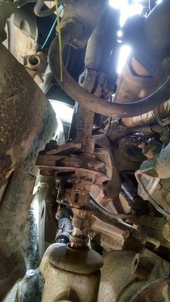

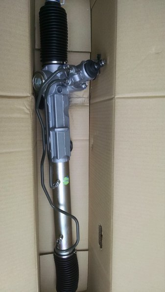

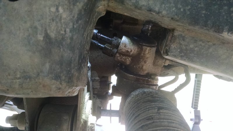

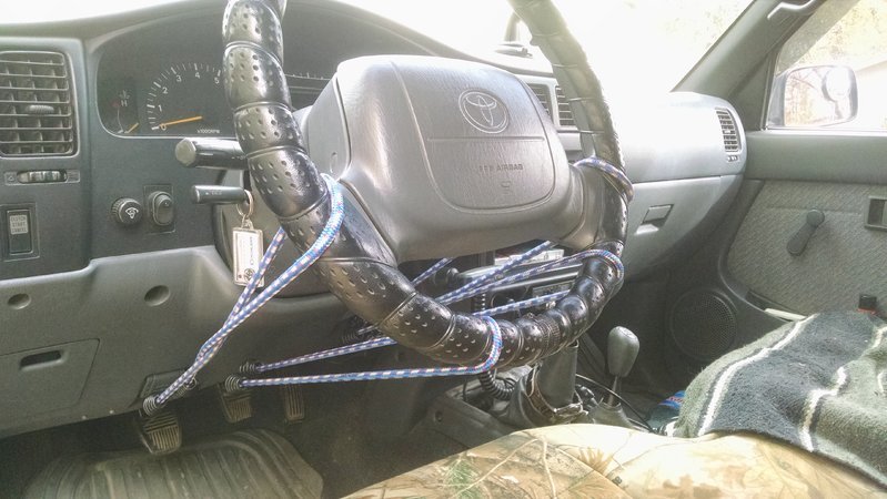

    Weather has been great so the new rack is going in today.
    New jack stands so i can finally be safe.
    Secure the steering wheel
    Loosen all 3 bolts holding the rack in place, and move it out a bit and the wet connections are easy to get to.I discovered my low pressure line neede some attention, good time to take care of it.
    The rag joint has two splined connections, upper and lower. Loosen and remove both bolts. The upper splined section has enough room to slide the rag joint up to disconnect from the rack connection. I used a long drift and a hammer and gently tapped it out of the way.
    And it's out, took a couple hours working steady and taking phone calls.
    Some slight differences between aftermarket and OEM
    Went ahead and removed the soft rubber bushings, no improvement there, and re-installed my poly bushings which were still in great shape. I can't remember if I did those early this summer or last summer...prolly read back and find out.
    Those are the oem on the ground.

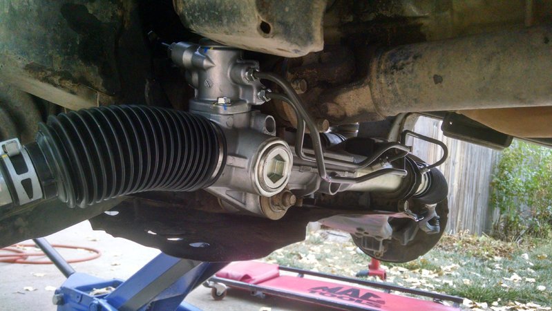

    I checked, it was June 2015 when I first put the poly bushings in, so over a year of service and they looked great imo.. Way better than the new oem rubber ones.
    So, It's in, I cycled the rack by hand, engine off, until it pulled fluid in and stopped needing filled. Upon startup, it actually "burped" a bit back up but the level stayed full, must have been a bubble. Took less than a quart.
    I got lucky and got the tre's pretty darn close, the wheel is straight and iot seems to drive fine. The feel of the steering is somewhat stiff but prolly normal for a brand new rack :)
    And no leaks so far.

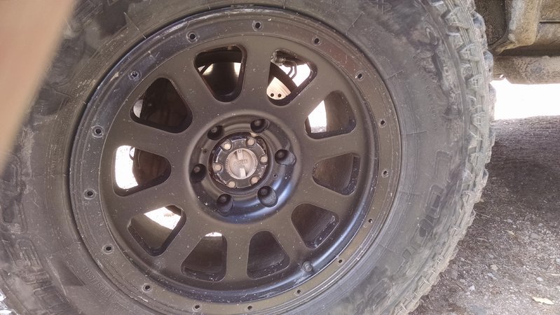

    These wheels.....:rolleyes:
    So there are a bunch of holes that were left behind when I pulled out the rest of the plastic plugs that the trail didn't remove for me.
    The holes do not go through, they are not threaded.
    Should I leave them alone?
    New steel bolts might throw off the balance as well as get torn out again.
    Maybe fill them with black silicone? or just leave them and see what happens?
