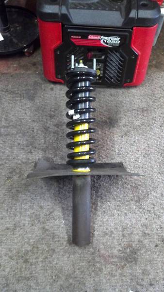

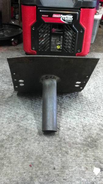

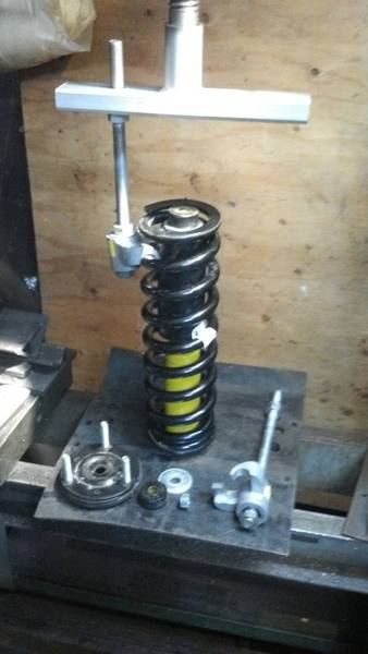

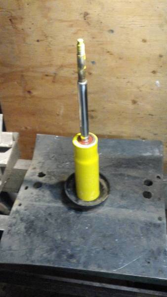

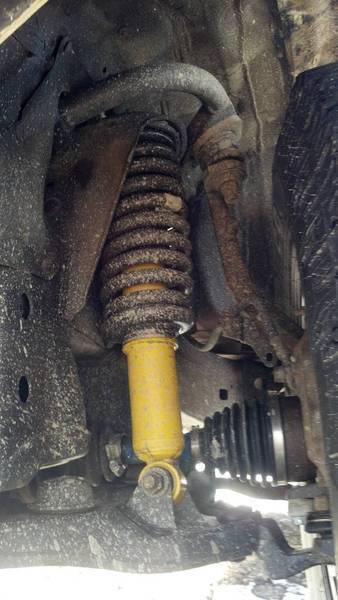

    In order to work with the OME shocks, I had to make a minor change to my press arrangement. The coil perchs are rounded where the stockers are more flattened and easier to place.
    So I utilized an old skidplate from a 1967 Scout 800 that I used to own. I drilled a 1 1/4" hole through the plate. This allows the support lip on the shock to rest on the edge comfortable and no chance of being pushed through.
    Next for stability I welded a leftover chunk of driveshaft from a 1972 Scout II to the base to hold the shock in check so it wouldn't walk around on me. The welds are crappy, don't look close, I was in too much of a hurry to clean the sludge off the plate:eek:

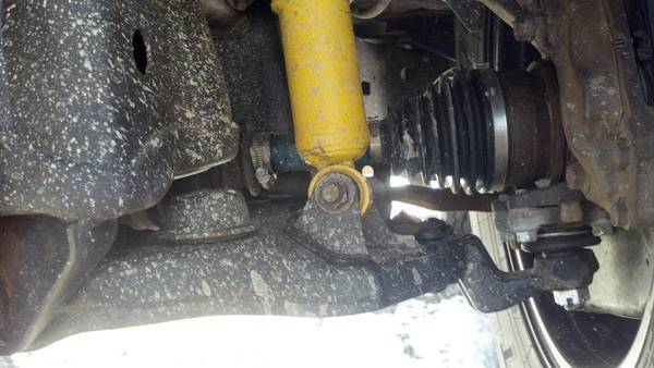

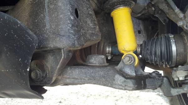

    Shock in place. I ran it to the car wash yesterday and cleaned off the mag chloride and crap, surprised at how they still look new. I've had Rancho's show signs of pitting after a month.
    883 coming off
    5" stroke on these if anybody wants to know.

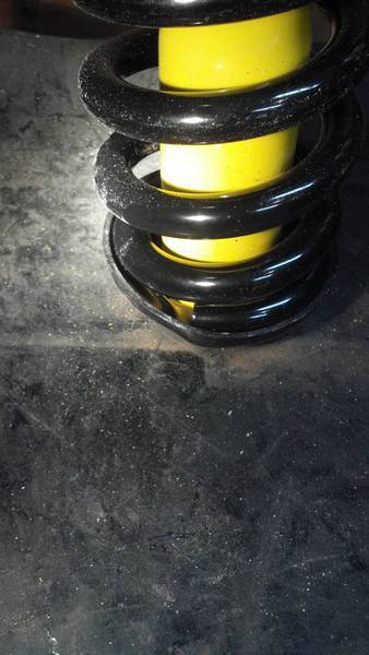

    Clean the winter crap out of the perch

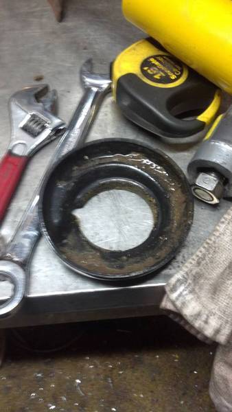

    For those who have never done this, be sure and get the end of the coil fully seated in the perch, rotate it until it stops.
    And of course I was again in a hurry due to quickly fading light and failed to take a pic of the finished product but seen one seen 'em all.:rolleyes:

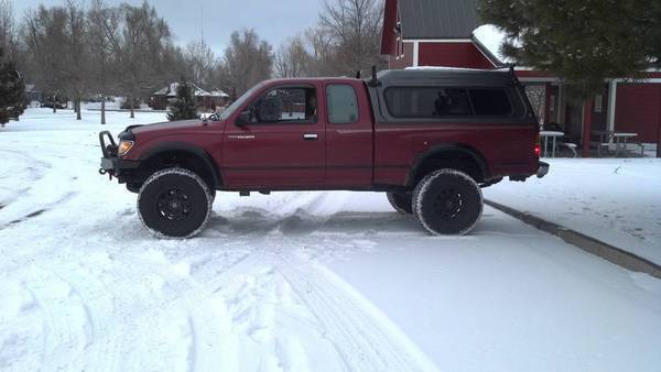

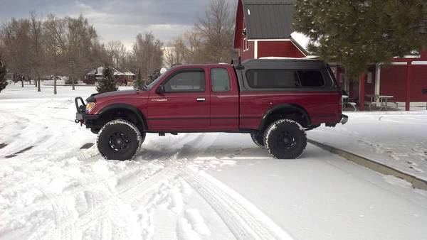

    My posing spot, 882's with 1/4" poly spacer gave extra 1/2" lift over the 883's with 1/4" poly spacer, but I expect them to settle in like the others did. Hub to fender is 25 1/2", too tall.
    an hour later I had the spacers out and was down to 25"
    My target height is 24 1/2".
    The 883's with the 1/4" spacer were sitting at 25" both sides, removing the spacer with those coils should net what I want if I choose to put them back in.
    If the 882's drop the expected 1/2", that will work too as far as height.

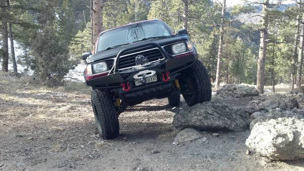

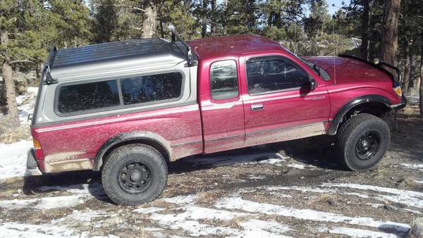

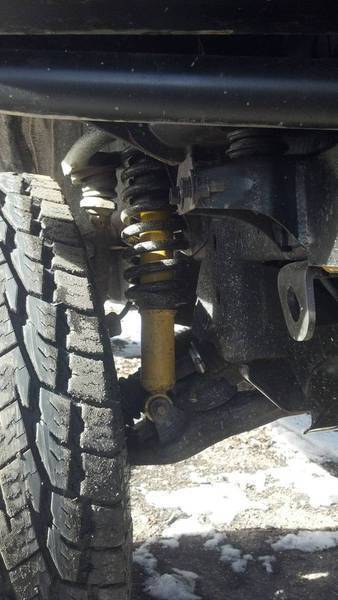

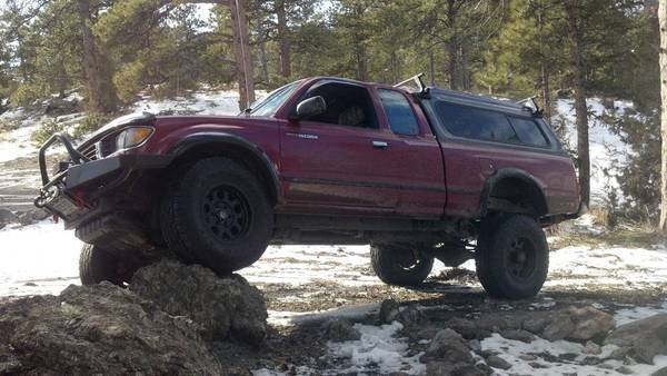

    Ok, 883 at full compression with what I got.
    882, same rock
    882 here more compression, looks more stable
    883 here less compression, looks like more of an angle to me. Although to be fair it looks like I'm a little higher on the rock here so that may be what I'm seeing.

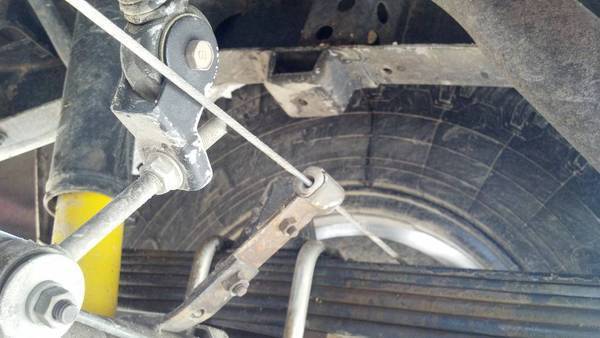

    Rear bumpstop, got a ways to go. It was the same before just never got a pic.
    Front has settled after today to 24 3/4". Pretty happy with how it looks and rides so far.
