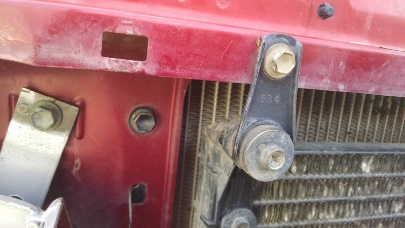

    Factory/Dealer mod.
    This applies to 95.5-97 trucks with factory AC.
    The back story...
    My AC crapped out last fall, just as the snow flew. No biggie, I'll fix it in the spring.
    Well, Spring came early. Actually, there is a lot more to the story, but telling it makes me homicidal. So lets just go with why YOU might want to change it.

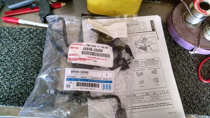

    There is an actual TSB about this from years ago. If your truck has less than 3 years or 36,000 miles, you get it for free.....:rofl:
    In the front of the truck, near the accumulator, are two lines. line #1 and line#2.
    Line #1 is prone to cracking due to stress flexing.
    There is a revised kit that replaces a few brackets, and changes the shape of Line #1 so it can vibrate away and be happy about it.

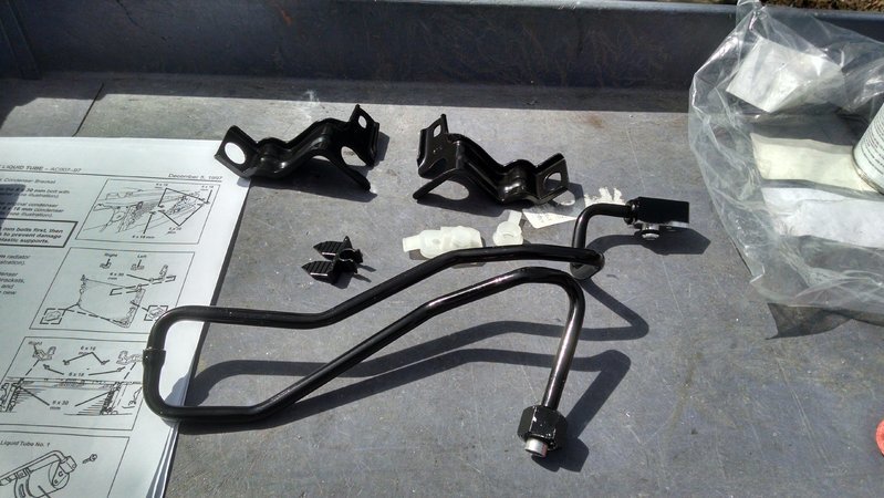

    The kit. From Toyota.
    The TSB

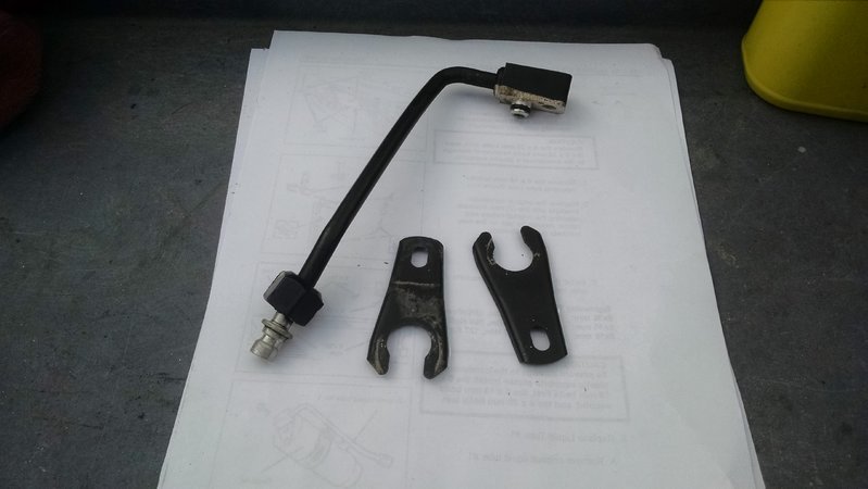

    The 6 replacement parts. Two of them, the clear/white plastic pieces, are optional.
    The short tube that is disconnected at the bottom is being replaced. Mine has a crack in it at the lower fitting.
    The crack.

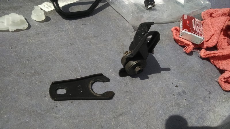

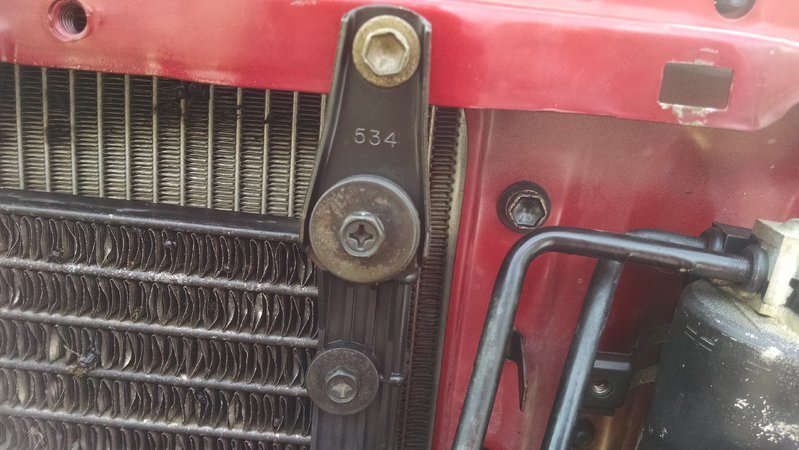

    The bracket with the #534 stamped on it gets replaced, there is another on the passenger side as well.
    The old bracket and the new bracket.

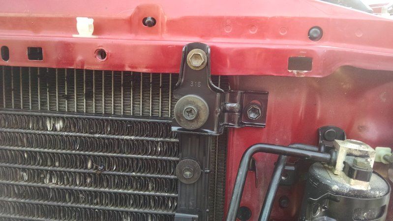

    The rubber vibration grommet is reused. It just slides off and back on to the new bracket.

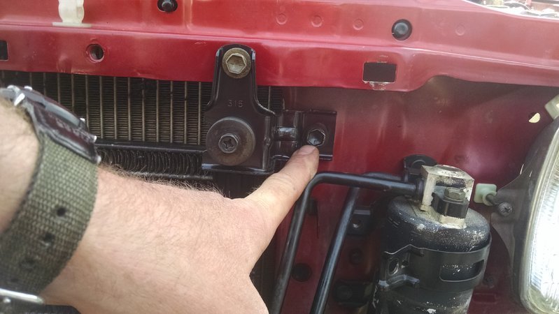

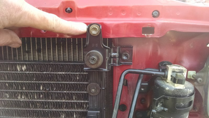

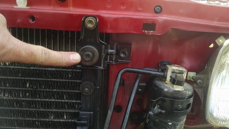

    New bracket in place. Tighten the bolts in this order to avoid cracking the condenser, cause that would really suck.
    Number 1 bolt. It's hole is non adjustable, start here.
    Number 2 bolt. This hole IS adjustable, make it straight, or as straight as you can. this one sat just slightly off kilter. This bolt is actually the upper radiator mounting bolt, now they share the mount.
    Number 3 bolt. Tighten this last, just make it snug, as it is going through the plastic portion of the condenser.
    One for each side.
    All they do is reinforce the condenser mounting points. It's much more secure now.

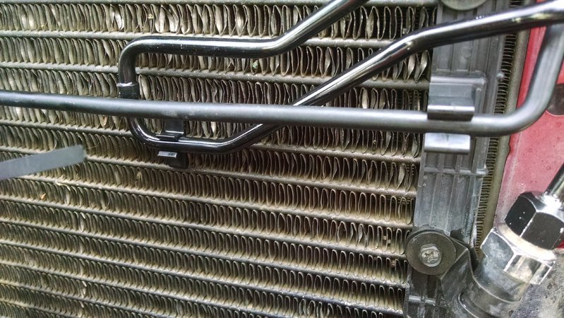

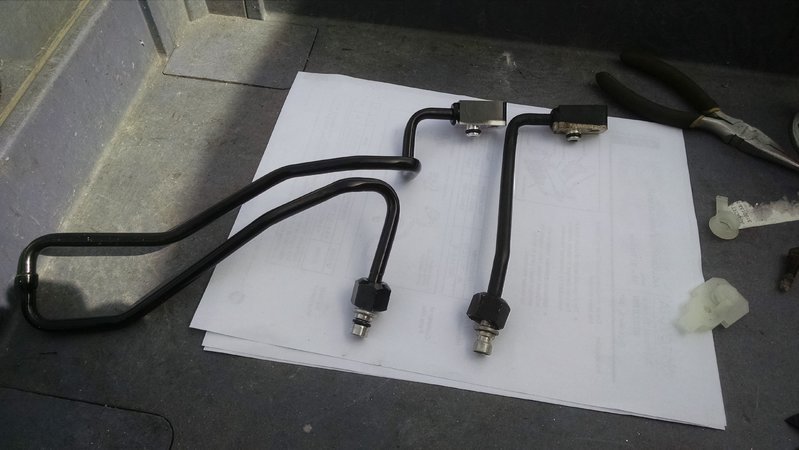

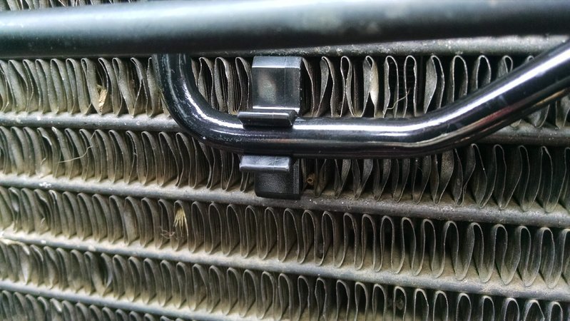

    New pipe #1 on the left, old pipe #1 on the right.
    New clip for pipe #1. It simply presses in between the fins and keeps pipe#1 from rubbing.
    It's general location.

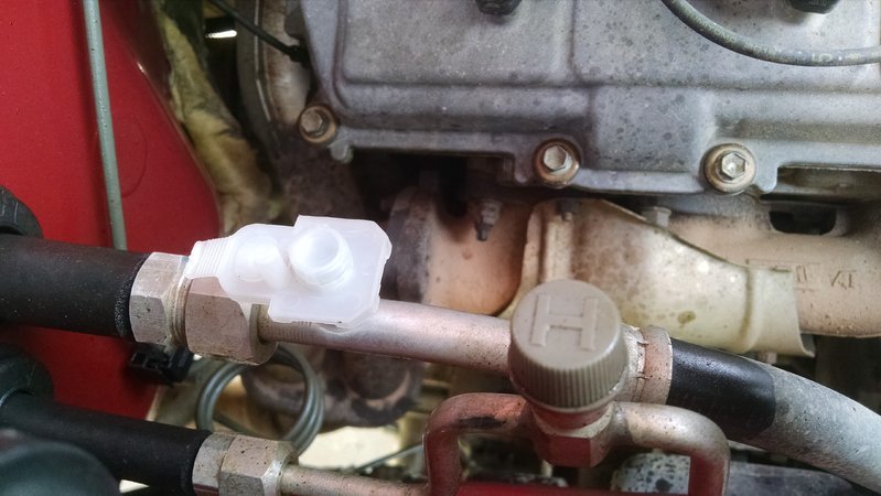

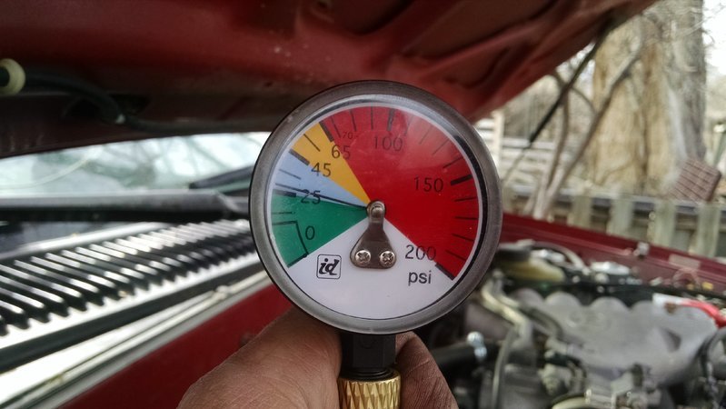

    A couple of 12oz cans of R134A brought it to the minimum charge. I'll do one more to top it off. It's pretty damn cold though, makes me happy.
    The two clear/white plastic pieces that I mentioned were optional, are cheap replacement caps for the High and Low pressure ports. Which was fortuitous, as I lost the low side cap, while I was doing the job. I think the dog may have ate it while I was doing the replacement. :eek:
    The parts that were replaced when it was all said and done.
