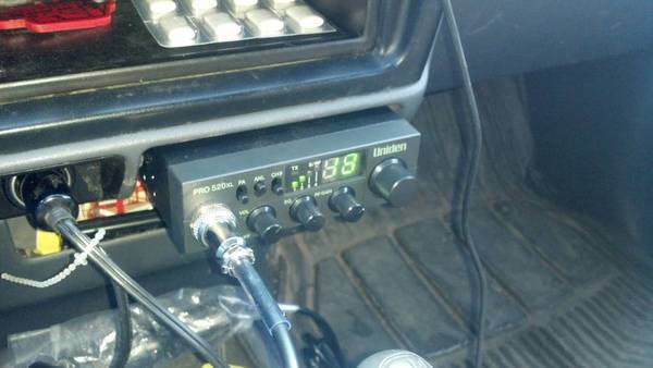

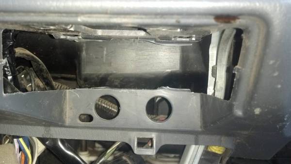

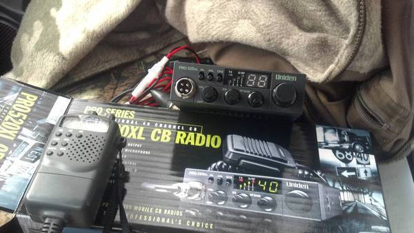

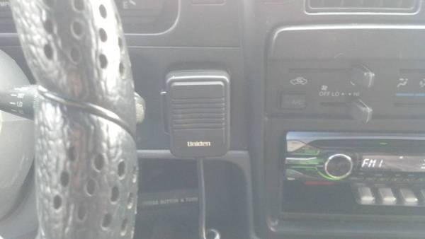

    A recent trip and use of my old CB made me realize the sound quality is garbage with the little 1" speaker. I'm getting old, and it's not that it's too loud, it's not loud enough!

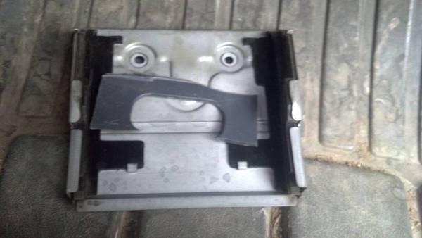

    After seeing all the neat pics a lot of you have of the ashtray install, I'd thought I'd do the same.
    New CB with my old hand-held set.

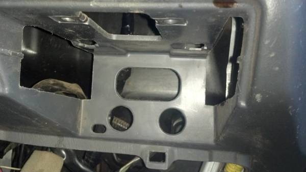

    First, remove the ashtray and the two screws that hold the slider bracket in place. Here is the empty cubby.
    The oval area needs to be cut out.
    You end up with this. I cleaned up the cuts before final install. A sharp utility knife cut through this in less than a minute.
    Slider bracket and the removed piece.

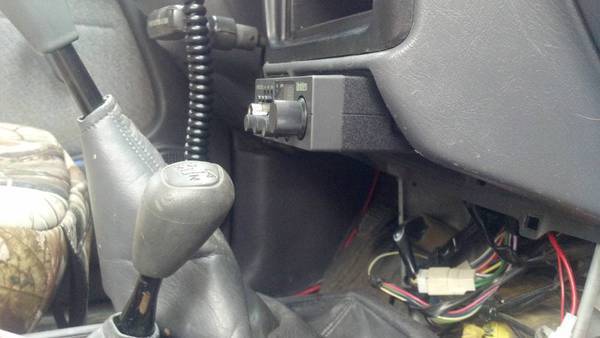

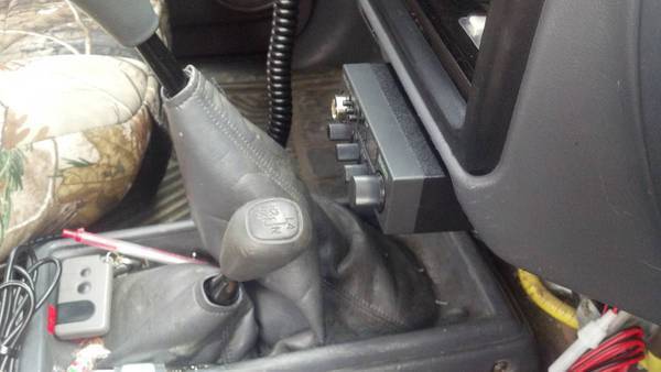

    That's pretty much it. It just slides right in and holds fine on it's own.
    I may search for the coveted 90° adapter for the antenna to move it back more, but it doesn't interfere with anything.
    Pics are with the shifter in 5th and the T-case in 4lo.
    The extra wire is for my GPS and the USB connection.
    The mike is a little hokey but as long as it's clear I'll keep it.
    The whole installation only took about an hour. I already had the antenna installed so that helped. Sound quality is much better.:cool:

    Toytec 16" coilovers with Tundra Bilstein 5100s, Light Racing UCAs, Alcan Leafs with Orbit Eyes, 12" Bilstein 7100 short Bodies, ARB rear locker, 33x12.5 Duratracs, CBI sliders, Bushwacker fender flares, self made front bumper, M8000, Vision X 6.7" Hi/Lo Beam HIDs, full skids, Inchworm dual case setup - 15º clocking
    That Uniden installs so clean. I still need a clean solution like that for my cobra.
