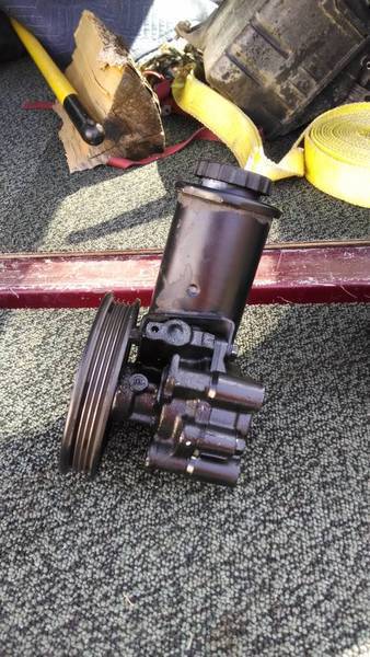

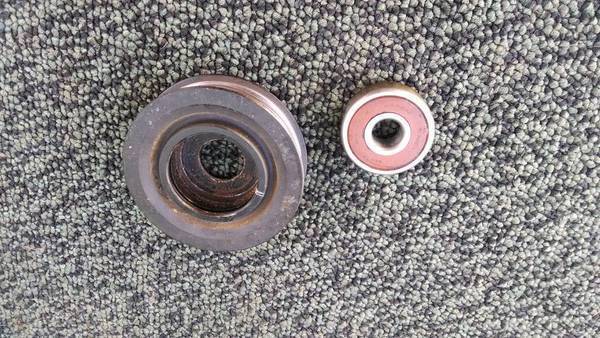

    The power steering pump is about to give up the ghost so I replaced it today.
    Rebuild from Napa, reused my reservoir and pulley. $120.00 from Napa with exchange.
    EDIT; I don't have pics but don't forget to clean the reservoir while you have it apart, I used a parts washer, then sprayed it through with carb cleaner, and shined a flashlight through the port to inspect the screen. Take the time to get all the crud out. (Thanks Squeaky Penguin!)

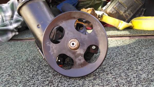

    It was very cool of Toyota to put these access holes in the pulley, really made an easy job of removing it

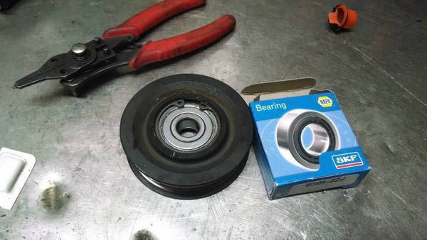

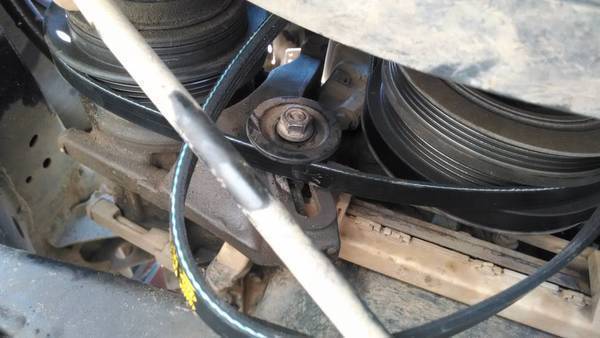

    I decided to change the belts while I was a third of the way in there and discovered the idler pulley for the AC was toast.
    By the way, is there any job on the engine that doesn't require removing the damn skidplate? i don't see getting an aftermarket job unless they come with some kind of easy disconnect.
    This the pulley location, I have the pulley removed.
    Old bearing
    new bearing installed. $22.00 from Napa
    Everything is all quiet now, no whining, except maybe from me about the skidplate:rolleyes:, steering is quiet again.

    You can get those bearings for about 6 bucks at the motorcycle shop on Drake. I even got a spare just in case.

    Glad you brough this up, because I almost forgot to mention it.
    Brett, I hope you checked the screen inside that resevoir when you had it out. They have a screen in them that is notorious for getting clogged. When I got my tuck, it made a bit of whining noise upon startup when it was cold. I took the resevoir out, cleaned that screen, flushed the system, and it's been good ever since.
    I've also read you can remove that screen, and replace it with a higher-quality in-line filter.

    I cleaned the res in the parts washer, checked the screen with a flashlight from the other end until it was spotless. Good point that you brought up, it would be an easy step to skip.

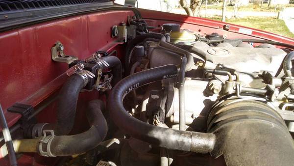

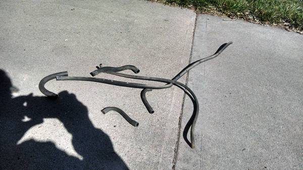

    Changed some vacuum lines today, still have some more to do, seems every size known to man is on this engine. I didn't get to all the little lines around the evap canister yet.
    Old
    New
    The old stuff
    The big breather in the foreground and the other end in the background.
