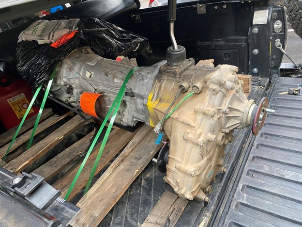

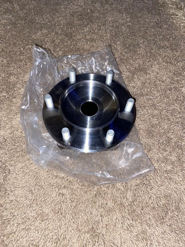

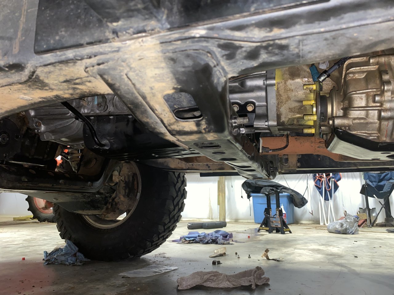

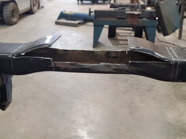

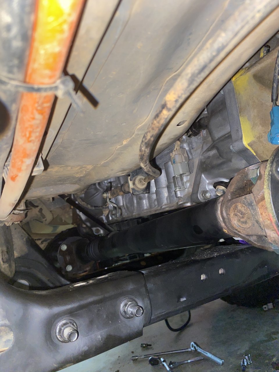

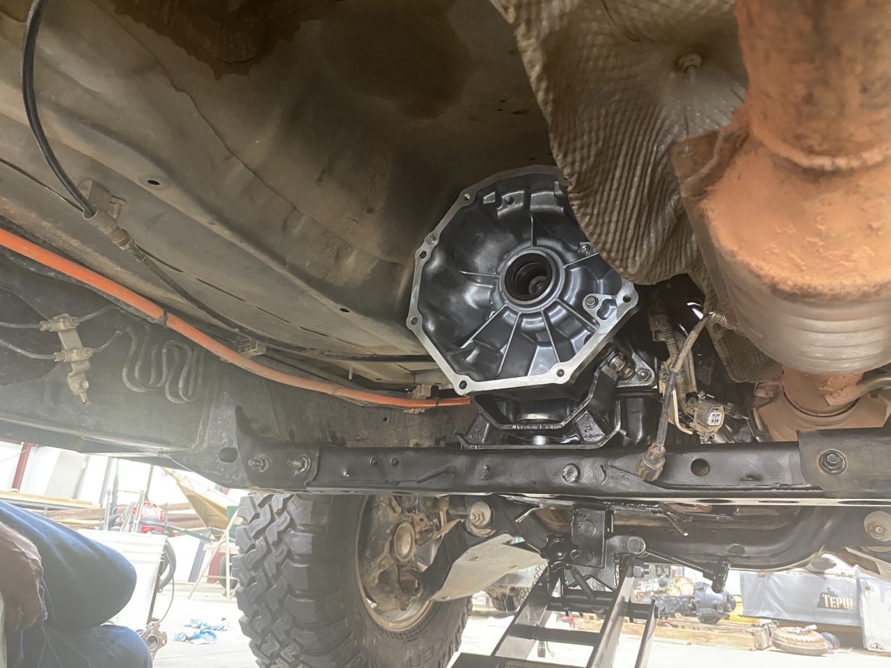

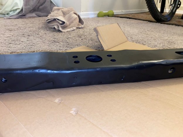

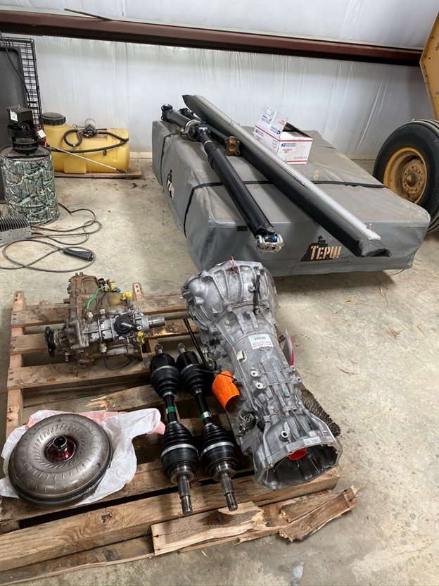

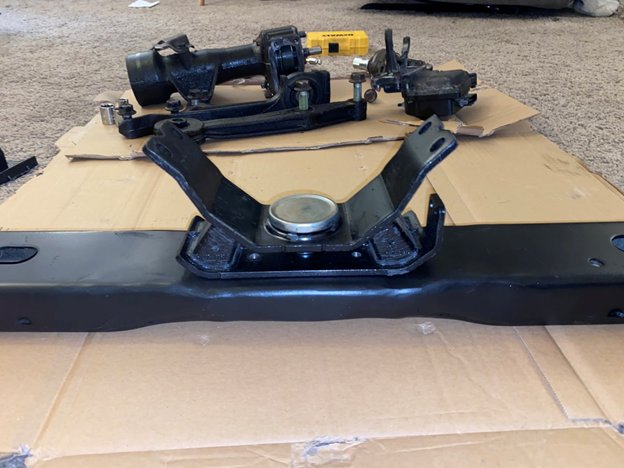

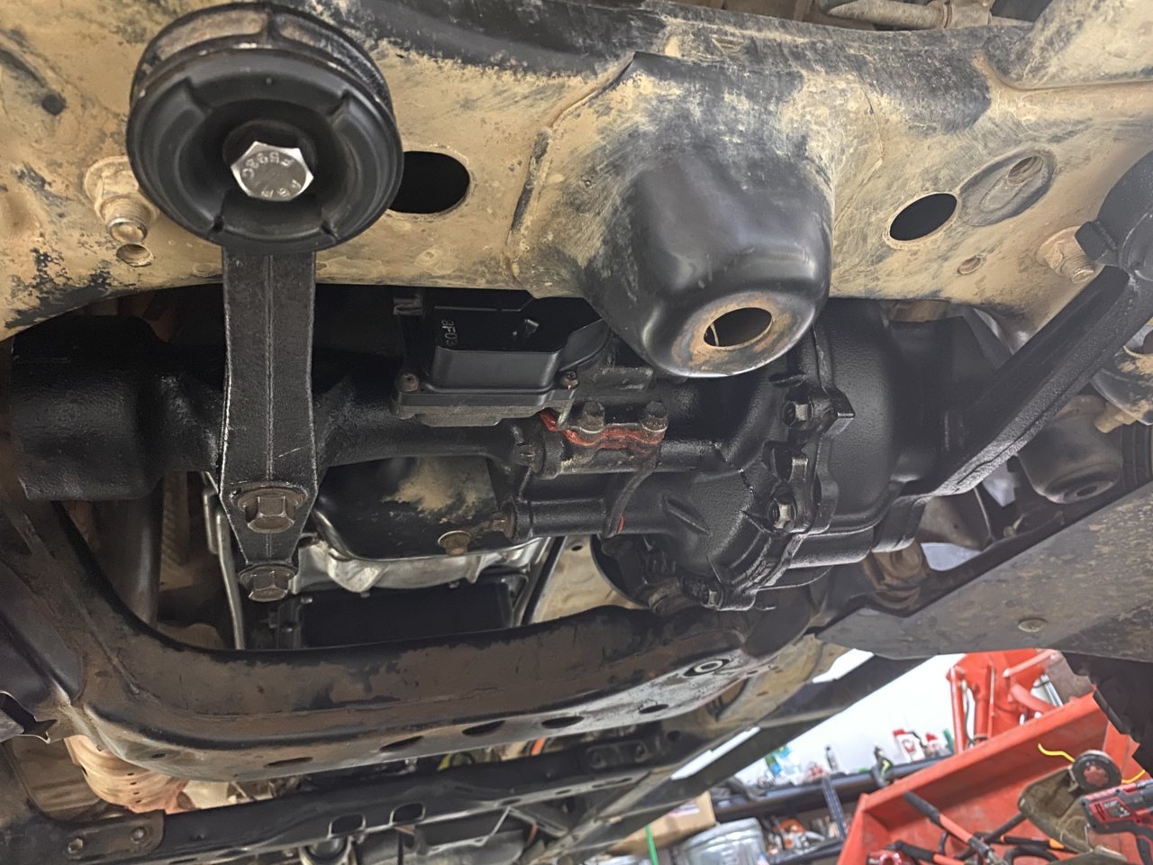

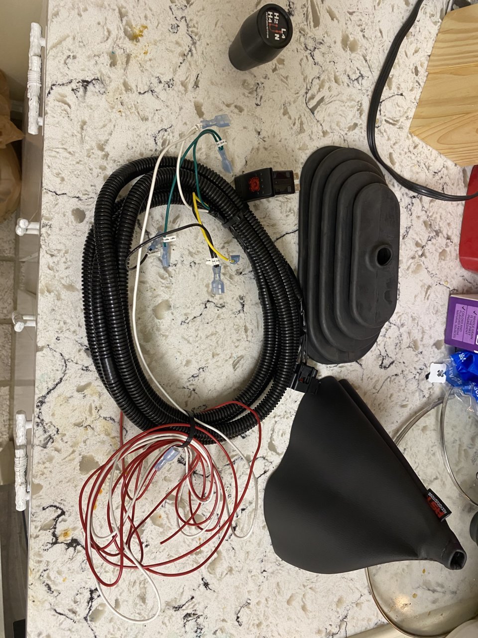

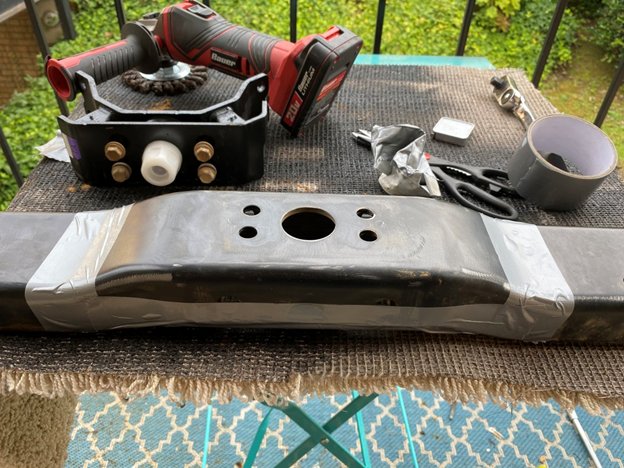

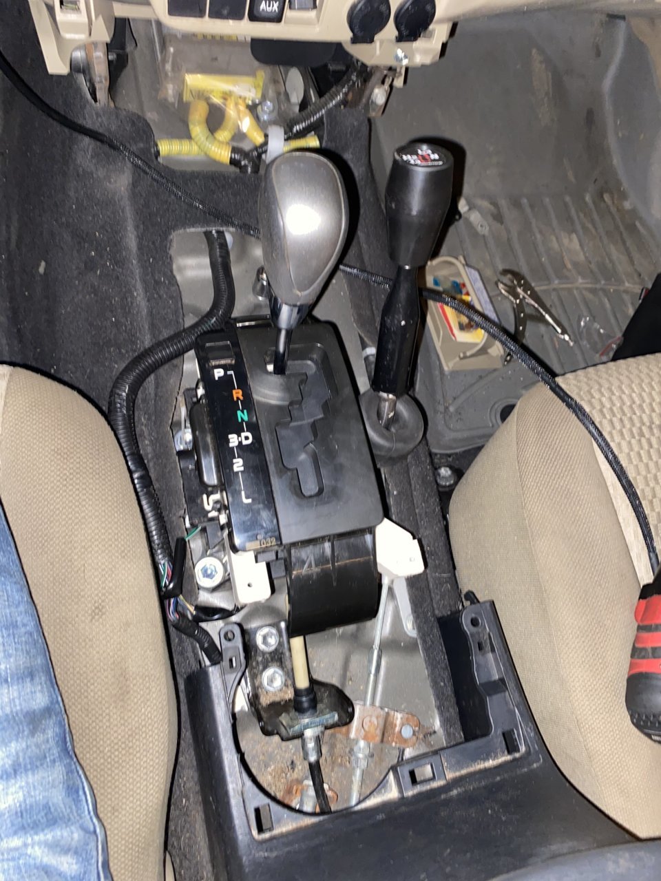

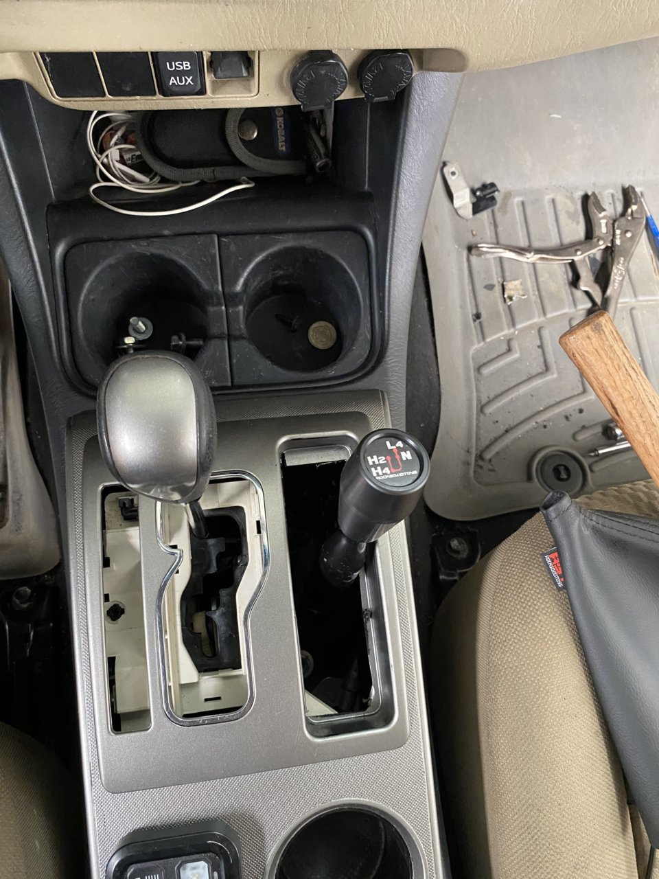

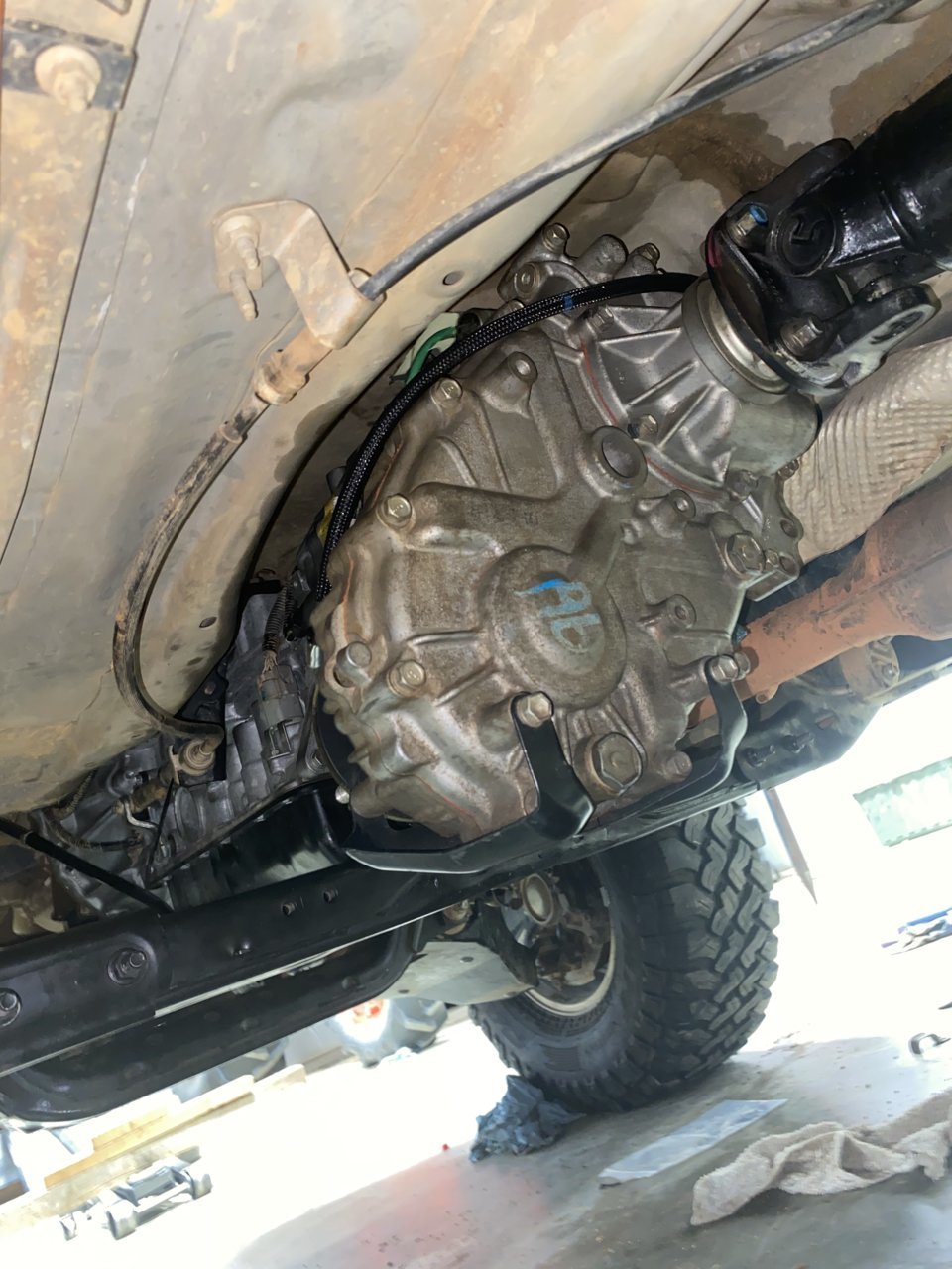

    4x4 Conversion Informational Guide:help:
    Finally, the post that I have been waiting to make. This is not a how to, but informational about the process of a 4x4 conversion. The purpose of me putting this together is to give you some more insight into the process and some useful info i have acquired during my process. Hope this helps!
    A little background as to what made my decision. My truck started out as a daily driver that i got back in college. I added the typical 3inch leveling kit and 33-inch tires and drove it around town. But as I started to invest more and more time in TW and going on group rides i learned that I needed more capability out of my truck. I started with a rear ARB locker and let me tell you that was the best bang for your buck in performance outside of tires. While the locker gave me a newfound capability it still did not give me all i wanted. So, there was only one way to go.... As my knowledge of these trucks grew i decided it was time to tackle the task of a 4x4 conversion.
    Most people will say just sell and buy a 4x4. Well I’m not most ppl. I did not for plenty of reason. My truck is not my DD, it also is paid off and has about 10 grand plus of parts already into it. Low miles at only 108,000 I also like the idea of having a unique vehicle that not many people would have. I also love challenges. This defiantly was a challenge.
    The first step into the conversion was doing my hw. Plenty of threads here on TW. (I will have links later to some threads that helped me). I researched for about 6 months before I started to collect parts. Collecting all the parts is the most time-consuming part of this conversion.
    How to Instructions:
    You will need the following:
    Main Components
    Minor Parts
    • Hub seals
    • dust caps
    • tcase bolts
    • driveshaft bolts
    • breather lines
    • lock nuts for cv x2
    • front diff mount nut x2
    • front diff mount bolt x2
    • Front diff mount washer x2
    • Front diff mount top bushing x2
    Misc
    • Transmission Oil (10.8 qt)
    • Gear oil (4 qt)
    • sound deadening mat to seal floor
    • tcase oil
    • fuse taps for add switch
    • rear main seal
    • shifter boot
    • 20guage wire (for tcase to cluster for dash illumination for 4x4 engagement)
    I sourced most of my materials from:
    · https://www.benzeenautoparts.com/toyota/tacoma-all-parttype
    · https://racewayauto.com/?gclid=Cj0K...MZnHcbXENZy1sxnTevopAaFcQZu-JOeEaAqytEALw_wcB
    · Ebay
    · Amazon

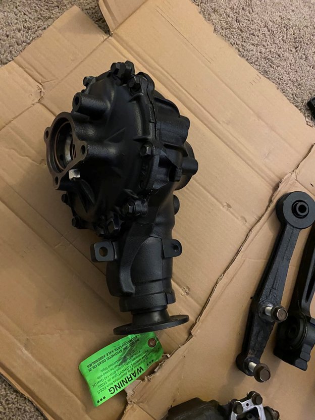

    Pics of what is needed
    Once you have talked all the parts the only thing left is to get them in the truck. I would recommend carving out at least 2-4 weeks for this if you have limited time to work on it. I was only able to work on it on weekends and it took me about 4 weeks to get it finished working all day on sat/sun.
    Some tools I found to be extremely helpful was:
    · Super long extensions
    · Transmission jack
    · Jack stands
    · Impact wrench
    · Welder
    · Flexhead ratchets
    · Wobble sockets
    · Creeper
    · Cutoff wheel
    · Dremel
    · Multi tool
    Also helps to have 2 or 3 hands if you can get them during the transmission install.
    Once you get everything installed make sure that you have torqued everything bolt and used lock tight where applicable.
    Torque Spec sheet: https://www.tacomaworld.com/threads/the-torque-spec-guide.318116/
    Make sure to test everything extensively before you take out on road. Make sure shifts are smooth and you are not getting any grinding noises.
    This happened to me because I left off some parts on my front diff. Thank god, I was still on my property……
    4wd Dash illumination
    You will need to make a connection from the tcase to the dash cluster directly. (See Diagram of Tcase below) Run some 20 guage wire from the 4wd lead and 4lo lead up to the dash cluster. I just stuck bare wire in there and worked well. ground the other 2 wires. Anyways test your shifter and should light up.
    Anyways have fun and be careful. And enjoy your new 4x4!:woot:
    More Pics
