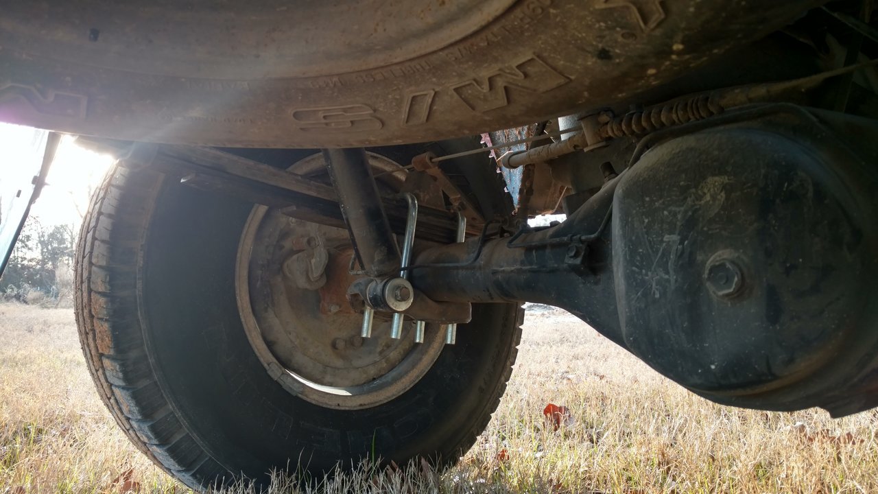

    @Speed Freek
    Do you remember doing this? If so do you have anymore pictures, specifically where the traction bar mounts to the axle?

    Ill have to dig for some pics, but it mounts to a custom plate that I built that has the mount for the axle that goes under the leaf springs, I still have my original one that I made for myself back in 2007! And I have 400rwhp, still works great, really helps with axle hop, I have absolutely none whatsoever.

    Is there one per side? My wheel hop is insanely horrible, it rattles your vision lol.

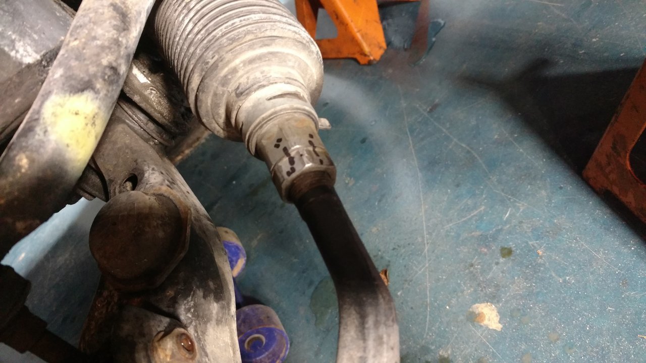

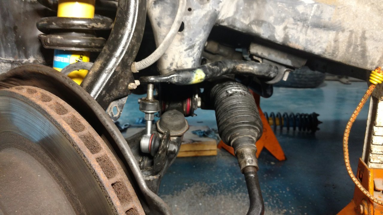

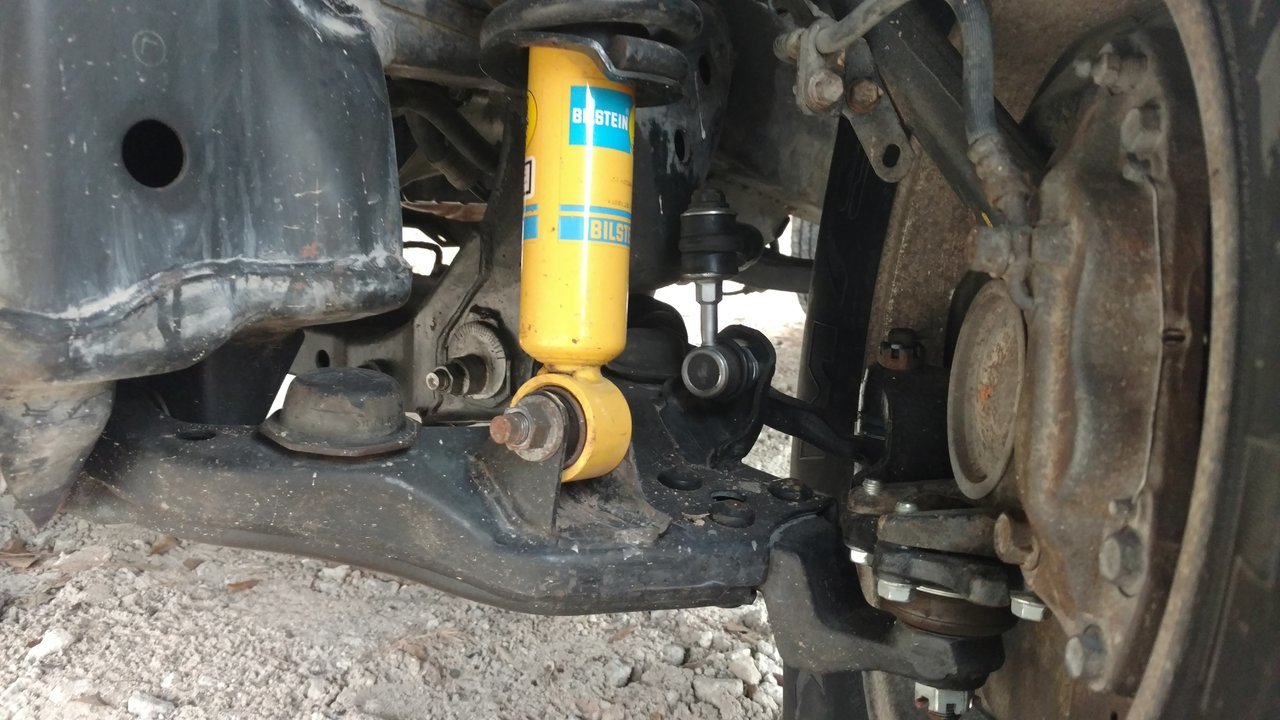

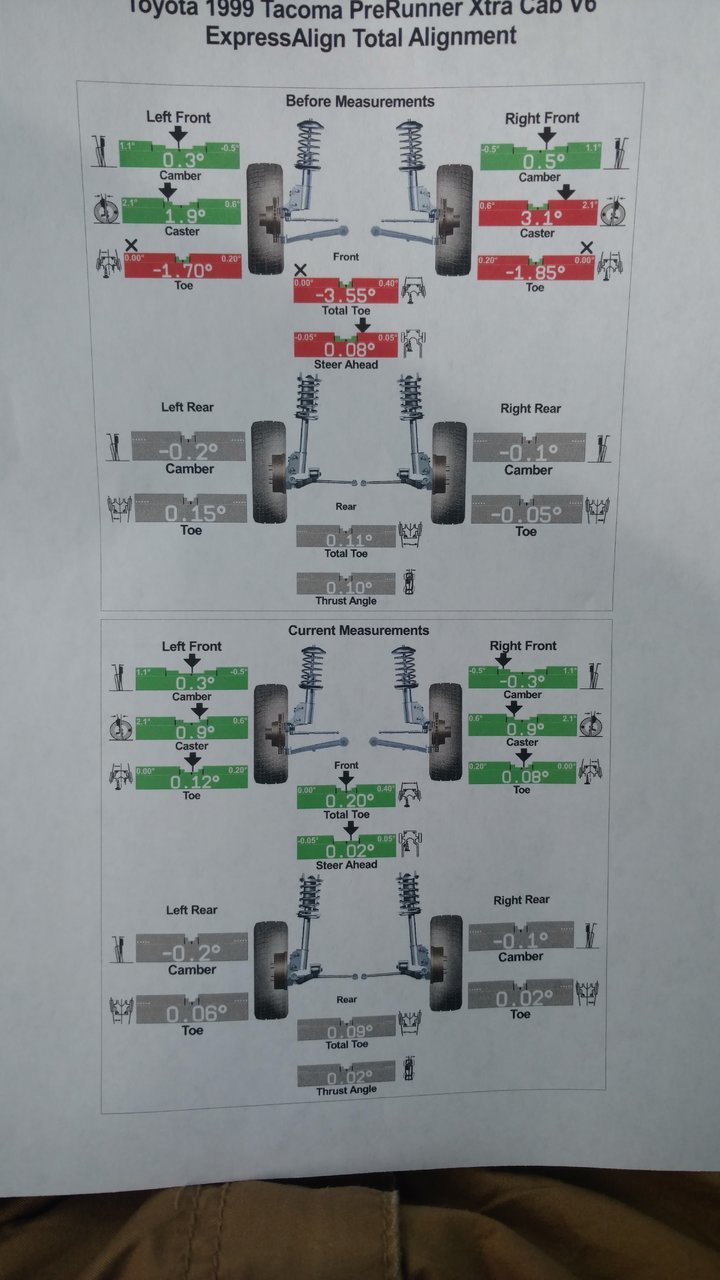

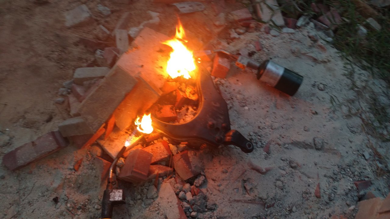

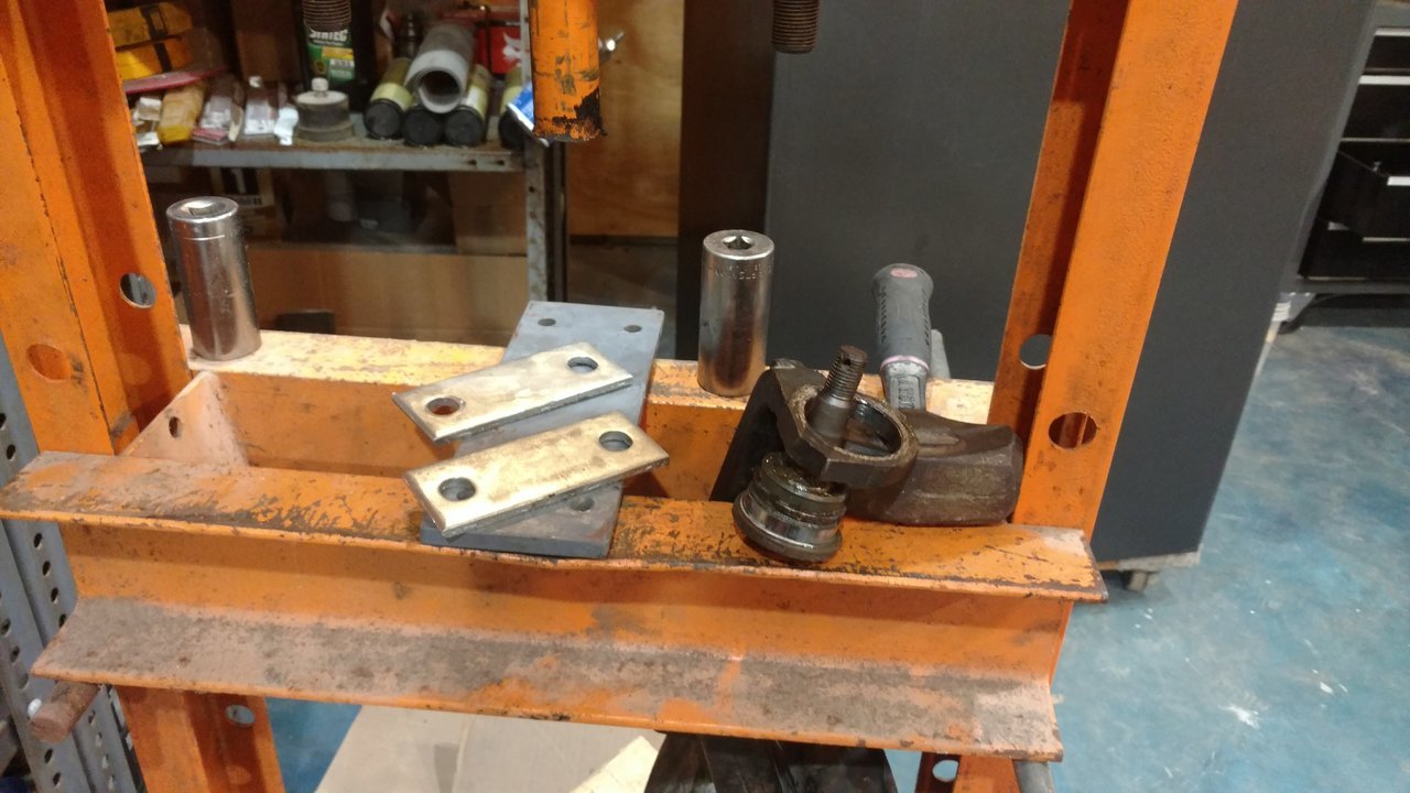

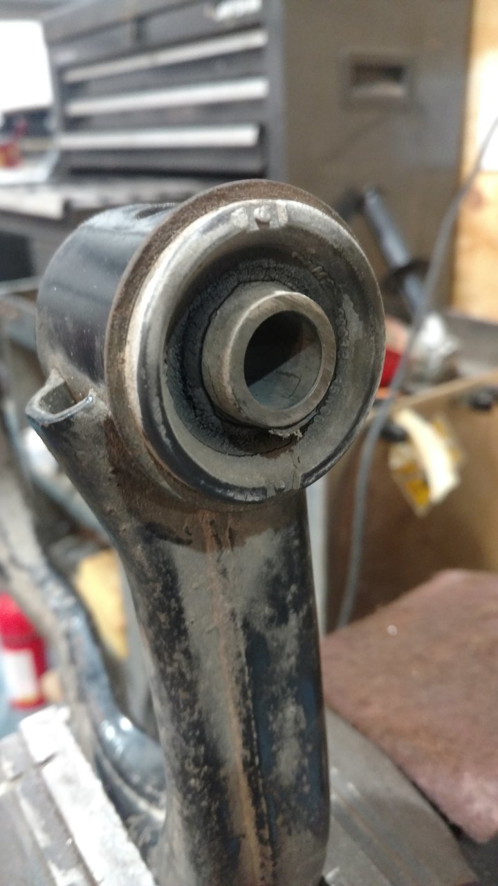

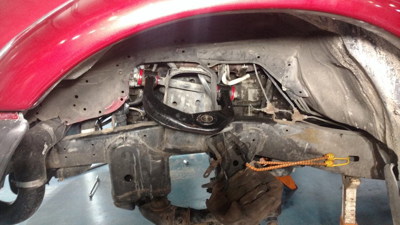

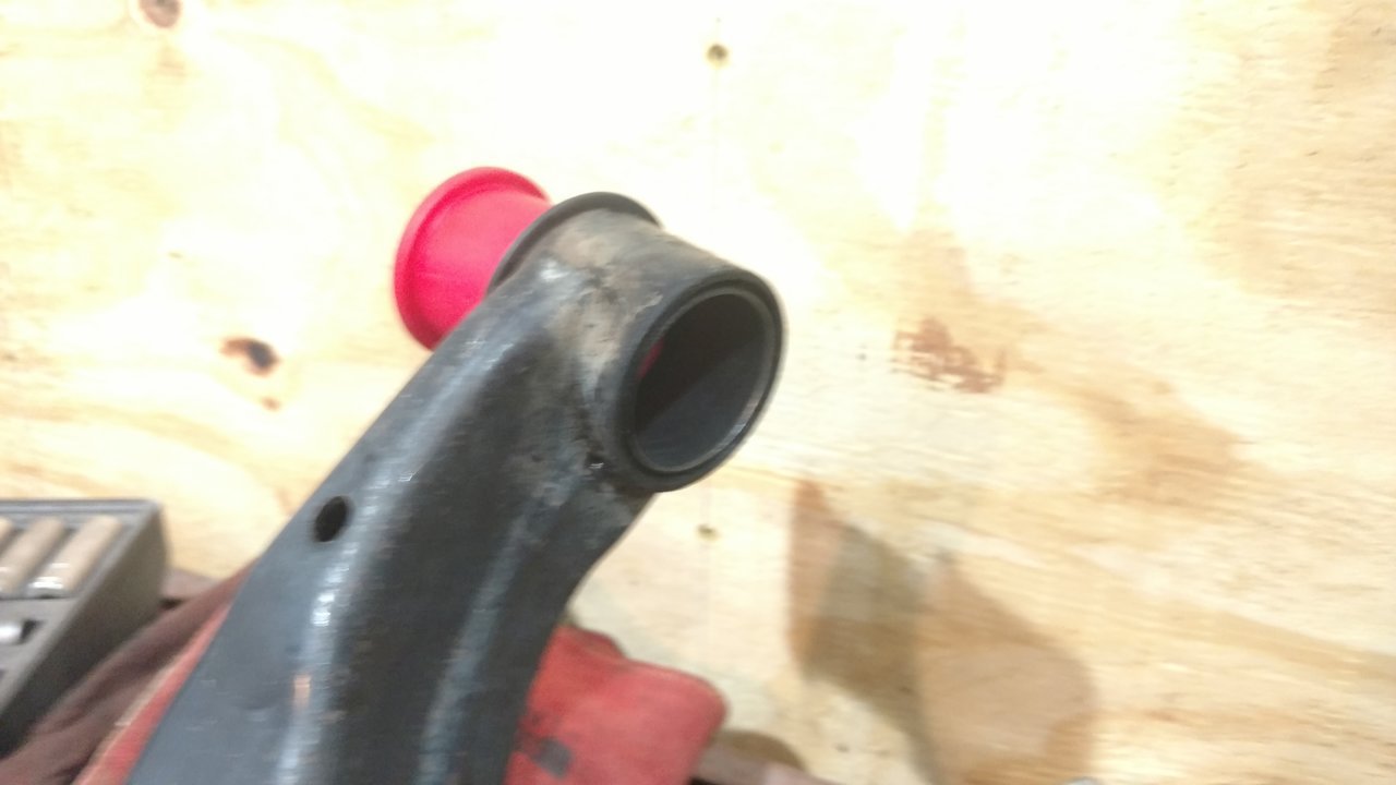

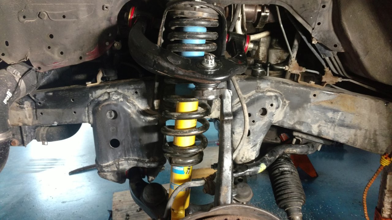

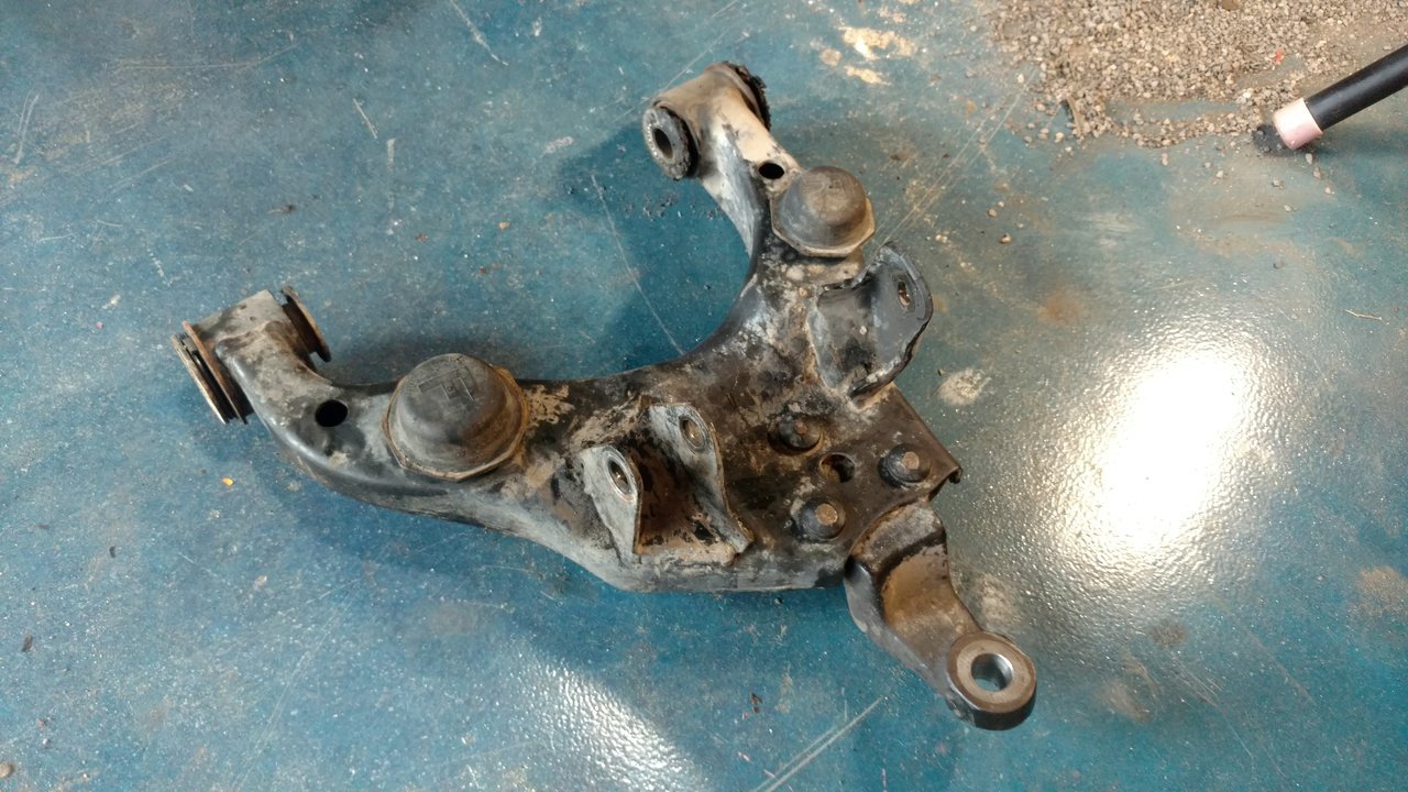

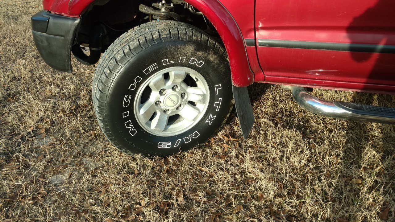

    Here is the recent suspension re-work that I did that I sorta regret doing...
    This truck will be for sale soon. I've reached the end of the amount of money I want to dump into it and I'm ready for something new.
    Below are some detailed pictures of the front end suspension rebuild that included: Bilstein 4600's, new top hats, new upper and lower control arm bushings, new sway bar end links and bushings, new power steering rack boots, new rack and pinion endlinks, new upper ball joints (OEM design with nylon seat), new OEM revised lower ball joints, new power steering rack bushings and new cab mounts all the way around and maybe some other stuff I may have left out.
    TLDR: The whole dang suspension has been rebuilt. Literally all of it. Everything was replaced with polyurethane if possible, and greased heavily.

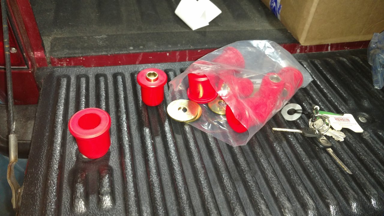

    Energy suspension UC and LC bushings

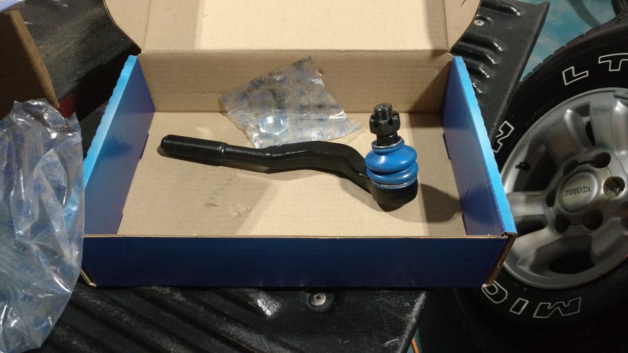

    Replacement tie-rods with poly boots

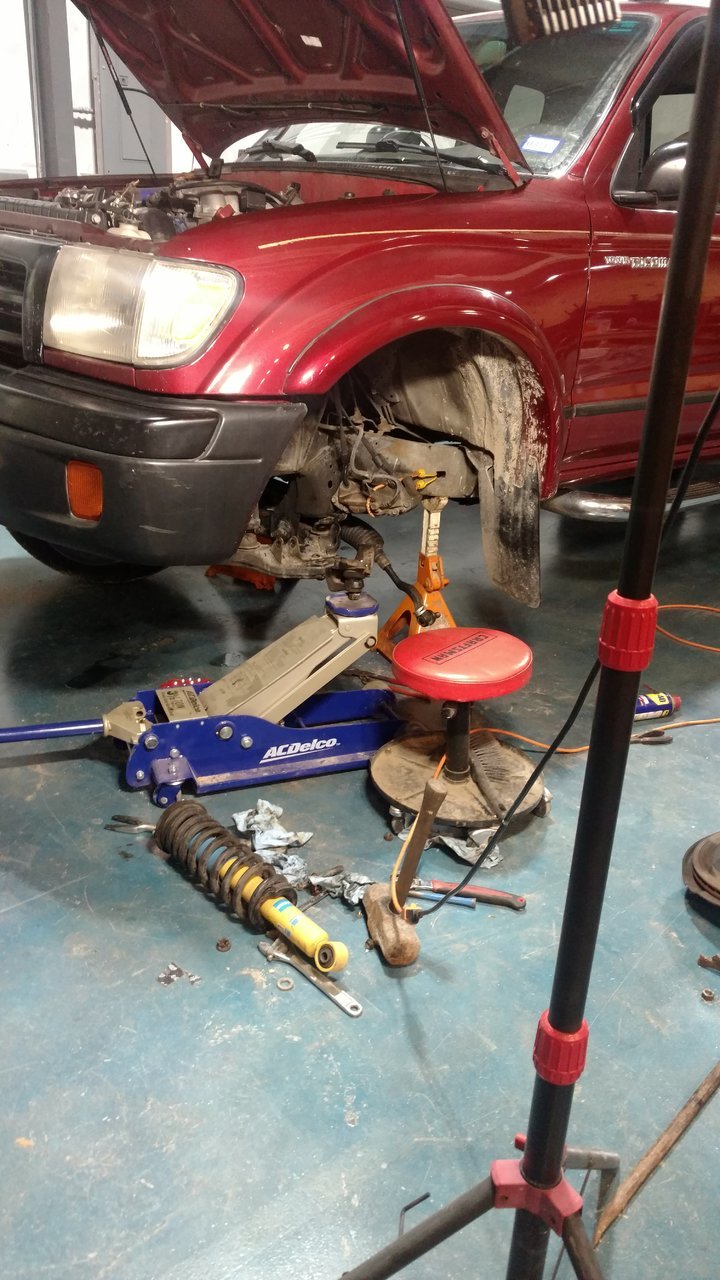

    Marks made so I could limp it to the alignment shop.
    Crusty old rubber bushing with noticeable play.
    Another view.
    A view of my work area for the next few days.

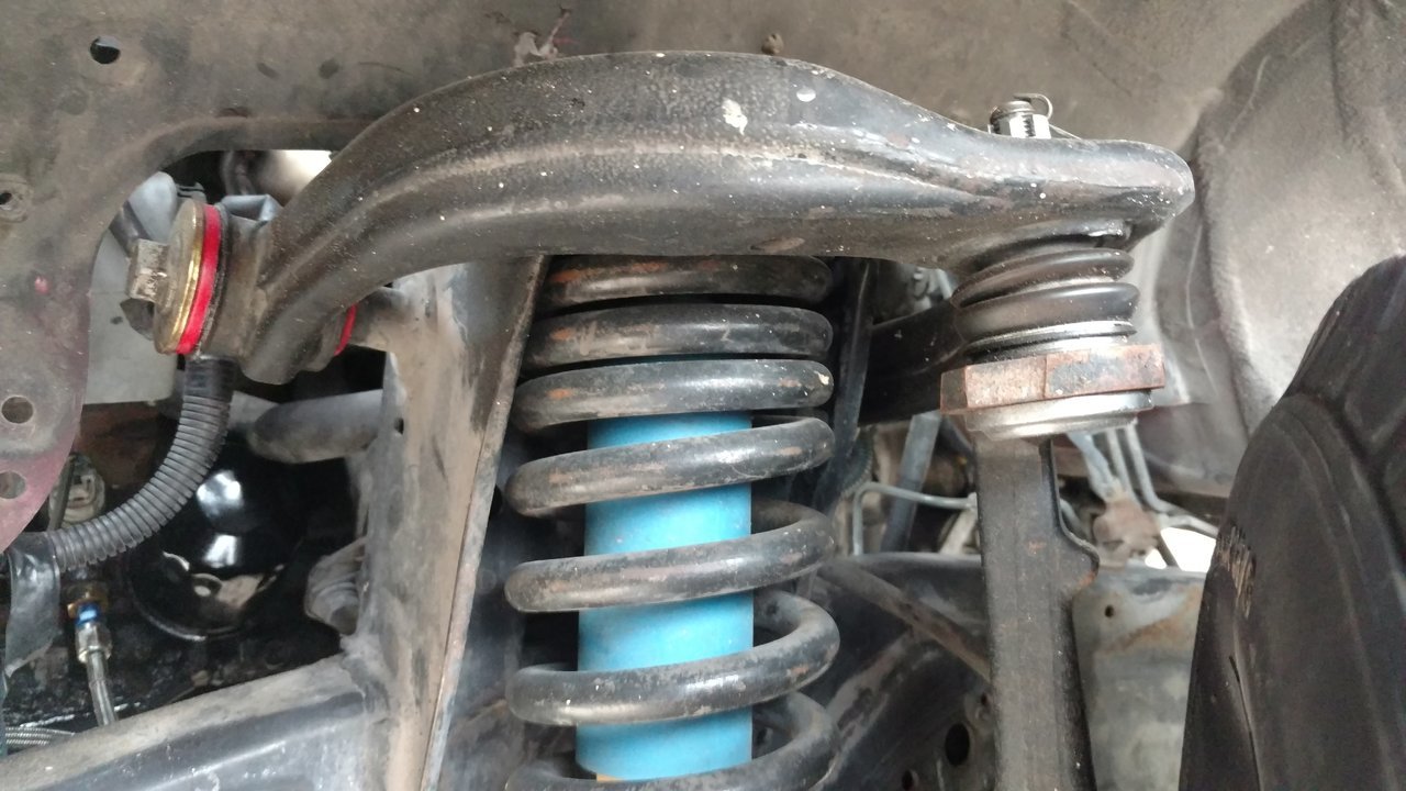

    UCA installed poly bushing greased to the brim with silicone
    Old LCA pre-rebuild

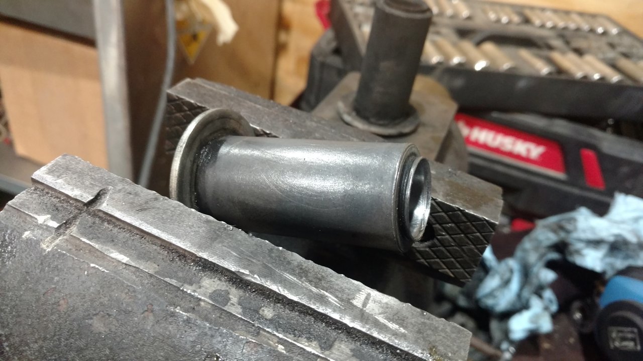

    Gotta get them LCA bushings out somehow...
    "Bust out the marshmallows!" -Torspd
    This inner bushing had to be disassembled and reused.
    Use muh hands to put er in thar

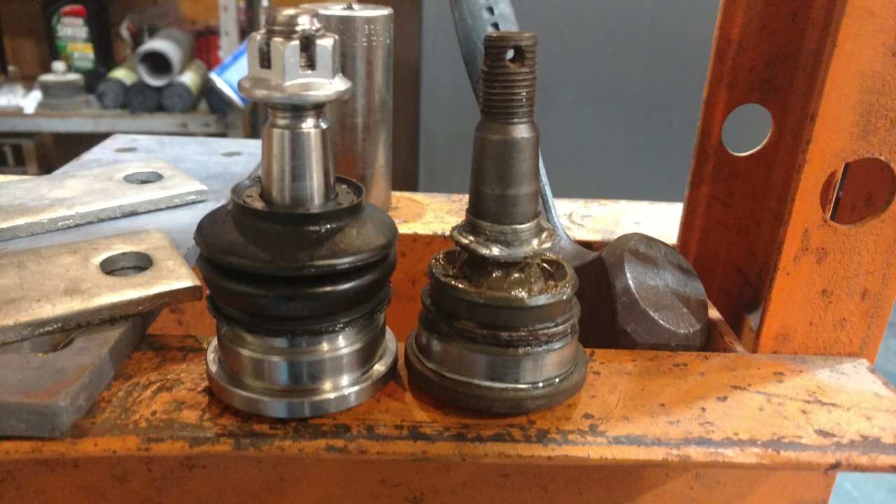

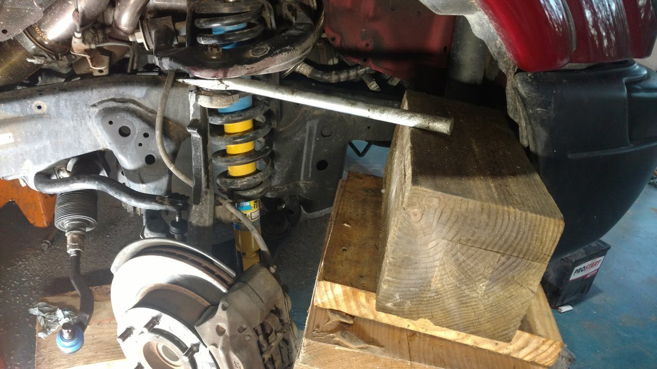

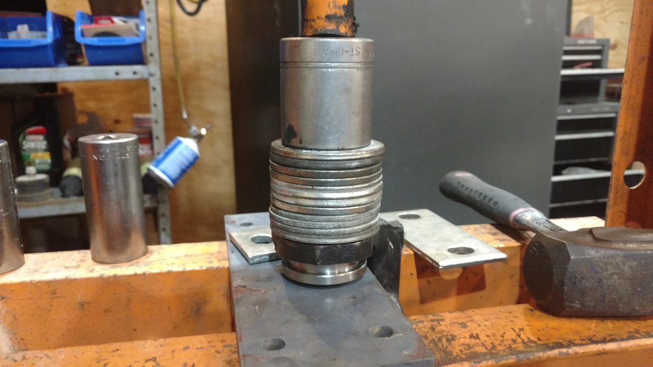

    The ever precarious setup I used to do the upper ball joints since I didn't have a BJ press thing
    Old vs. new
    Looks crazy but it worked great.
    This is a nearly finished drivers side.
    New sway bar end links with poly bushings.
    Very stubborn upper ball joint.
    Eventually it gave way.
    Here are some pictures in the daylight.
    If yah look closely it's all new!

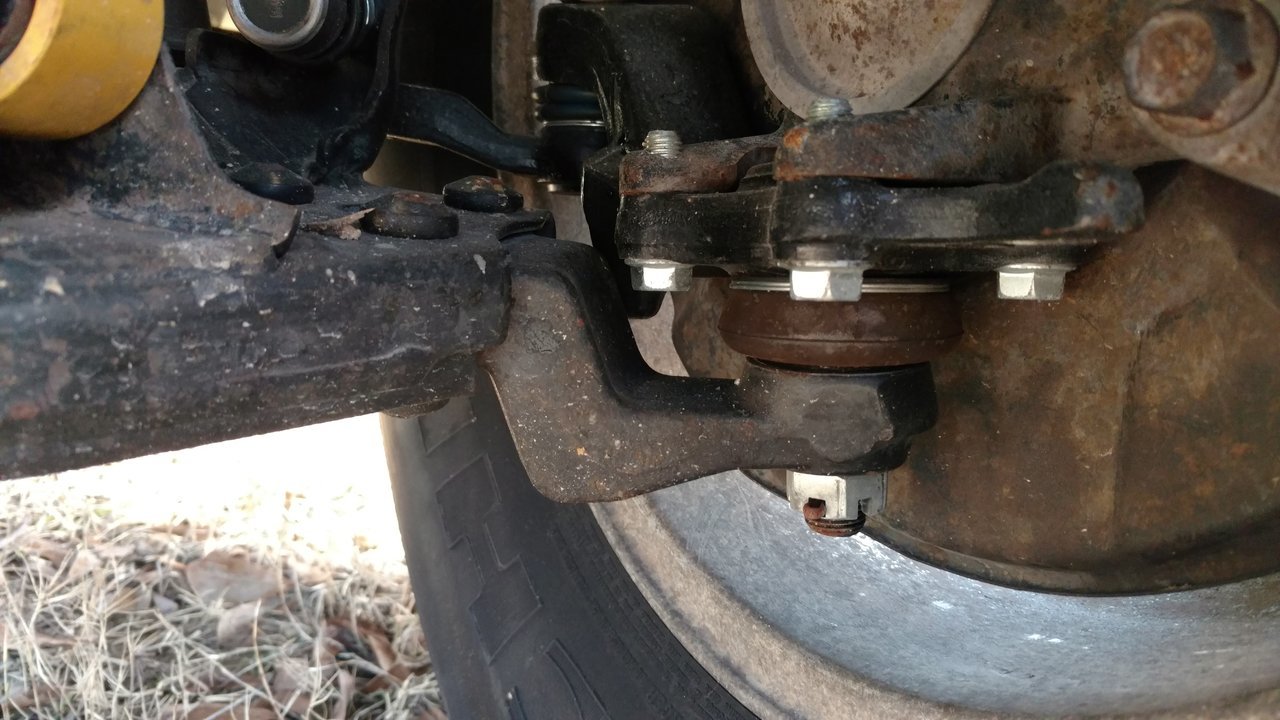

    Important to note that these are revised OEM lower ball joints.
    I also replaced the factory overload spring with a Icon three leaf AAL in an attempt to cure my wheel hop. It didn't work. Although it gave the truck a little bit of rake so that's neat I guess, better than the rear being 1" lower than the front.
    Here's some proof I got it aligned.
    The alignment dude said it aligned perfectly, and hey, I guess it did.
    I'll post some full pictures of the truck in daylight not disassembled in a separate thread. I guess I should also say this thing handles great. It ain't no marshmallow, but that's ok, because the truck lets you know you're alive.
    Torspd likes this.

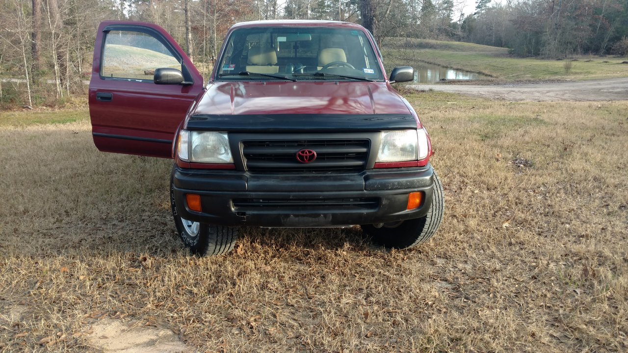

    This is the for sale thread but I will post it here too.
    For sale is my 1999 Tacoma Prerunner SR5 V6 with a turbo ~ ooohhhhhh.
    Miles: 183,xxx
    Transmission: A340E
    Drive: 2wd 4x2
    Year:1999
    Title: Clean
    Fast: Yes, it'll whoop your average 2000's V6 Mustang driver or the guy at work that thinks his Civic Si is fast.
    No offense to Civic Si drivers. The Si is cool.
    For an in depth look at what has happened to the truck in the last 3 years, you can pick through my build thread, but for now I will list what my memory permits here.
    This is my first truck, I got it when I was 15 from a lady that used it to haul mountain bikes around. Prior to her I think a cowboy owned it, I say because it came preinstalled with a cowboy hat holder lol. Upon getting the truck home it needed a new power window master switch and for some reason the power steering didn't work. I remedied the first two problem and for the next year and a half it became my daily driver and favorite vehicle. At one point I did the deckplate mod and welded in a flowmaster delta 50 series muffler for a little butt dyno increase in power. It remained largely stock until I decided I wanted to turbo charge it and that's where it all went downhill.
    So without further adieu, here is a mostly comprehensive list of things I have done to the truck. Don't expect to see miles driven on this stuff. I never made a habit of listing when I did what unfortunately, although I can give estimates. Please ask any questions you have.

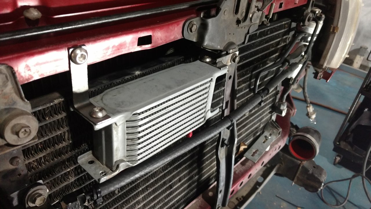

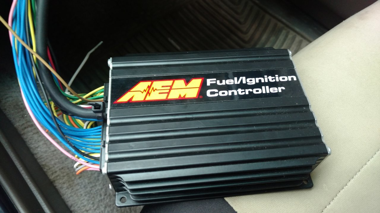

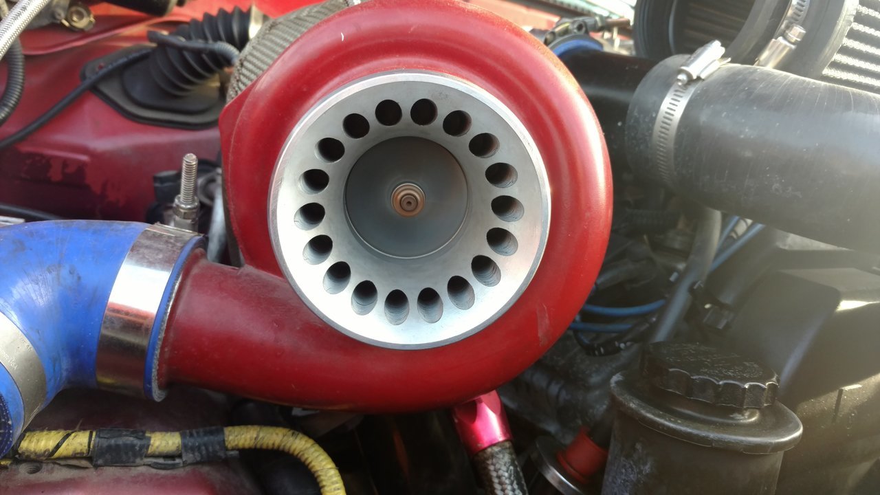

    Performance:
    • AEM F/I C 6
    • URD ECU harness
    • Manual boost controller

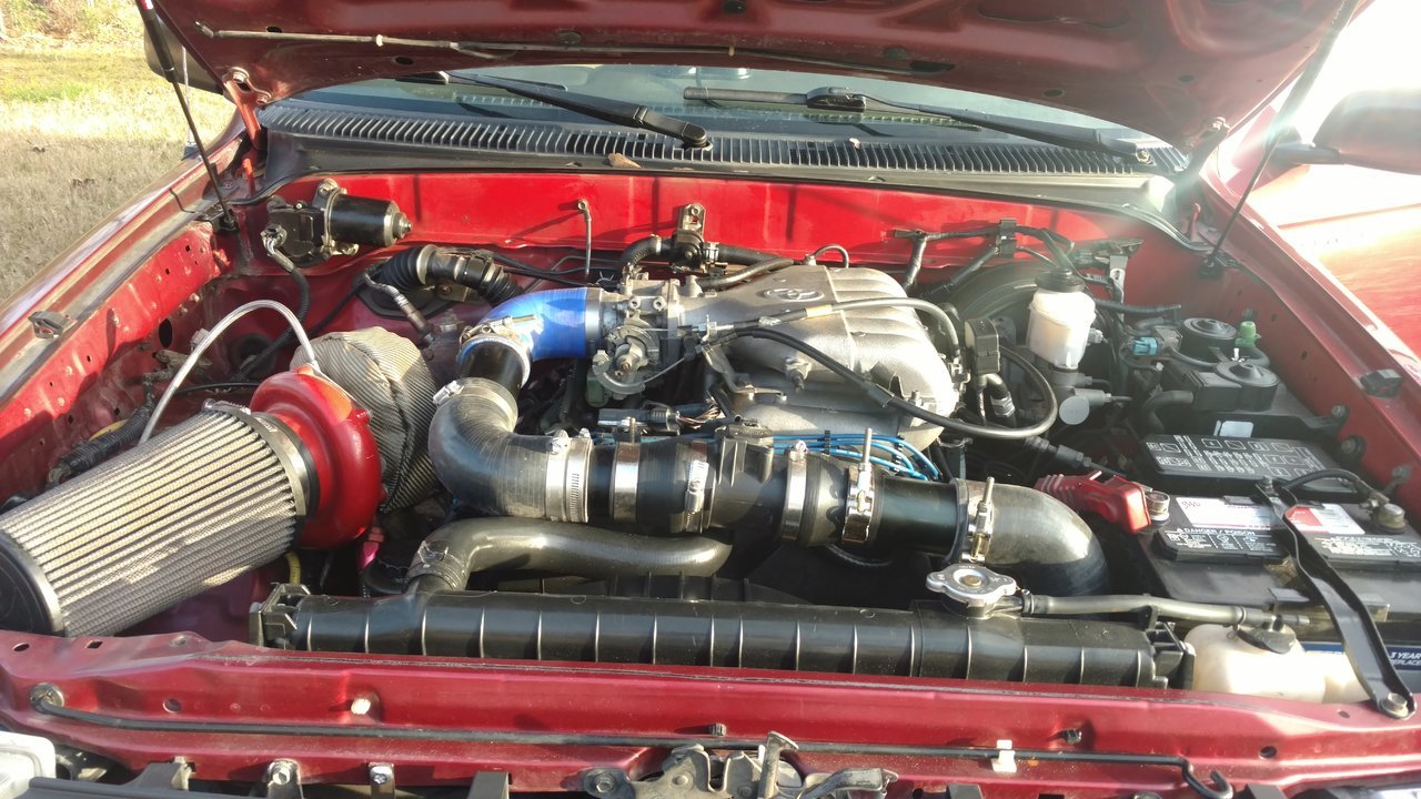

    • CXracing ceramic ball bearing turbo 51/73mm cold and 62.3/68mm hot with a 0.70AR cold side and a 0.63AR hot side. Data logs show boost starting at around 2300 rpm or so.
    • 3" exhaust with a Pro series flowmaster dumping pre-axle
    • High flow flowmaster cat. (doesn't do much but its physically there in case some pokey emssions guy gets under it)
    • DIY rear o2 sensor - possibly one of the best mods on here

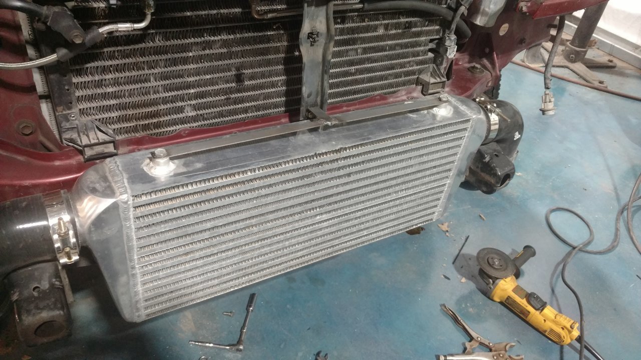

    • 2.5" IC piping stepped up the 2.75" for the intake throttle body.
    • Chevy SU1075 knock sensor swap
    • Decently large intercooler mounted behind the bumper
    • Post MAF setup
    • 10 psi of boost
    • 550cc injectors from Oside Tiger
    • AEM 320lph fuel pump

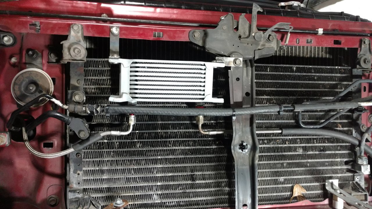

    • 6an oil cooler pre turbo
    • 4an oil feed to the turbo with a 0.70 restrictor
    • new front bosch o2 sensor

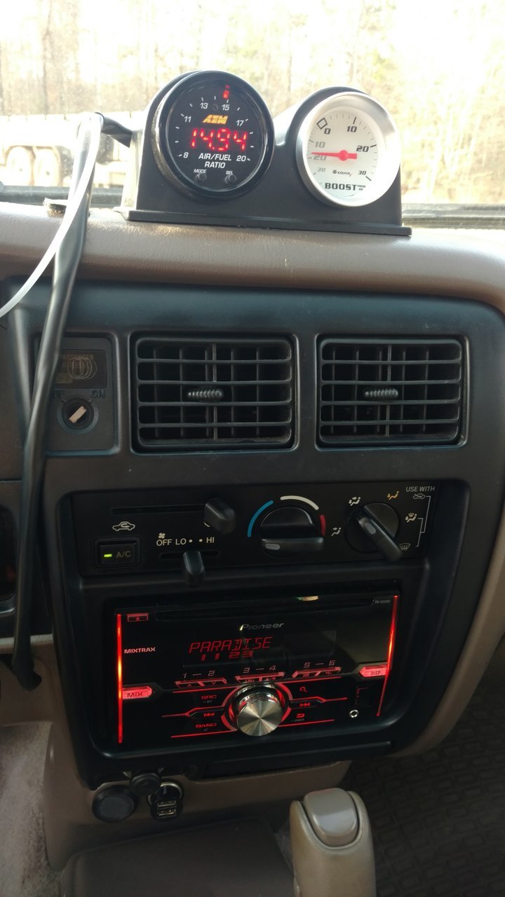

    • AEM X-series wideband
    • Boost/vacuum gauge
    • Currently running my own tune without issue (Been running this tune for about 3000 miles)
    • Transgo shift kit that I drilled out for hot rod shifts
    • AFE air filter
    That concludes what I have done performance wise. The turbo kit itself has around 10k-12k miles on it.

    • Sorta ghetto gauge pod location

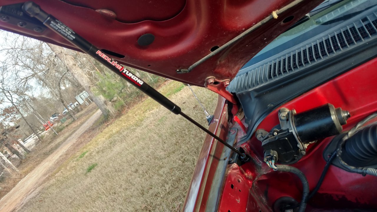

    • Redline hood struts (Second best mod?)

    How was it removing those UCA bushings? Easier than the Lowers?
  19. Feb 7, 2018 at 7:25 AM
    #1799
    Brice
    Brice [OP] Turbo Member
    May 28, 2015
    #156265
    2,304
    Brice
    Texas
    1999 Tacoma PreRunner V6 SR5
    Wastegate assisted turbo delete
    Not really, they both have to be burned out. It's honestly easiest to let a torch sit and burn them out, eventually they self eject and the inner metal bushing will slide out on its own. You could make an attempt to drill or press them out but they are very soft and in my case gave too much to be pressed out.
