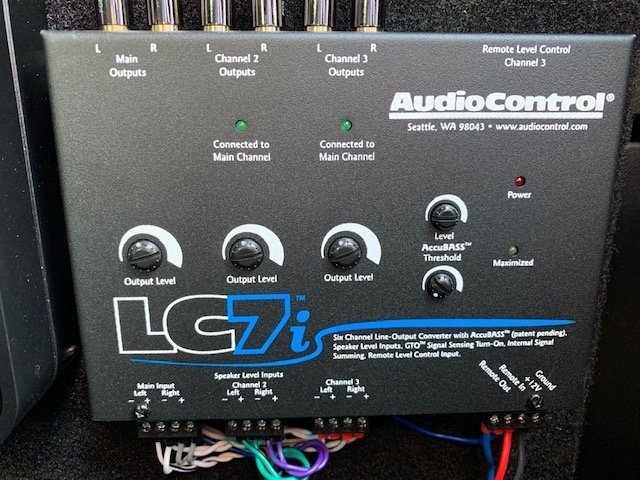

    Then work on the gains on that LOC. They seem a little high. Looks like they are set at 3/4, setting them at 1/2 or just below may help.
