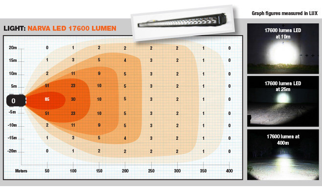

    I REALLY want to love LEDs as they are the newest technology. Simple design, reliable, and last tens of thousands of hours. Whats not the love right??
    Well the optics are improving every year so I think LEDs are certainly the future, but for right NOW they still suck for what lighting is supposed to do... light up whats down the road ahead of you.
    The problem isn't lumen output as you can get a 100,000 lumen LED setup if you really wanted to... the problem is DISTANCE and more specifically the LUX rating at distances of 200m+. This is where even super nice LED setups crap out unless you get a really good mixture of dedicated spots and separate flood lights. But since we're talking HEADLIGHTS the difference in distance in LED vs HID is very apparent. Even my stock halogen high beams throw light farther than even expensive LED pods, when I switched my high beams to LED it cut my light distance by almost half, they SUCKED at distances over 100m, so I switched back to 55w halogen Osram Nightbreakers instead (didn't want the delay of HIDs in my high beams).
    Take a look at these lux ratings of LED vs HID both made by the same company (Australian brand Narva)
    This is there 17,600 lumen combo lightbar, that's a shitload of lumens and even then at 200m the lux rating is only 5... at 300m it drops to TWO.

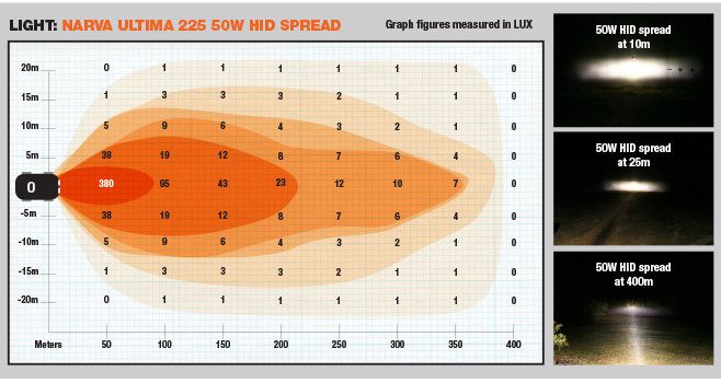

    Compare to their HID setup:
    At 200M the lux rating is 23!! over four times higher than the LED.
    At 300m its still rated at 10.... FIVE times higher than the LED.
    In conclusion LED is great for lighting up whats right in front of you, for rock crawlers or slow offroading this is great. But for us desert guys that like blasting through trails at 50mph at night we NEED distance and LEDs just don't cut it.

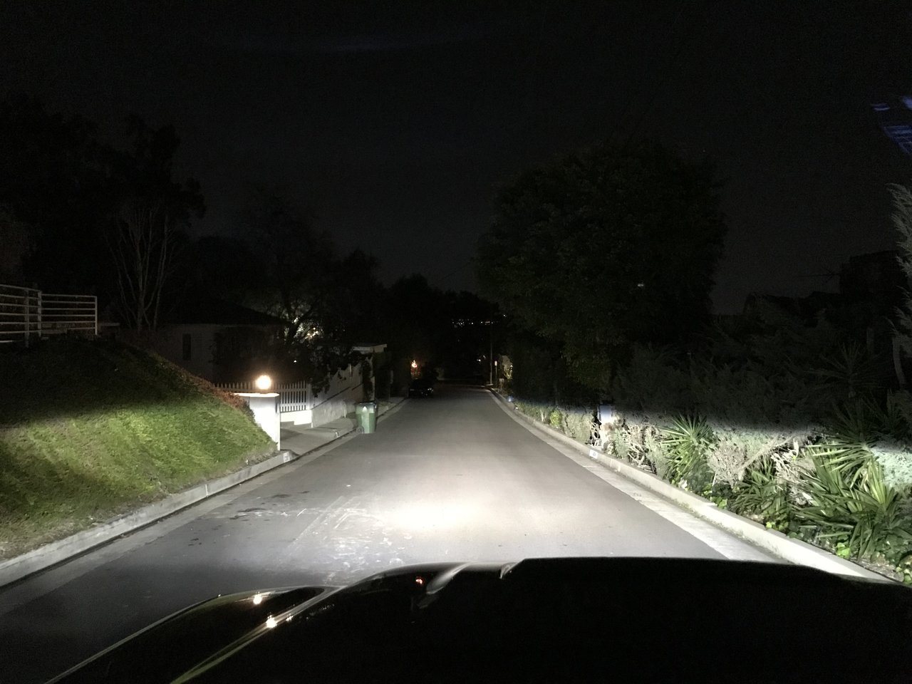

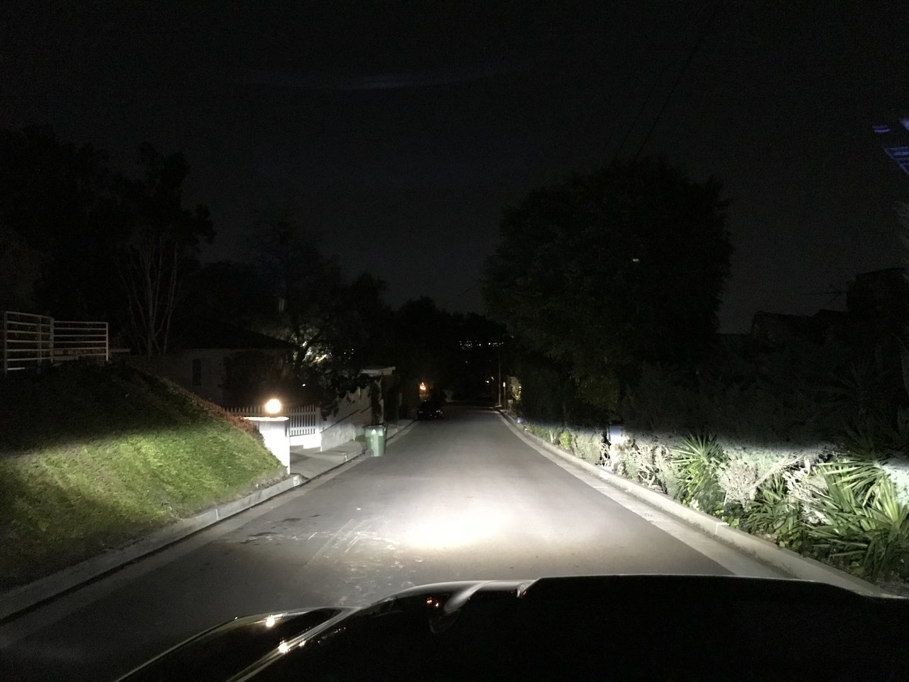

    Xenon Depot 5000k
    HID only-
    HID + XB Fogs-

    This thread is full of so much garbage mis-information it hurts.
    You should not run LEDs in a halogen reflector. Much less a fog halogen reflector, about the worst setup possible. And those photos just illustrate the glare caused by improper lighting upgrades.
