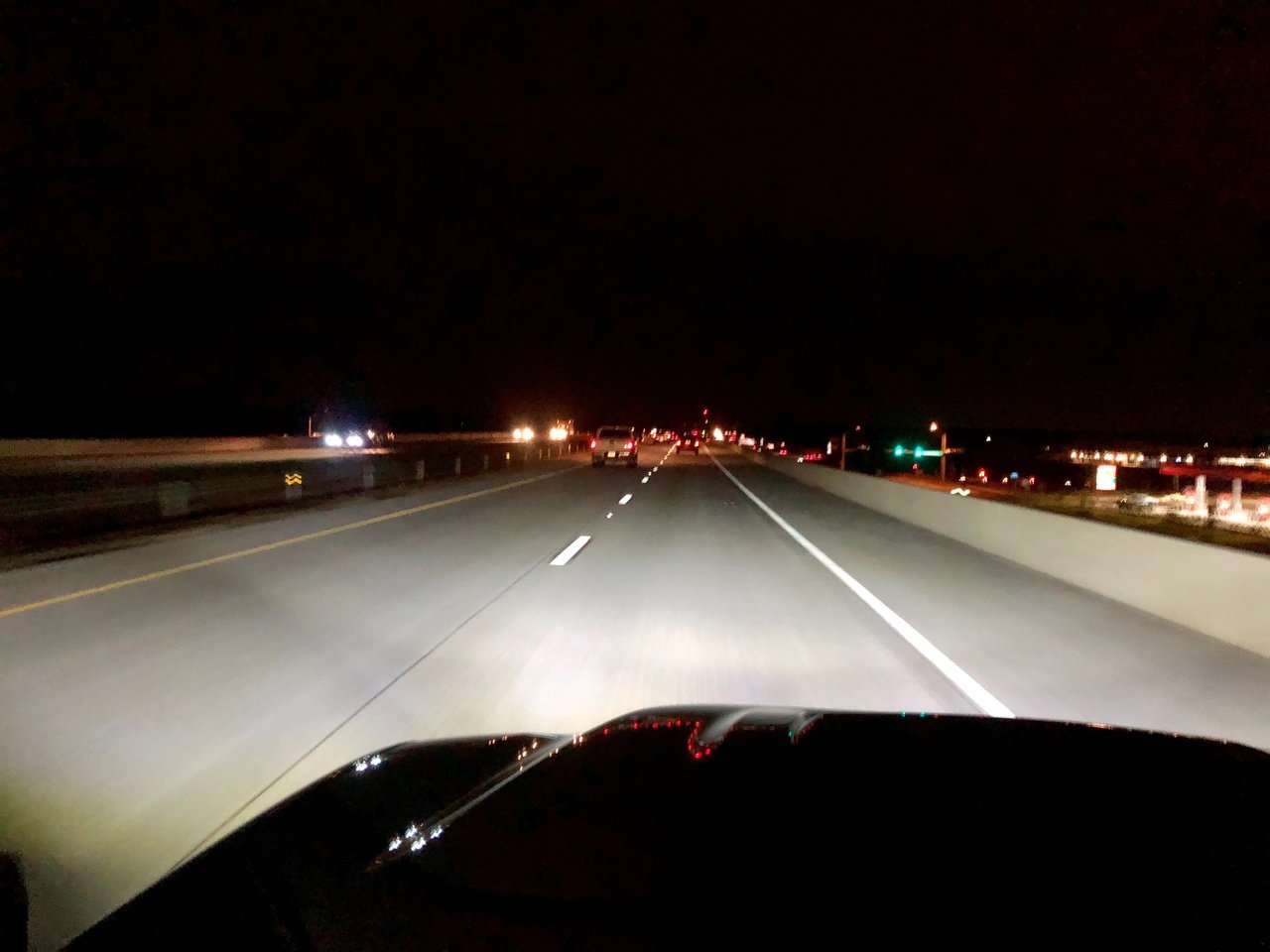

    Nightscape
    Nightscape Well-Known Member
    Jan 13, 2017
    #207521
    289
    SoCal
    2017 TRD Sport DCLB
    HID+Morimoto XB
    SilverII likes this.
  12. Jan 12, 2018 at 2:24 PM
    Parker315
    Parker315 Modding on a Budget | TTC Member #0127
    Dec 27, 2017
    #239512
    1,392
    Brett
    Cypress Texas
    17 Tacoma TRD Sport DCSB MGM
    TTC (Texas Toyota Coalition) Member #127
    Morimoto XB is a LED fog light right? Do you have a picture with the Morimoto XB off and just the HID to get a good comparison?

  15. Jan 12, 2018 at 2:31 PM
    Nightscape
    Jan 13, 2017
    #207521
    289
    SoCal
    2017 TRD Sport DCLB
    Yes the XBs are led projector fogs.
    I don’t have a comparison pic right now but I can do one later when it gets dark.
